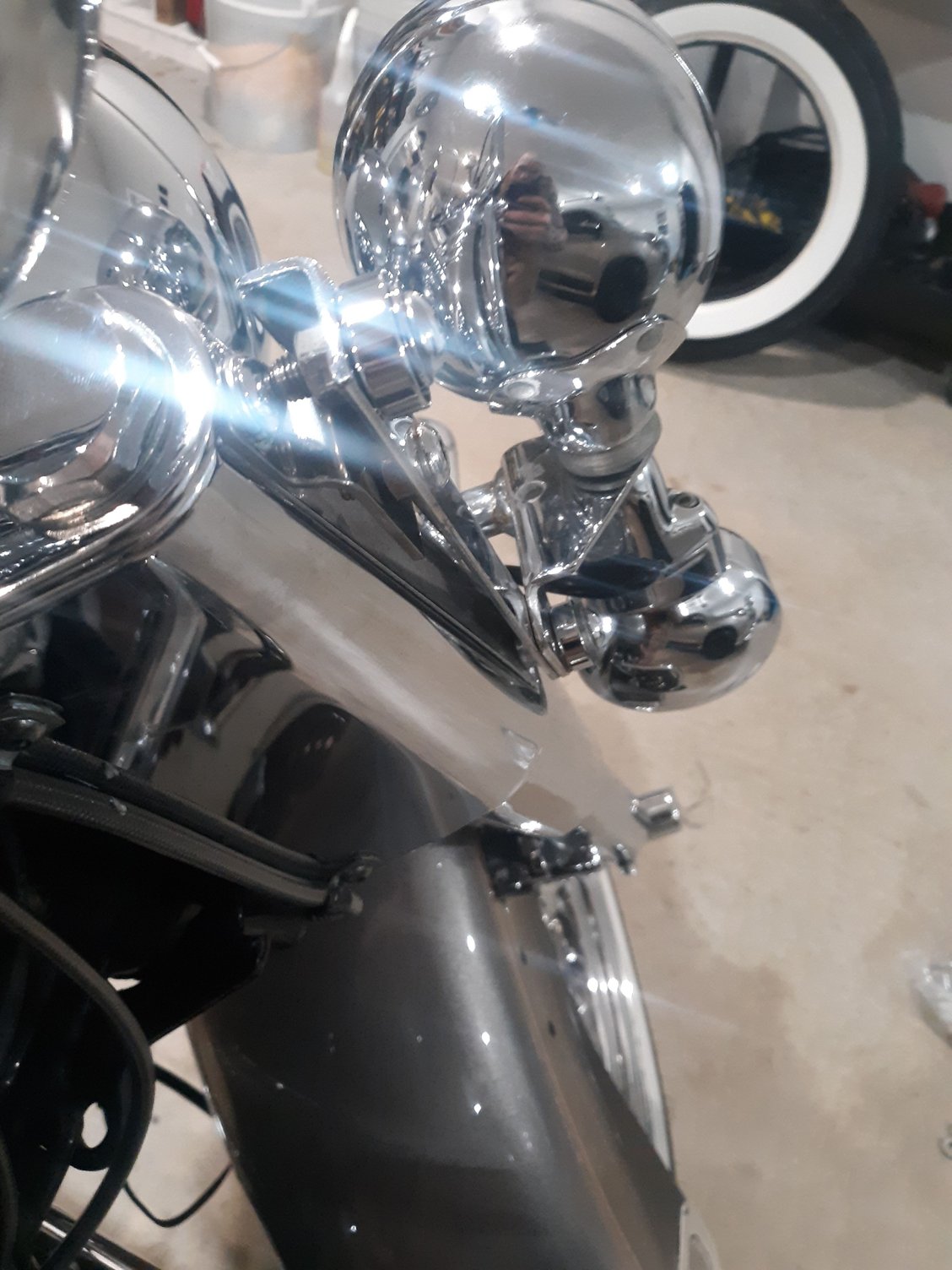

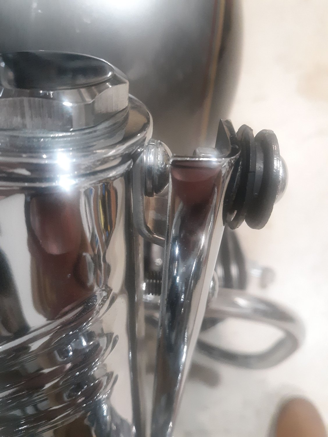

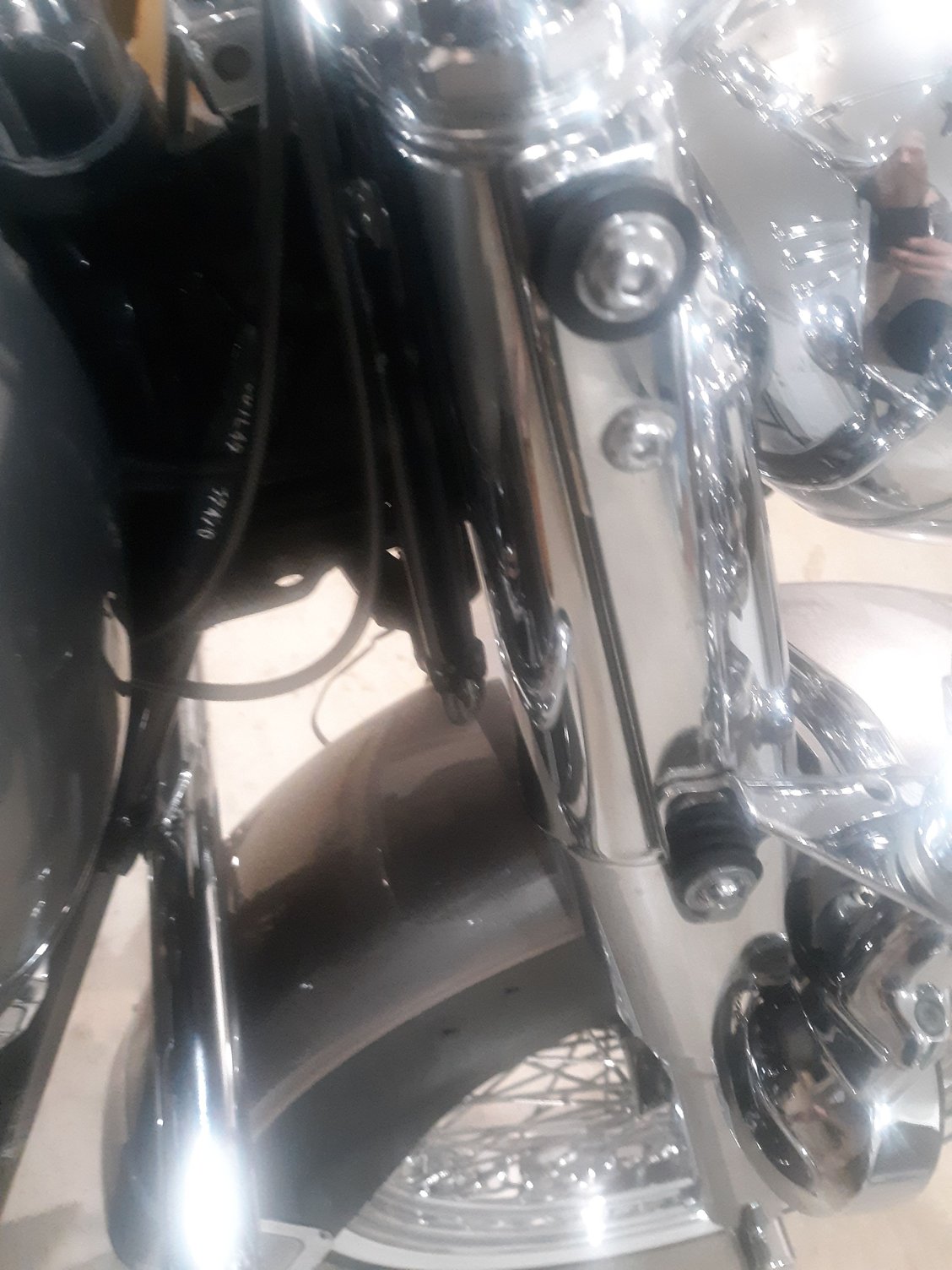

Trying to think of a way to get rid of these black rubber pieces around the spot lamp mounting bar on my 97 Heritage. It almost looks like I could just get shorter chrome bolts and do away with them? Not a big deal, just thought I could clean up the look a bit.
They've been on the bike since I've had it, but not sure of the purpose.

They're for mounting the detachable windshield. Windshield docking point bushings.

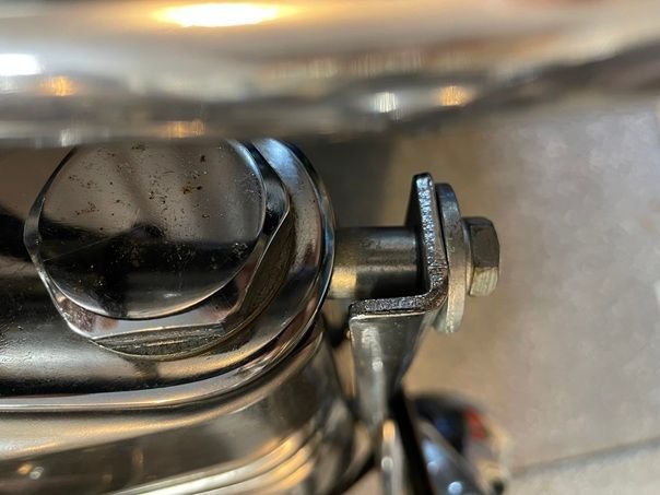

The original configuration uses a bolt that goes through the lamp bracket, a spacer, then into the upper triple clamp.
Here is my `89 FLSTC, all OEM components (your `97 uses all the same parts according to the HD microfiche).
