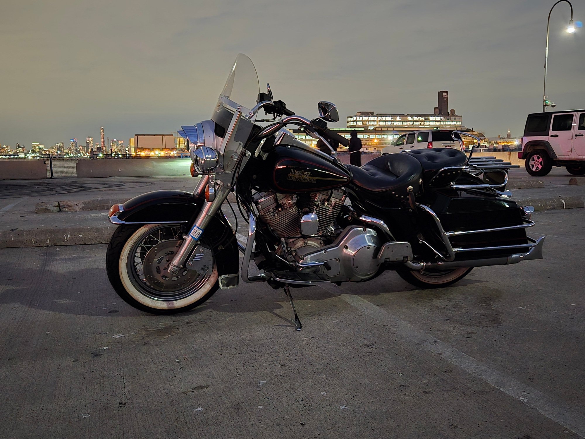

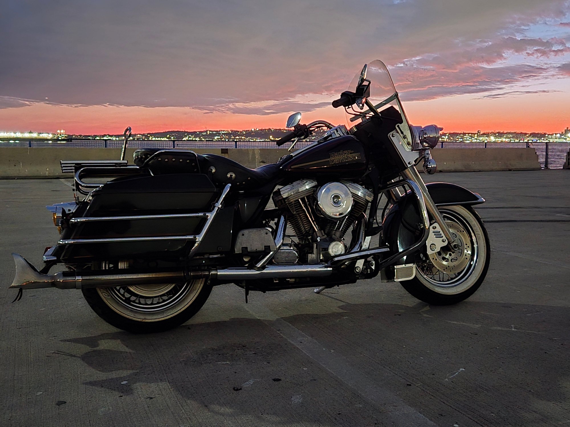

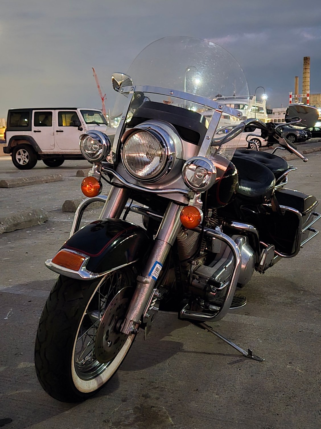

Default 1989 FLHS, Stuff to Do Etc ...
These cell pics aren't good enough to load this big.
I think I am done ordering stuff for a while. Taking the inner primary off to do the trans shift lever, and hope the splines are ok. "While I'm in there"... 57,000 miles. Alternator, clutch discs, cable, spring (heavy pull). Not used to the newer trans style. I ordered a more stock sized windshield from Jurock, I'm curious to see how it looks.
I got the EV13 cam, looking to keep my stock pushrods if they are good. Got the bearing. Such a pain to decide on lifters. I found 2 sets of Johnson Hylift slow leakdown types on ebay. I took a chance on a set. There is also a set of xxxx-86B NOS HD OEM in the box but the plunger was held in by a wire retainer and not a circlip ,I read the circlips are the B type.
It's getting nicer out so hopefully I will get going on this soon. Fingers crossed.

Oh, OK. My mistake
Good luck with your project. Great looking bike.
