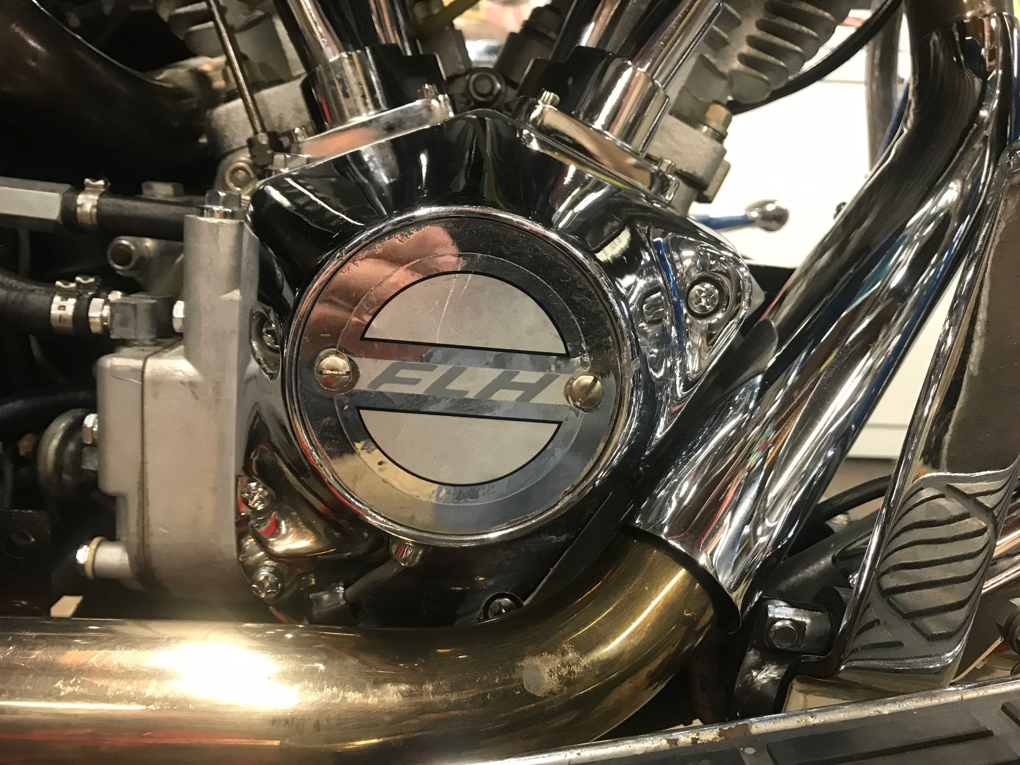

timing cover

I think it's to keep the Russians from stealing our technology . . . ?

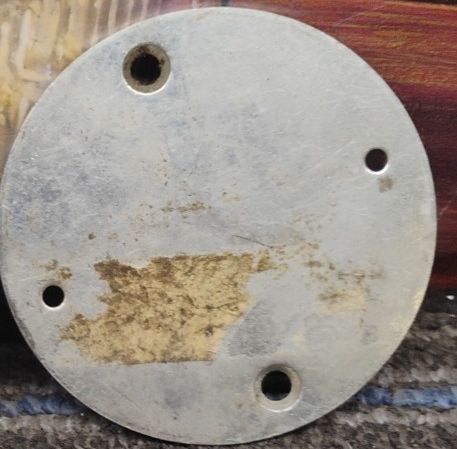

All nose cone Shovels and Evos came from factory with that "inner cover plate" though I suspect most were removed before the first oil change
Note the counter sink holes for the flat head or pan head screws going into the timer plate screws/standoffs.

All With Electronic Ignition I believe ie, 1979 +
But Previous...IDK when, but the 1974 Did Not..

The book shows them on all but the part number is *-80A so maybe it's one of those things that can be retrofitted. I have no first hand with Shovels.

Early cone Shovels had screws, Evo's have rivets, I do not know when they changed. Likely had something to do with eliminating points and going to electronic ignition. The dealership actual has them if you want to put your back in the way the factory did it.
Riveted covers happened when the factory electronic ignitions did. No reason for owners to be in there and cost trimming on the production line

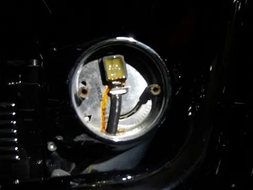

Until this happens.

I think you both are correct. Didn't start till '80 but could/would fit all Evo nose cones.
