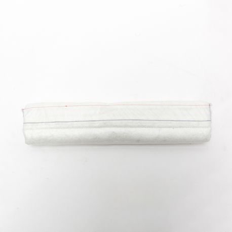

That said, here we go...I have MK45 mufflers and have moved them over to my new bike. They have about 125,000+ miles on them now and they have gotten louder over time. They advertise that they have "Lifetime" muffler packing but I figured after 125,000+ miles and them getting louder that the lifetime was worn out in them. I purchased directly from S&S the 4.5" insulation that they say is the replacement, I even called them to confirm. https://www.sscycle.com/products/ins...n-muffler-4-5/
When they package arrived I saw that is looks nothing like the muffler packing inside of the mufflers. Since I had already removed the stock packing I had no choice but to install the new insulation. The mufflers are much louder, even with the full length Db reducers, than they were with the high mileage packing. I have attempted several times to contact their customer service by sending emails, called them and gotten no reply from them. I'm not expecting new mufflers and all I have requested from them is to discuss some way to remedy the excessive noise issue.

Yes, the replacement packing isn't anywhere near as robust as the stock packing. It also fits very loosely around the baffle and there is no way it can absorb as much of the 'flow' to deaden the sound.

Yes, they are the packing rolled into a cylindrical shape and sealed. The baffle core slides into the middle of it and it fits loosely around the baffle. When you shove it all back into the can it goes in easily but doesn't get pressed against the core. I was going to wrap it tight to the core with safety wife but the material is so thin I didn't want the wire to cut into it and damage it.
I've had the cylindrical packing for my dirt bikes but it is a much heavier outer material and the media is much more dense as well. My dirt bikes get hot but I don't know if that packing would hold up to the HD heat.
