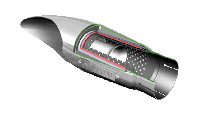

This exhaust has intrigued me since I first saw it online. Observations:
- VERY short both on individual pipe lengths and overall system. Long enough to use pressure waves well?
- Awfully short baffle given the view from the exit hole, and the short available total straight section of pipe. That suggests it is going to be either pretty loud or pretty restrictive
- Your leg might get pretty hot
- The presence of BOTH hot header pipes RIGHT under the air cleaner might result in very hot intake air when sitting at a traffic light, or in stop and go traffic
- KILLER good looking!!!
Jim G
Ditto.....short, short and ....short w/hot.

harley primaries need around mid 20's in length or more to take advantage of slow firing events, this one looks shorter than that. Collector here is super small, muffler/baffle tiny too. I have never seen this style tuned but it seems like a looks preference thing over performance. Most good 2 into 1's end at the axle or longer for good reason. Nothing about this pipe even the looks is good to me. OP if going cams too should look elsewhere on exhaust. the short swoopy pipes is fad bike builder stuff that Paul jr. would probably like...that means in a year you'll hate it, or should.
This is my main concern
They say it's a silencer rather than a baffle, looking at the picture it does look more restrictive?
Akrapovic do have a reputation for good power from their exhausts I just hope that carries over to their harley range. Here's a you tube I found for the sound, not as loud as I'd like, sounds better at full volume, but not sure volume controls are included.
No problem there, it's cold in England
From what I can tell the headers should be far enough away and when I'm riding the airblast should help. I don't stop for much, usually just the pub!
Jim G
I like it.
