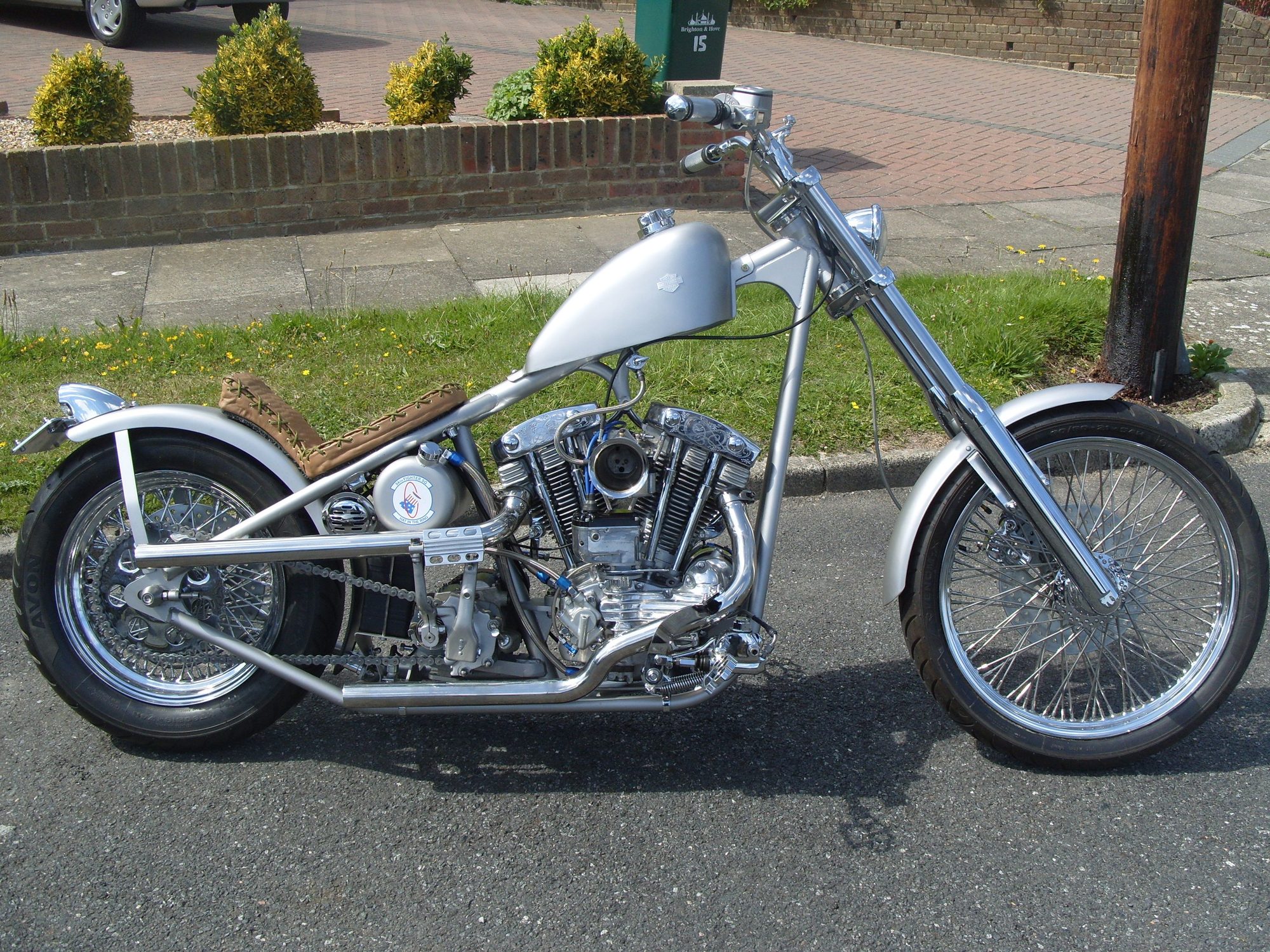

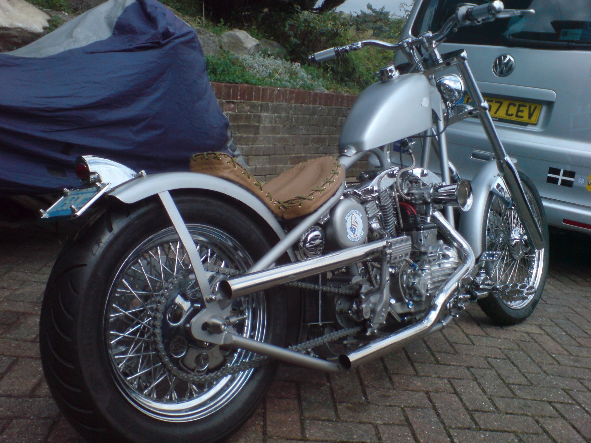

there are a couple of firms making a hard tail frame for a 45 that use a 4 speed big twin transmission, but if you want a swingarm frame I'd start with a shovel frame and alter it,
the motor mounts at the bottom have i believe the same front to rear distance ,
the front lower motor mount also is lower than a big twin frame so you need I THINK a 1 inch thick block spacer on the front to raise the mount point. but the bolt pattern is also differant,
the other way is to build or have built a one off bespoke frame for the parts you need,
I have built many 45 based customs & found fitting a Commando clutch & geatbox is a good way to go or a Triumph boxalso works,
you dont need a trans as big or strong as a big twin trans on a 45,..
​​plus to aline with the transmission the motor has to be mounted way far to the left of the frame for all the primary & final drive to fit, this tends to unballance the bike as most the motors off set to the left,

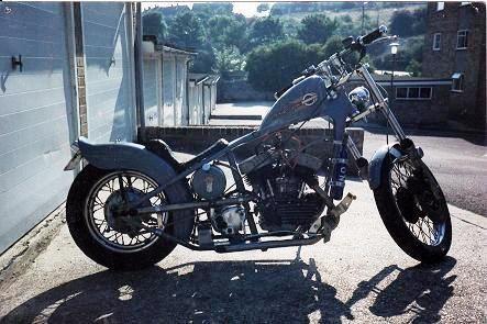

this is a pic of one i built 30 years ago not a great pic but you can see the commando box,.
also a 45 Magnium is a 45 bottom end fitted with a 900 sportster top end, this is one I built a few years ago,

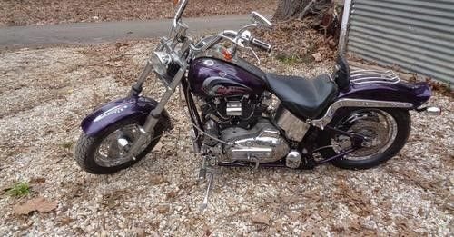

Thanks for your trouble Architect. I have a 1977 Ironhead in a softail frame that I bought in 2017 and has sat in a warehouse in Detroit ever since, I'am a Canadian guy who has not been able to get over there to bring it across yet, it's a long story why. I do a lot of looking on the internet for bike stuff and I have never seen this done before, but I'am sure it has been. I was told by the people I bought it from that the frame was a pauncho. I don't have a real good photograph of it but if I can send it along to you I will.
