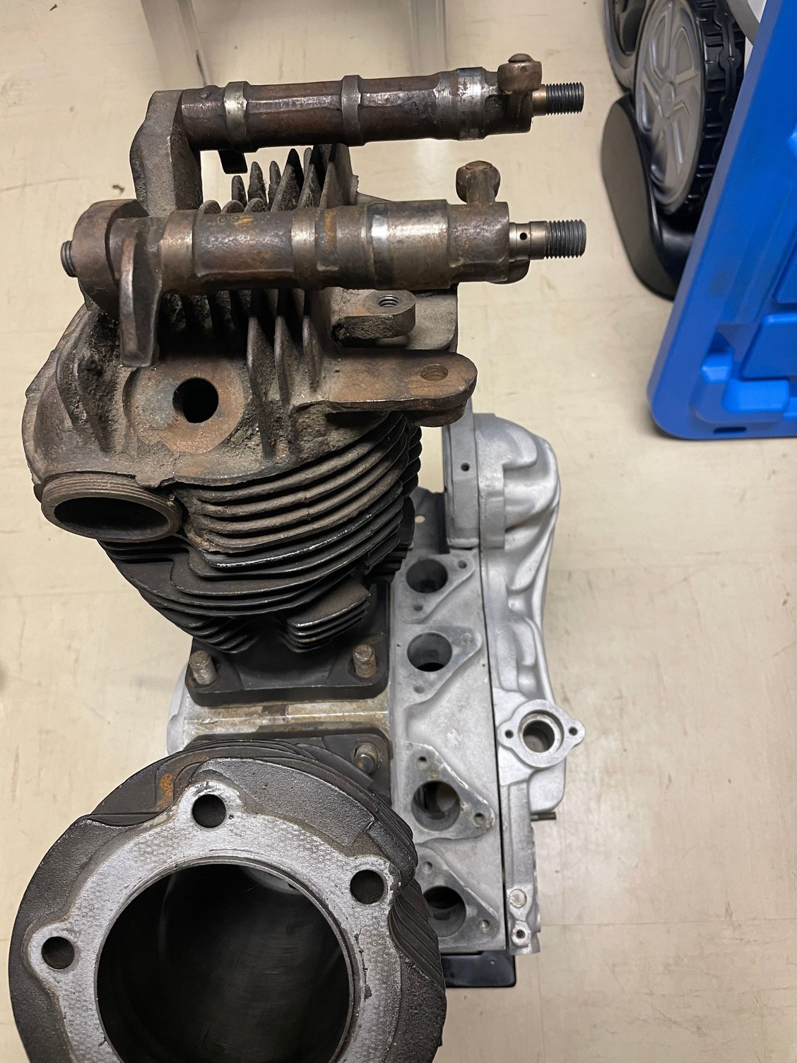

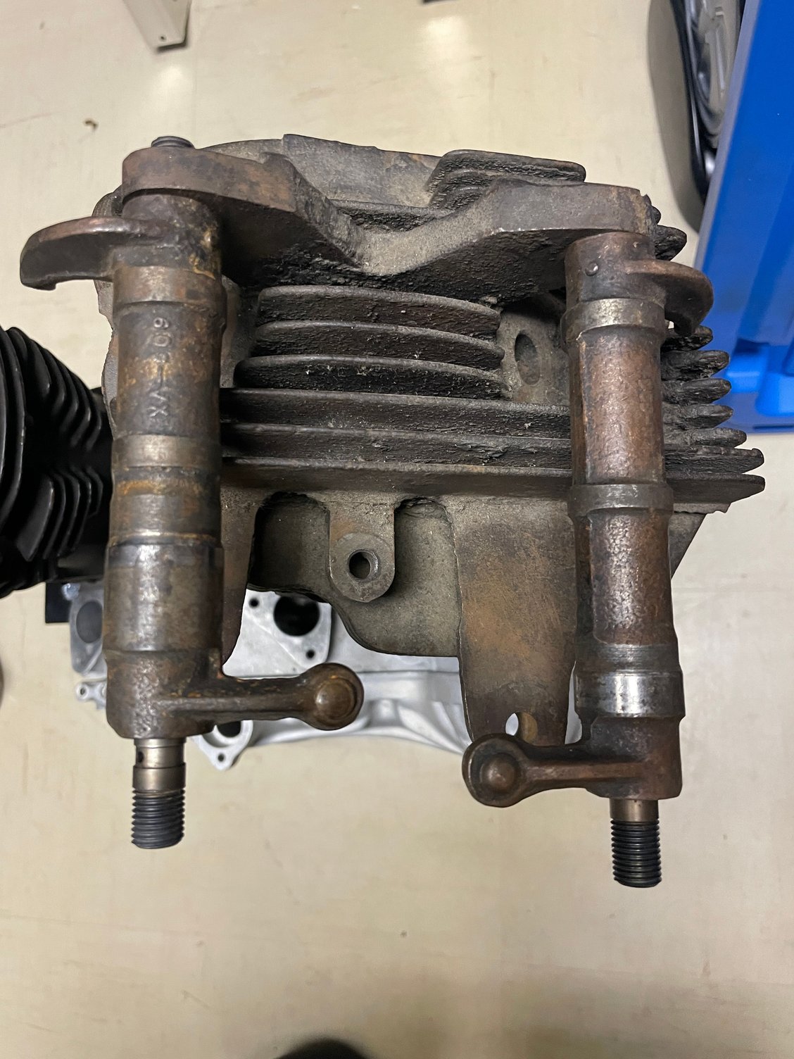

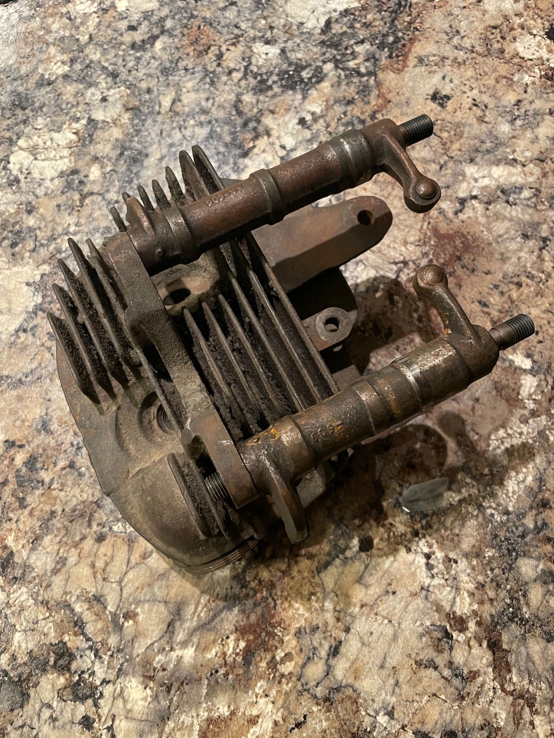

I was looking at this knuckle cylinder head I had in my office and it would need to have the diving boards cut off and some serious welding to allow for the bolt on plates like in the first post. I wouldn't cut an original head up but there's plenty of repops out there looking for a purpose. Or if I come across an original set that have had some mods done that kills the value that could work too.

I debated shovel heads and cylinders, they will fit right on the U engine. It's still a possibility but I keep going back to the look of the engine in the first post. The U cam lobes being direct acting on the valves have a lobe lift of .375" so with a pan head rocker if I went that way it would be roughly .560" lift and around .530" with the shovel setup.

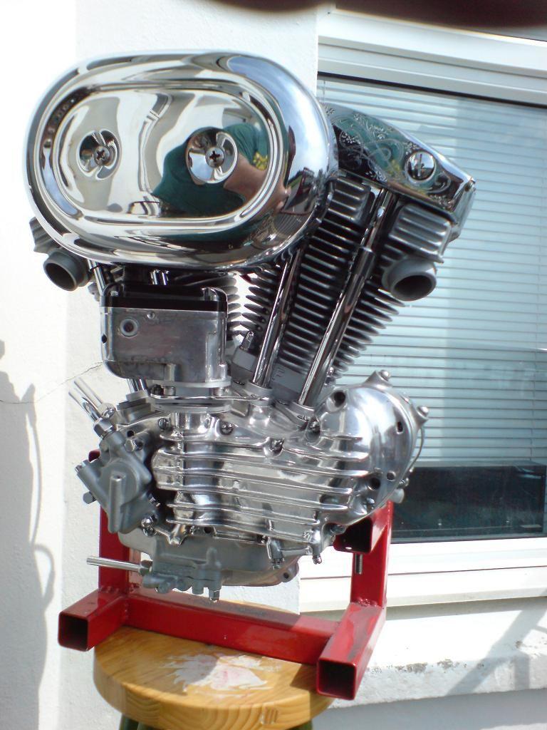

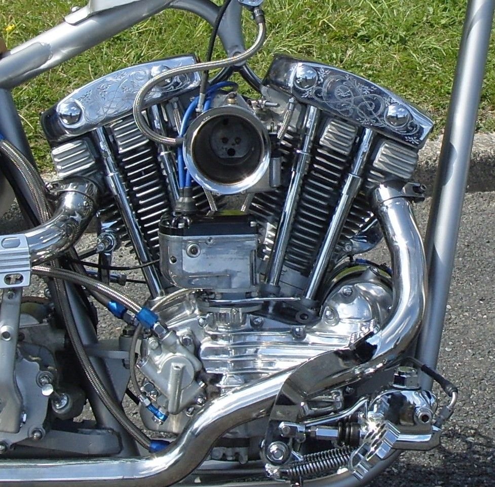

or use a sporty or even a shovel top end,
I built this 45 Magnum about 15 years ago,
something I wanted to build since i was a young punk kid when I saw an artical on Randy Smith back in the early 70's,..
an itch I had to scratch,

Nice build, how did it perform being a 45?

Looks like you could leave the two ears on the left side and just chop the diving boards off and do a flat plate on that side, using Knuckle rockers etc. Didn't the first year Knuckle rockers hang half out in the wind anyhows?

36 and 7 I believe has exposed rocker arms but had what they call a baby jar over the spring with a slot in the top for the rocker to access the valve

Rockers are too long, easy fix. Machine some fins down which will get me closer to the meat of the head where it would be easier to weld on some bosses for the end plates.
