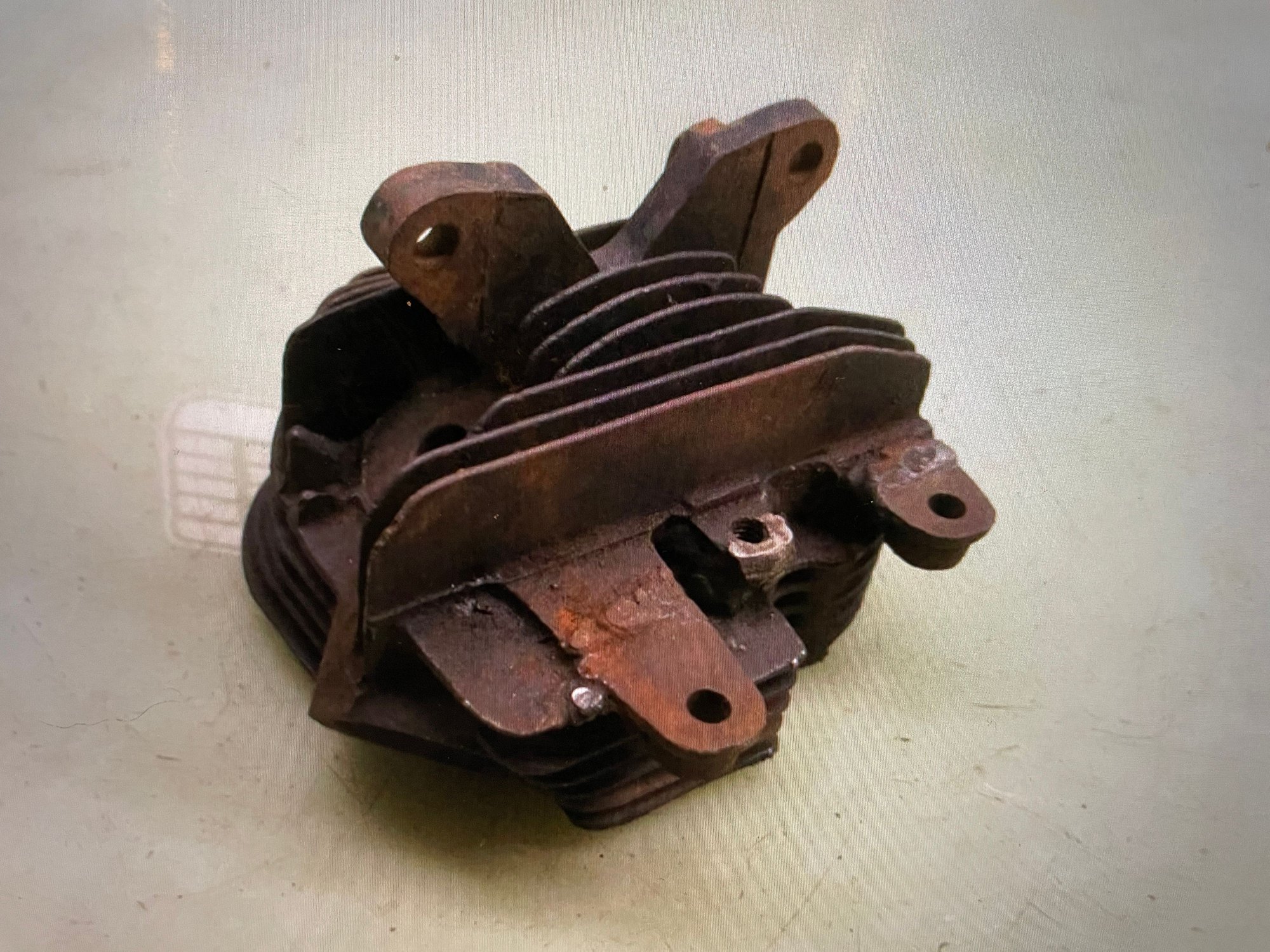

Picked up these two heads, both had the diving boards broken and poorly welded back on. Perfect because the diving boards need to be cut off for this application anyway.
