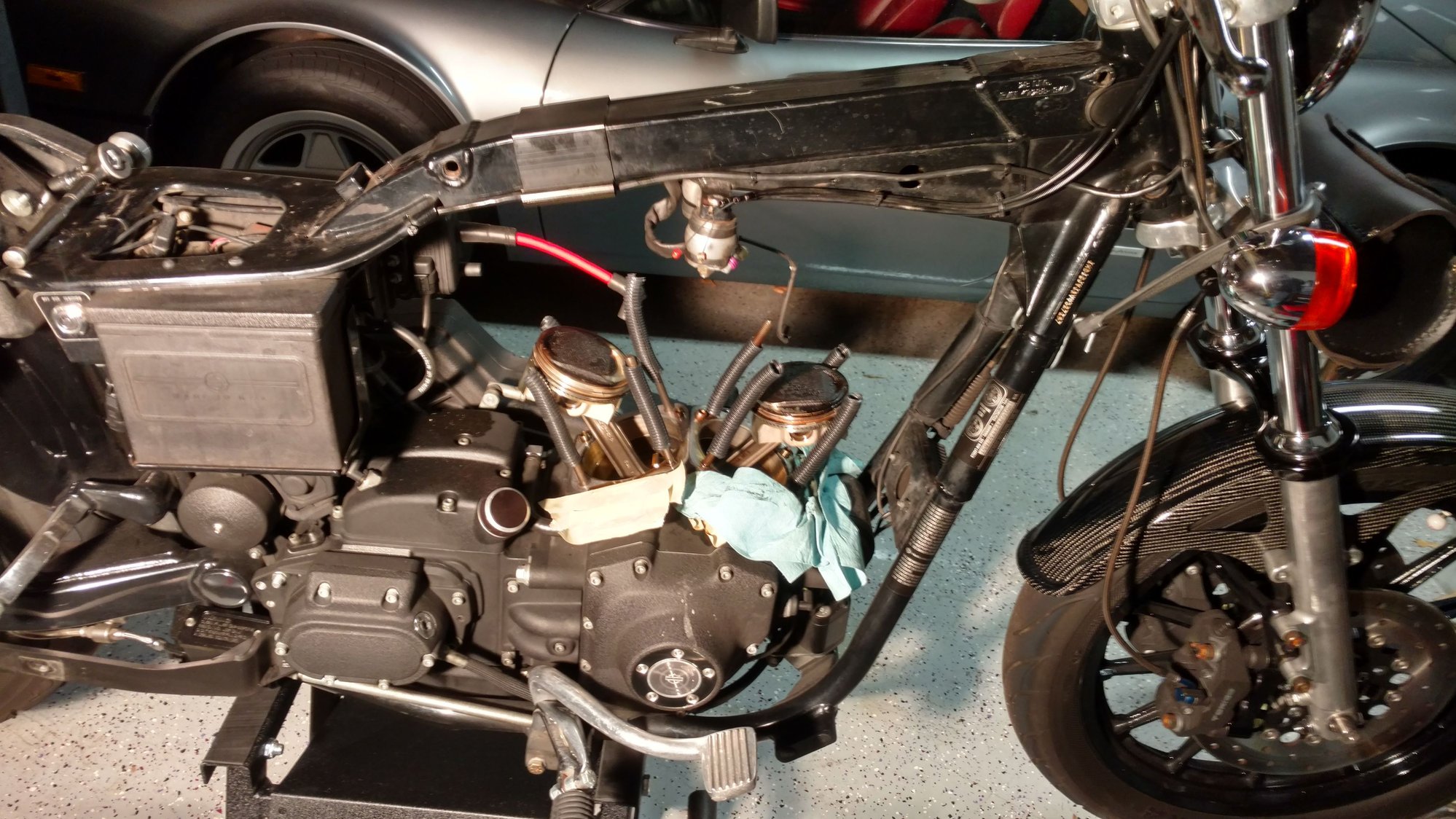

On the first night, I removed the rocker boxes, heads, barrels, and lifters. Since I'm naturally pretty disorganized, I was careful to label everything and put things on lots of clearly marked zip lock bags. And again, I read everything in the manual and watched some videos...
Little bungie cords made pushrod access easy (they're adjustable)...

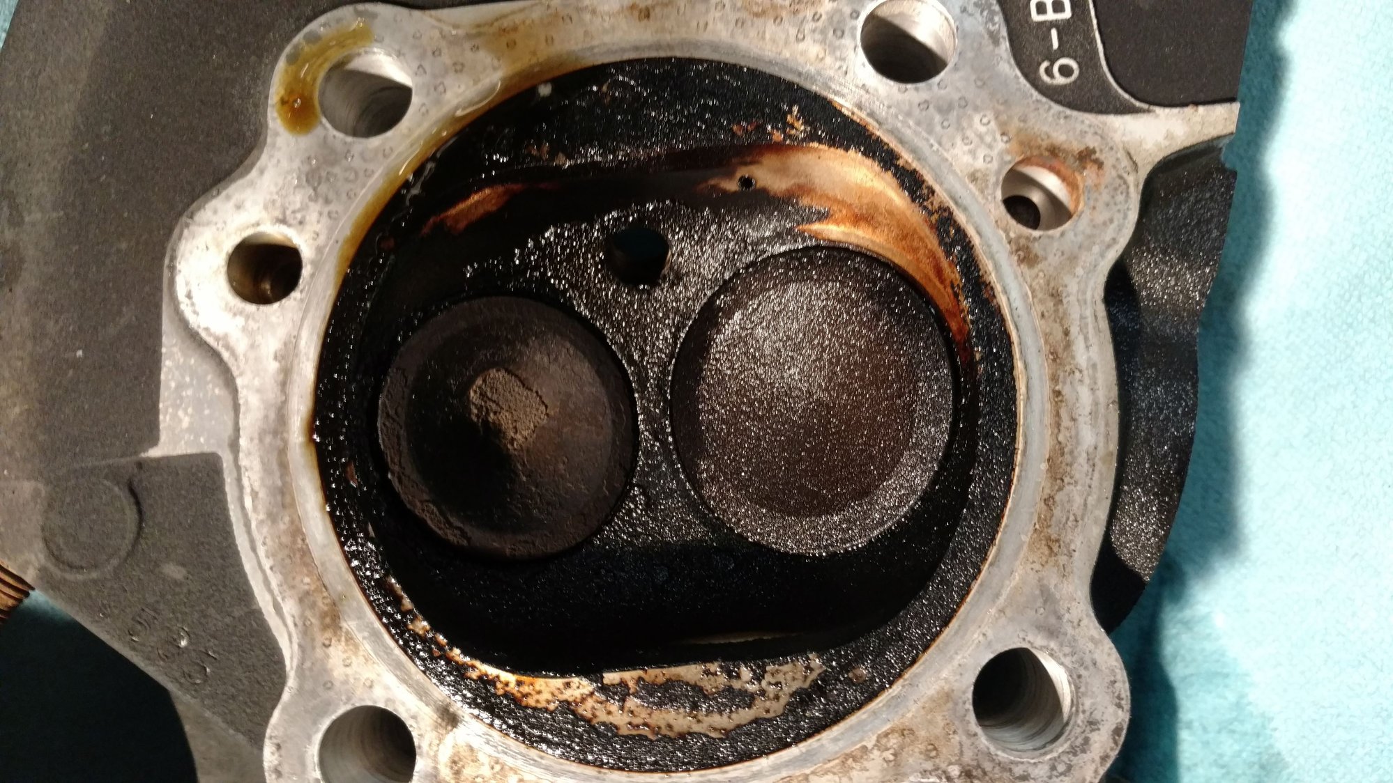

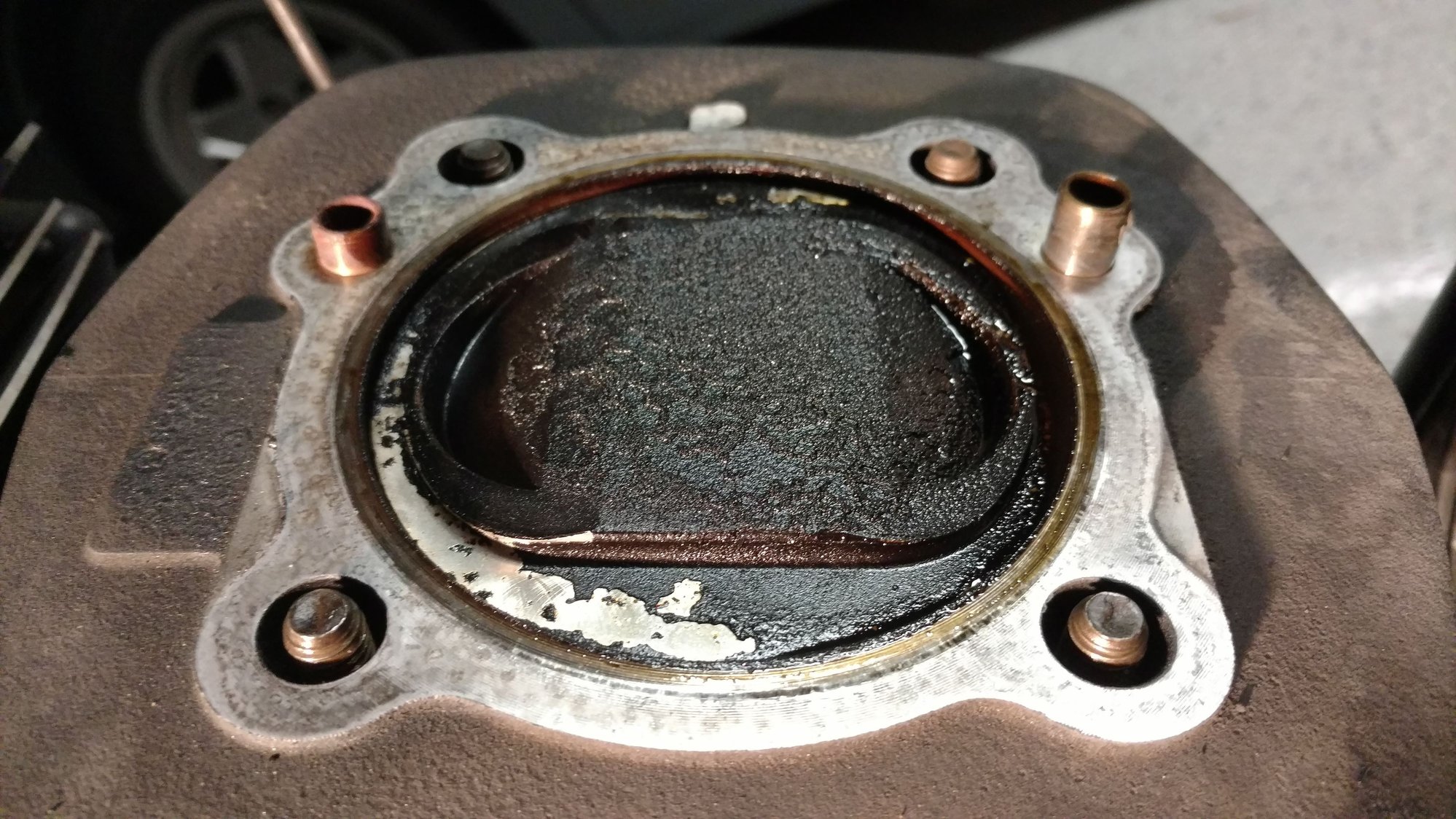

AS I suspected, the heads and pistons were pretty gunky...
Here's how I left it at the end dof the first night, but with a plastic garbage bag carefully taped over the whole engine.

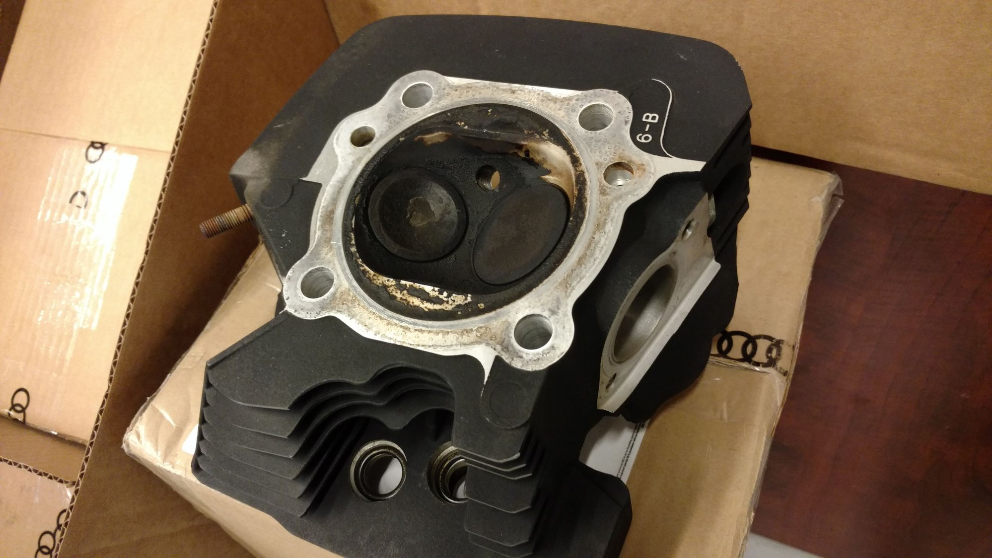

A couple of days later, I brought the rocker boxes, pushrod tubes, and lifter blocks to the powder coater, and boxed everything up to send to North Carolina.

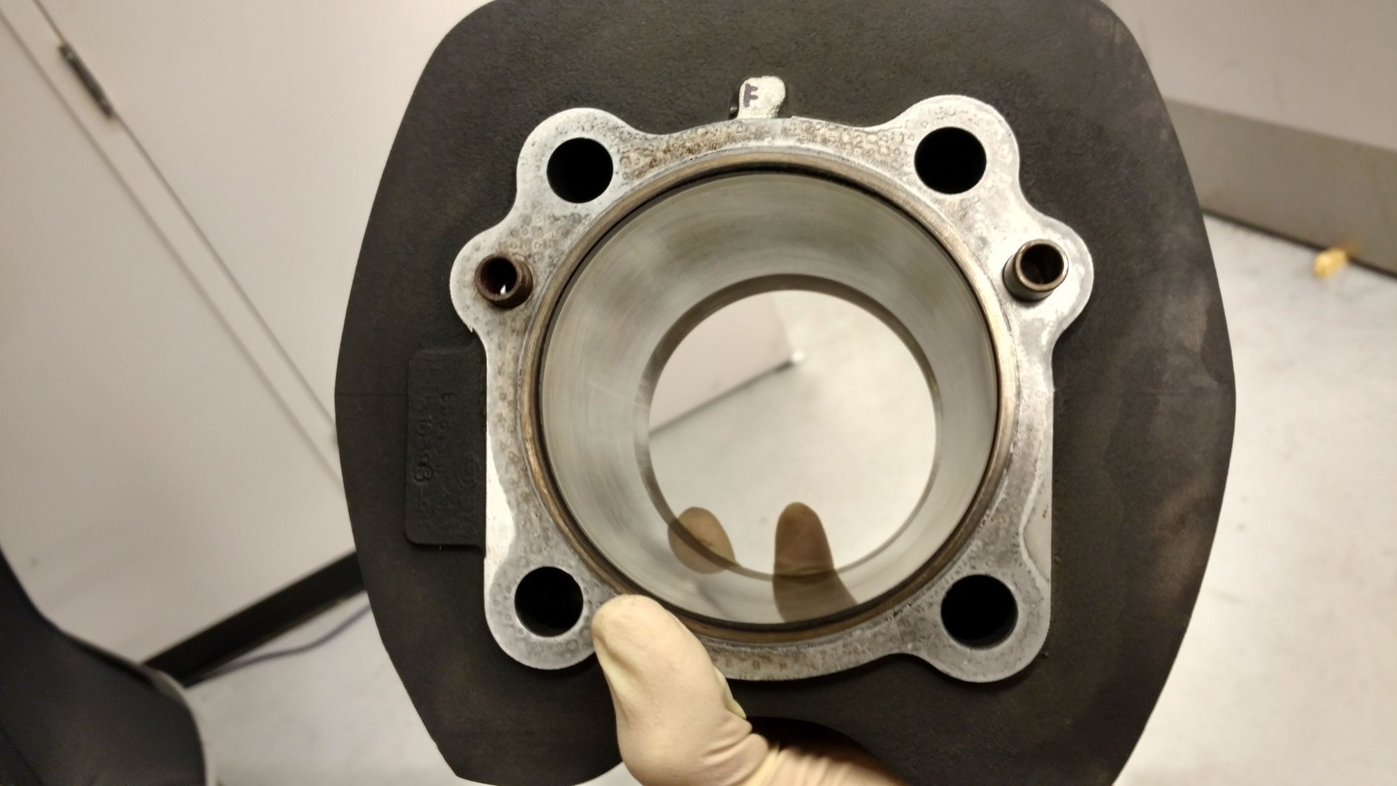

It's hard to see in pictures, but the barrels really didn't look bad... No real scloring, and nice cross hatching.
The original porting work still looked nice too...
