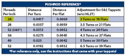

Yes... My pushrods are 24 tpi (I think they're SE "Quick Installs." There was an SE211 cam in this engine originally, later replaced with an Andrews TW60 so SE makes sense. They make two models, one is 32, one is 24). From what I understand, 24 TPI should require 2.4 turns, or 14.4 flats.
.125-.140" Preload Target...
The following chart is for .125" add up to 2 more flats (20 total) for .139"

One thing to note is that the push rod themselves only have 4 flat per rotation so if planing one going 18, you really only want to go 12..
Good clarification point since I really didn't look at the pic of the pushrods themselves to see the 4 flats instead of a hex
One of the reason I notice is that I have a set of those pushrods in my 02 FLHRC and just changed cams from Crane H290s to Andrews TW55s.

follow that s&s vid even though we dont know what brand the one you have are. Did you already do the TPI calculations?
Thanks everyone, lots of great info! I noticed my "Four Flat Situation" when I first took it apart, but then promptly forgot... So thanks for pointing it out again! I'll mark a spot on each one to make it easier to keep track of how far I've turned them...

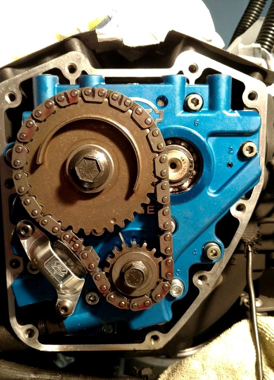

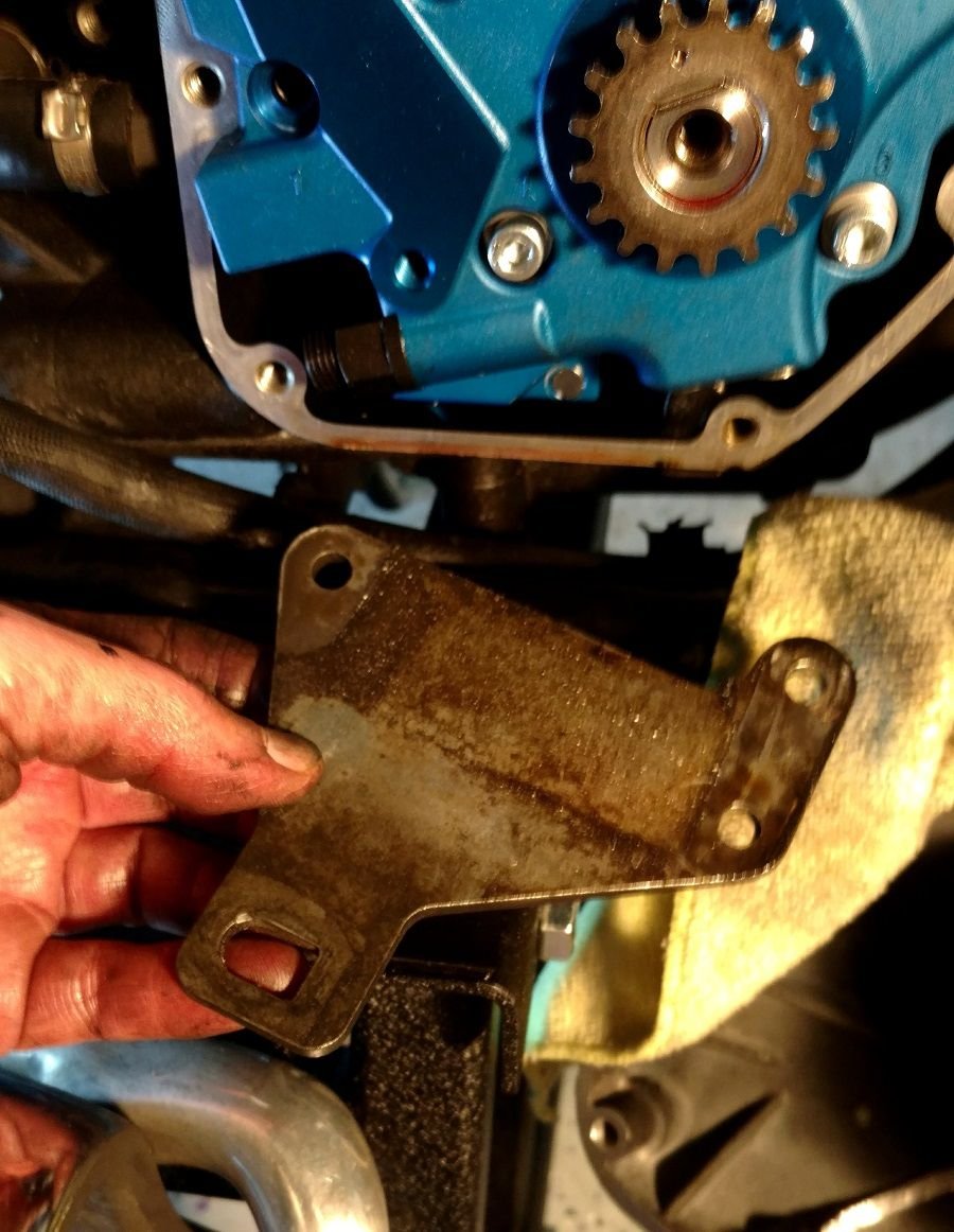

Alignment was good...
Cam chest is done.
And most importantly, my involvement with this pain-in-the-*** bracket has officially come to an end! ...I hated this thing...
