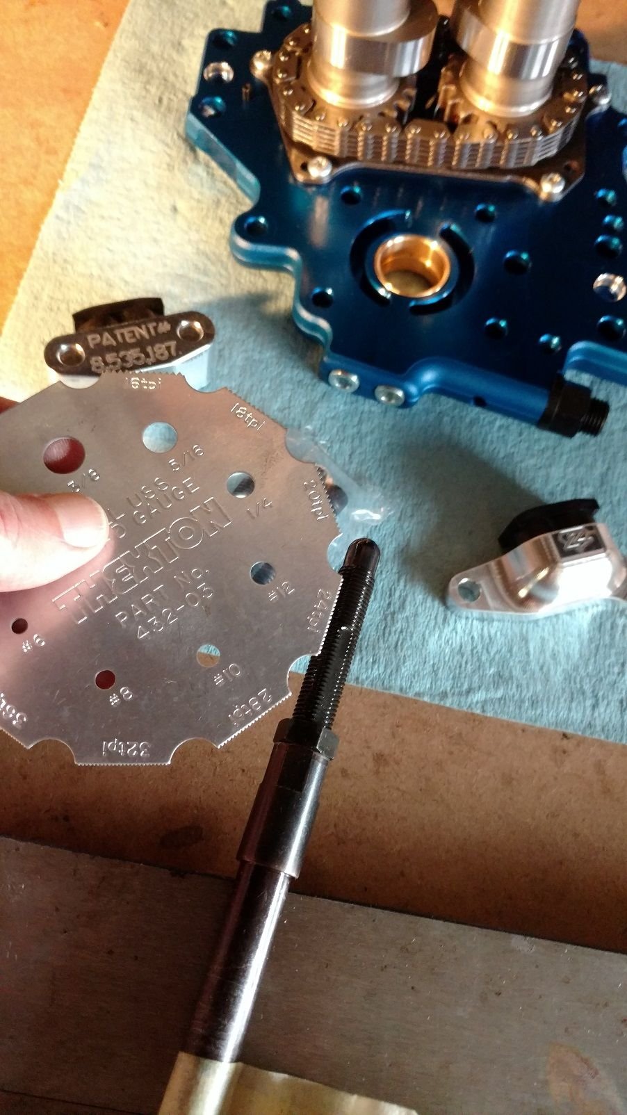

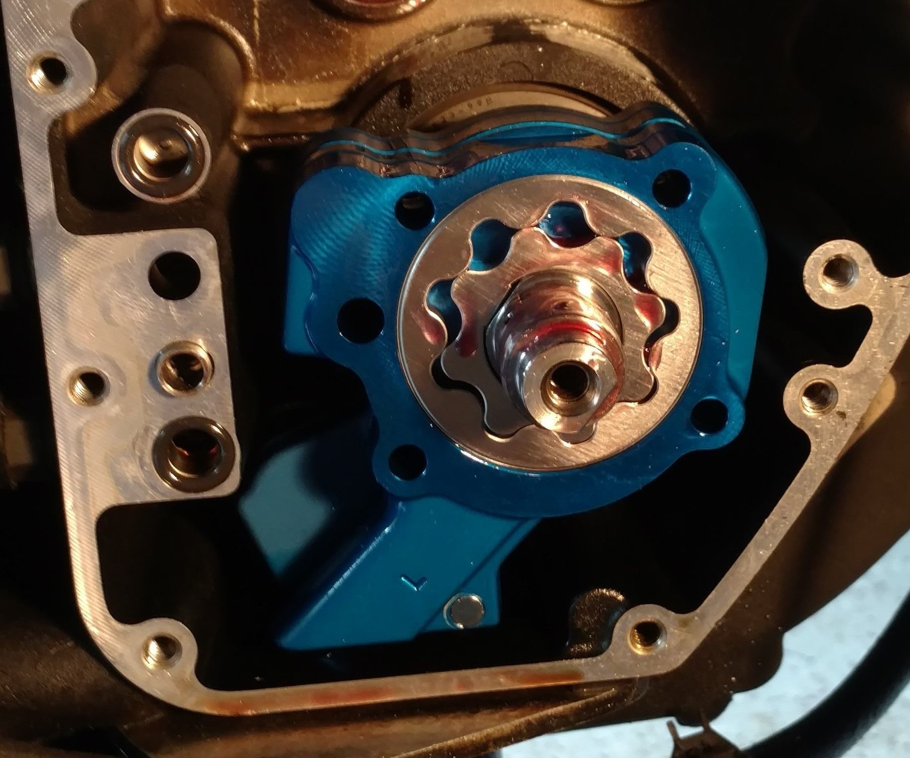

Okay, after a completely non-productive week and a half (at least in the garage), I'm getting back to it... Having to earn a living really gets in the way of things! Since I'm naturally disorganized, forcing myself to bag and label things really makes it easier to pick up where I left off...

Right now I'm side tracked a little bit... I didn't realize that the Zipper's two piston tensioners required some cam cover clearancing... It wasn't really difficult, but up until now I've been able to leave the cam cover hanging by the crank sensor, but I don't think I can clean it out properly without removing it. Annoyingly, it looks like I have to take half the wiring harness apart to do so. I'm currently contemplating it...

Hmm. I didn't see a connector, and my shop manual says to disconnect it under the seat and feed the wires all the way out along the frame... But I may have misunderstood. Anyway, the ease of movement of the J&S lift came to the rescue... I moved the bike to the front of the garage, put some big trash bags behind things, and was able to use a combination of solvent, brush, hose, water, and compressed air to clean it out properly.

Finally things are going back together instead of coming apart...
