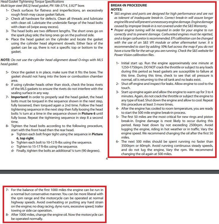

There are definitely a million different opinions about break-in... Since my pistons and cams came from S&S, I decided to follow their recommendations:

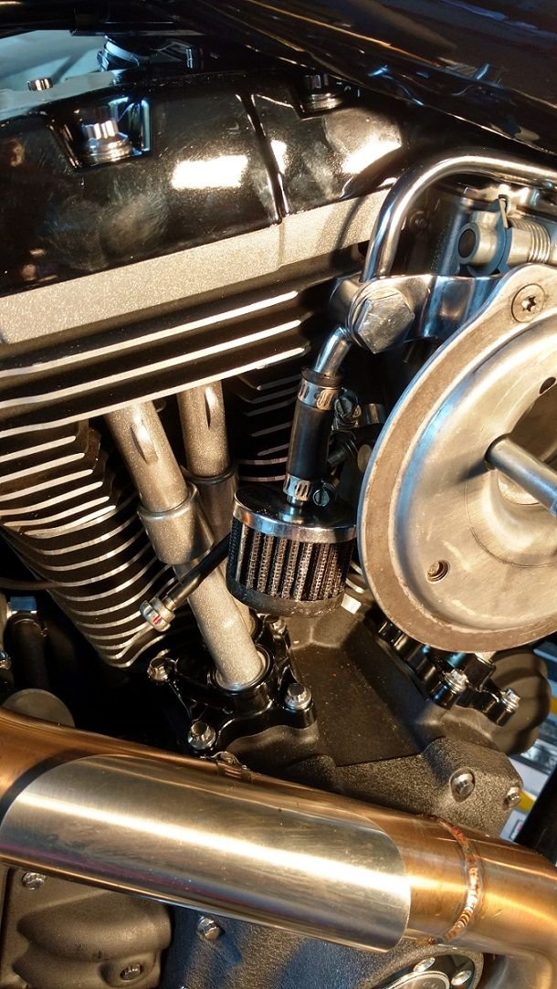

As far as some oil smell goes, I have a little bit, but it's less than it was during the first 50 miles. I assume that some oil gets past the rings until they're fully seated... I'm also not sure now whether the occasional hot oil smell I notice isn't just coming from my breathers. They vent through an open filter that sits right where I would probably notice it when sitting still. I'm never aware of the smell when moving.

So, I passed 500 miles last night. No leaks, no funny smells - except a little bit of hot oil smell sometimes when the engine is hot and I'm sitting at a light. It's not a burning oil smell, and there's no smoke from the pipe. I think I'm just catching a whiff of the external breathers here and there.
I am starting to imagine an "off" noise occasionally, but it may actually be in my head. Sometimes at idle once the engine is hot I think I hear a slight knocking sound from somewhere, the kind of noise that makes me paranoid about low oil pressure. My idle is set around 1200 right now, so it's not running too slow. I never hear it until the motor is really hot, and only at idle. I'll have to investigate more, but it may be in my head. I should probably pick up a stethoscope for this sort of thing.
Otherwise, all good so far. I changed the oil and filter at 50 miles, oil only at 250, and shortly I'll do oil and filter again. I haven't seen 4000 RPM yet, but I will soon... It feels strong from what I can tell...

The odor probably is the breathers. I always get a mild oil (and fuel) odor on my old carbed, vented engines. I usually run solid lifters, too, so some ticking is also part of the ambiance.
