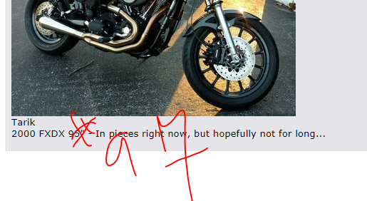

I would expect that the jetting and timing to not be too far off.. IIRC you had a 95 TW60 at something like 10.8 and you went to a 97 at 10.5 with 585s.. I assume that most of this was to fix the oil issue.. Do you think you'll make much more power?
I dunno... Of course I hope there is something extra! I think the 585s should pop a little bit more, and the heads were opened up further... I'm not really sure if compression went slightly up or slightly down, as I don't know the exact volume of my heads. But yes, you're correct that the impetus for all of this was an increasing ping (probably from carbon buildup) and some oil starting to burn (and the rockers starting to leak)...
If everything had been fine but I really wanted more power, I probably would've gone in a different direction (maybe)... Like an S&S 124 possibly...
The original build didn't suck, at least for a 95... 106 HP, 108 Lbs/Ft...
I would probably be satisfied with 110 all around... For now...
