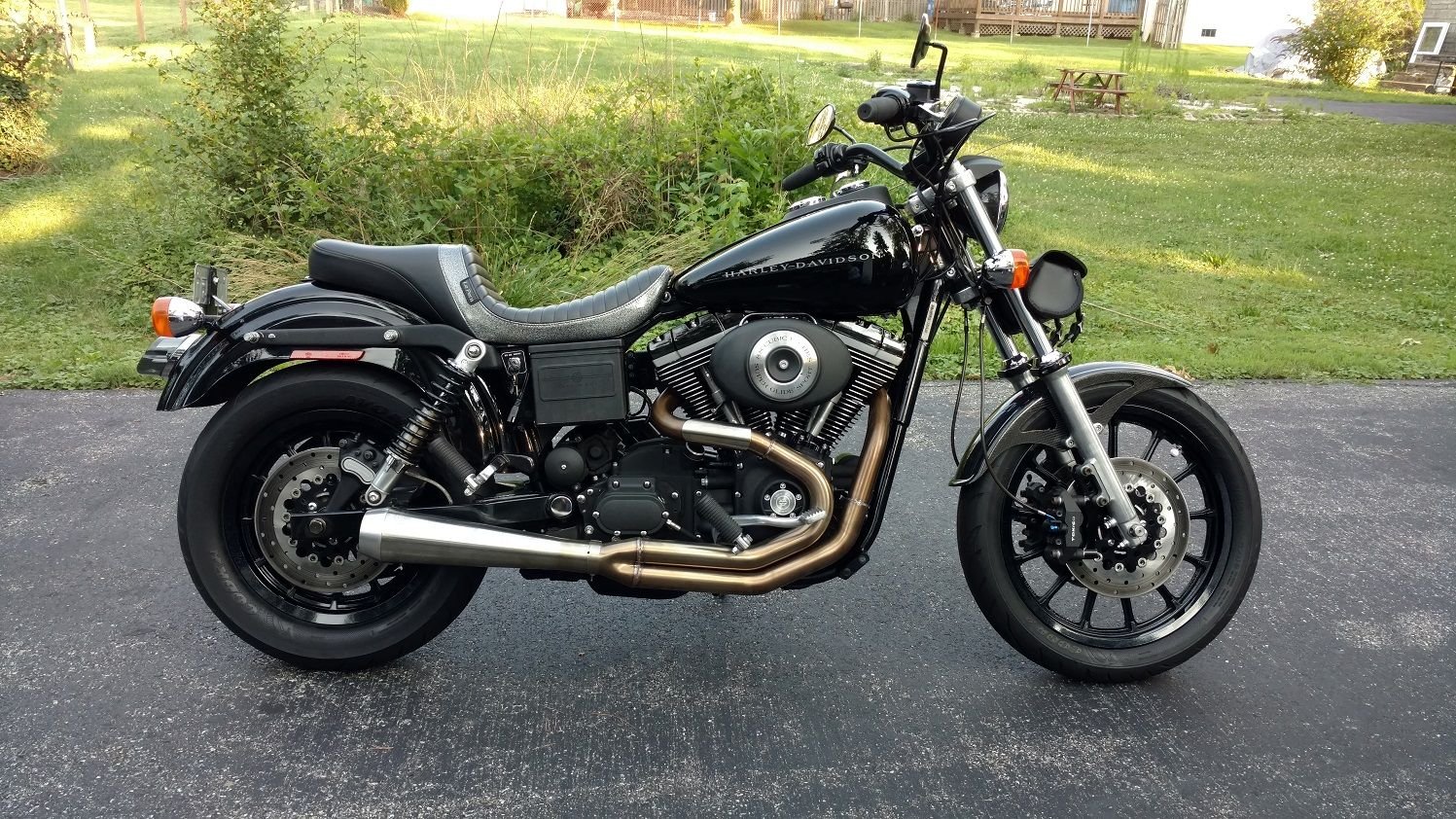

Tuesday is my day off (although I had to go to a dumb meeting about advertising this morning and didn't get home until around 2...), so the garage beckoned... Pretty much just little stuff left. I installed a Bunk King shift linkage, which I'll have to get some nicer hardware for:
Then the tank went back on. The quick release valve in the crossover makes this so simple. I never drained fuel or anything.
Time for the air cleaner...
...And finally the bike is off the lift, all put together! Mental checklist: Fresh oil and filter; plugs gapped and installed; SE Selectable Ignition set to the "safe" curve recommended by Andy Simon prior to dyno tuning... After oil was in but before plugs, I cranked the engine for a moment... No bad noises...

So... This just happened:

Looks Ace, man! Really, really dig those jet blued stainless head pipes! I need to find somebody to make me some stainless (or titanium!) drag pipes.

Thank you Chris, I appreciate it! But there's so much about your bike that just plain rocks!
