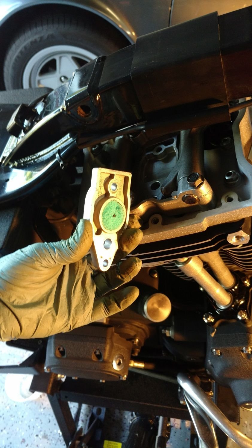

I pretty much finished yesterday, although I haven't started it yet...
Finding TDC was pretty easy, I used a wood kebab skewer in the spark plug hole, and watched the tops of the pushrods to make sure I was on the compression stroke (which of course meant both lifters were on the base circle).

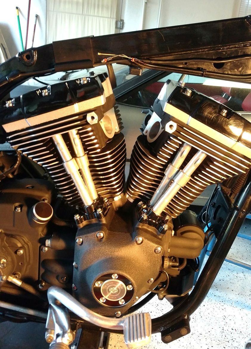

My pushrod tubes are 24 TPI, with 4 flats per turn. I lengthened each one by 13 flats, which should equal preload of 0.1355" (thanks Max and Multi!).
And... FINALLY the long block itself is all buttoned up!

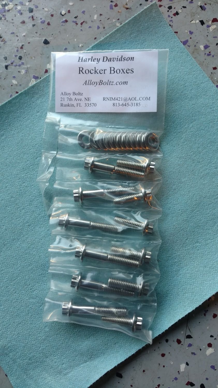

A little bit of added bling comes from Alloy Boltz... I got one of there super-nice sets of polished stainless ARP hardware for all of the external engine stuff... They really do a nice job putting these sets together!

Can you post me a link of where to get those rocker box bolts. I could use a set. Please and thank you
