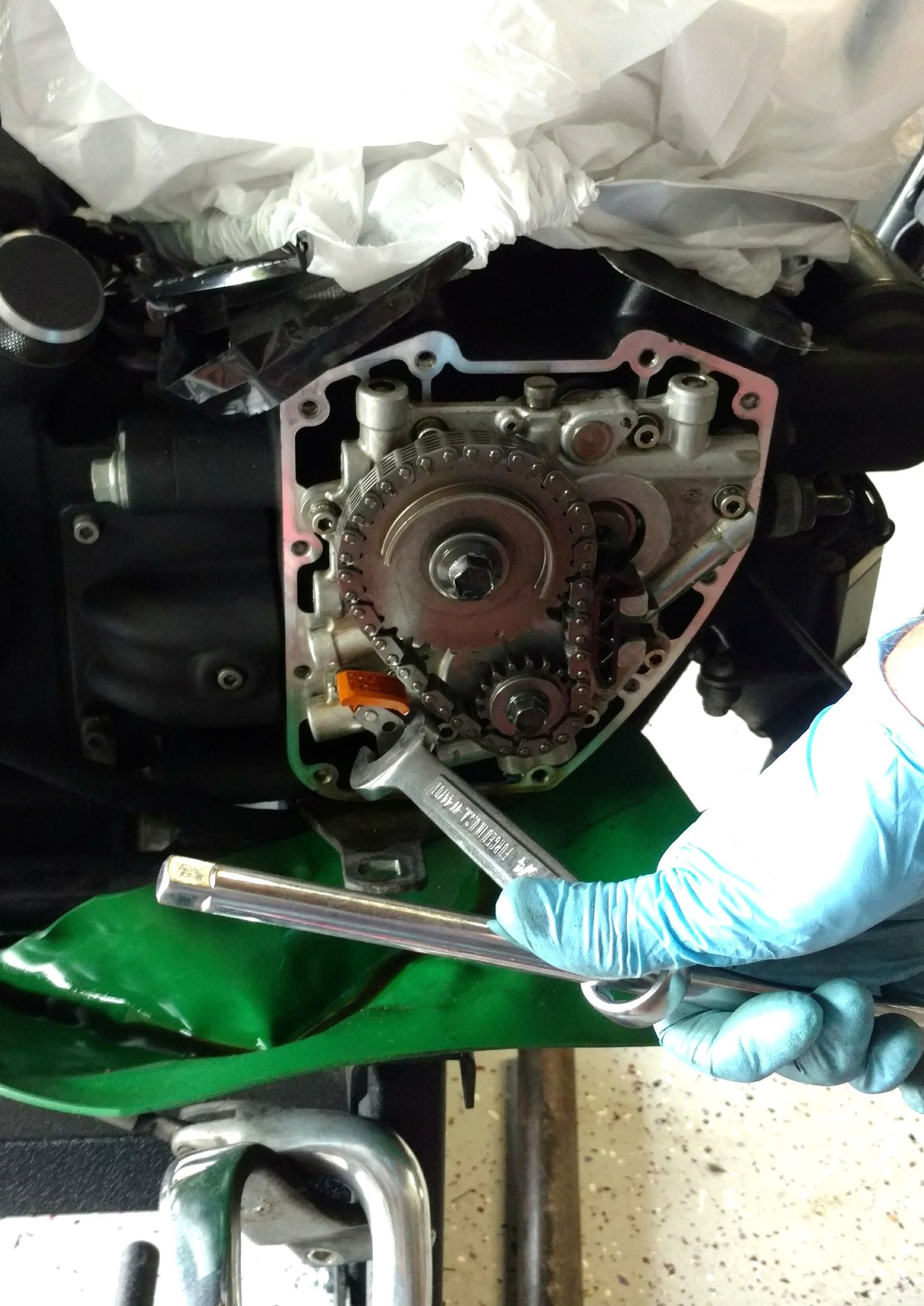

Today's project: Cam Chest.

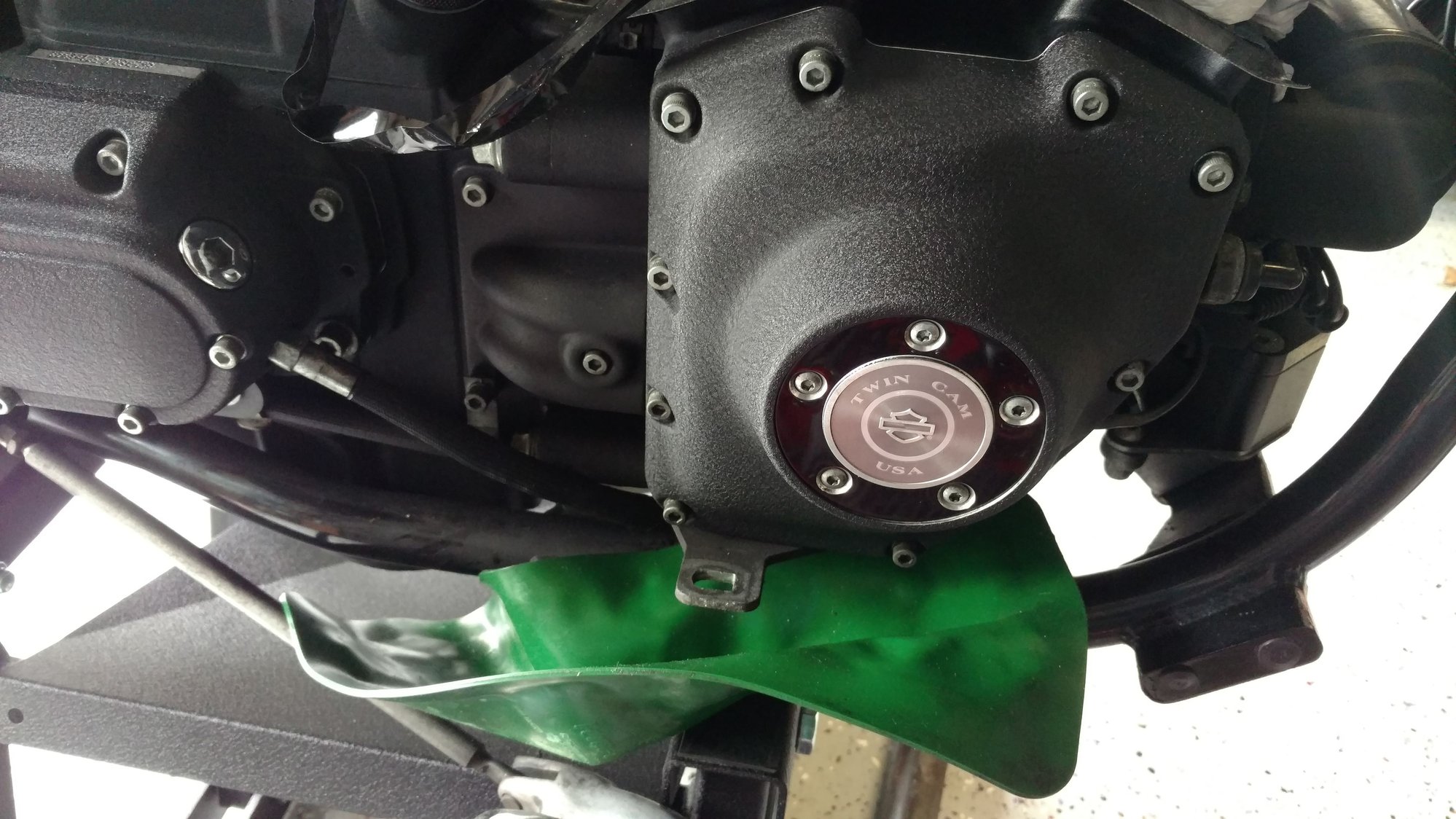

The first thing I did was position this handy form-a-funnel to direct oil onto the J&S fluid tray, and in turn into a pan. It worked well, and kept things pretty clean. I really should've removed that annoying unused exhaust bracket first... Oh well, I'll get to it...
Then, on to unbolting stuff...

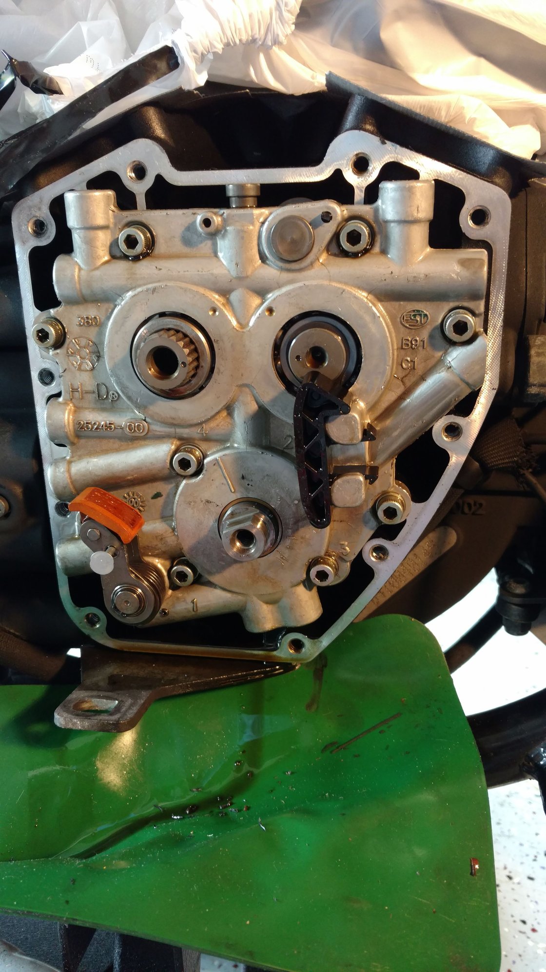

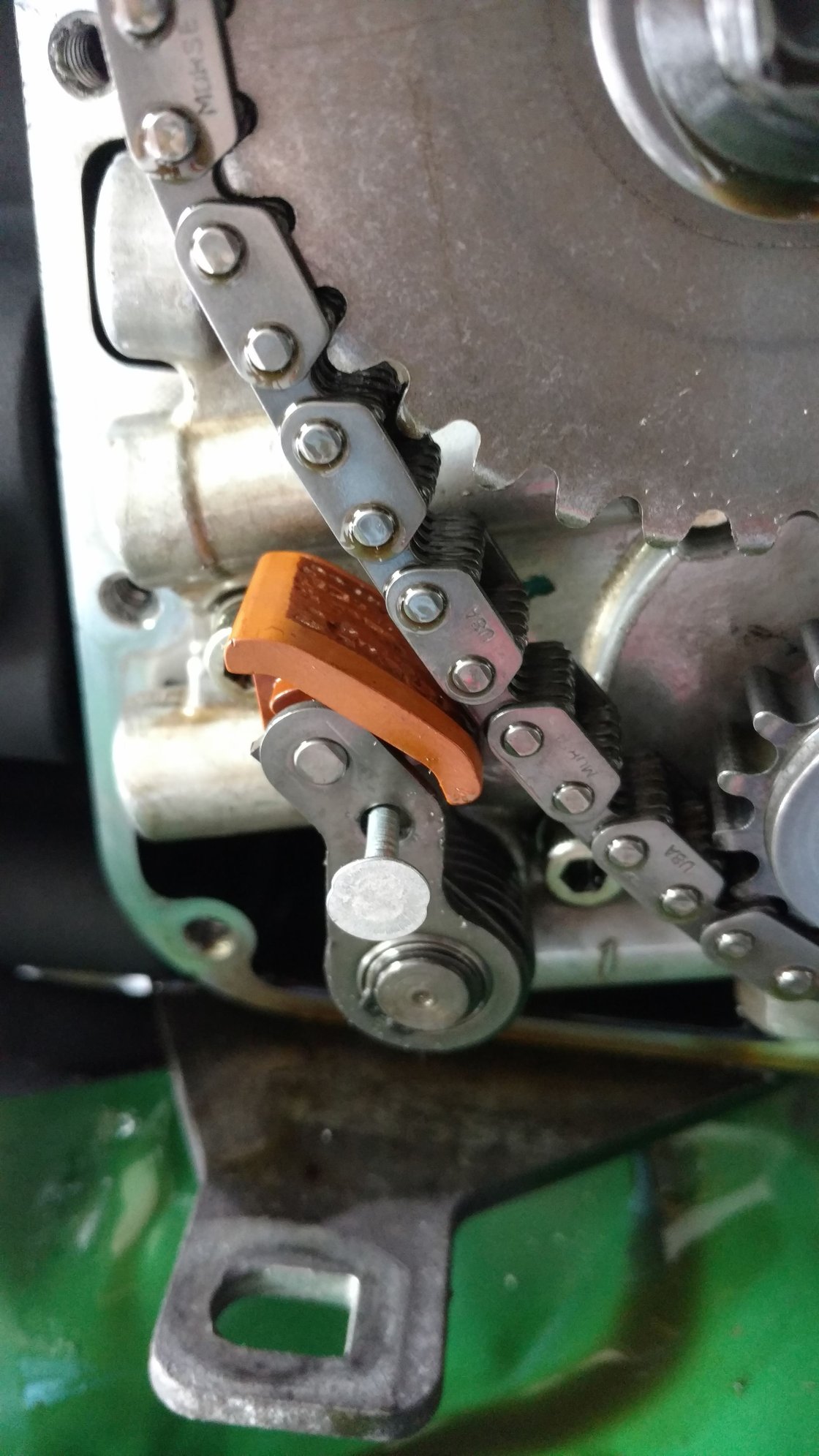

I collected a bunch of special tools for this project, but the little clips to hold the tensioners seemed unnecessary, and they were. I used a 3/4" open-end with a long extension through the box-end to work like a T bar, and this worked perfectly to unload the tensioner:
A roofing nail worked well to hold the tensioner in place:

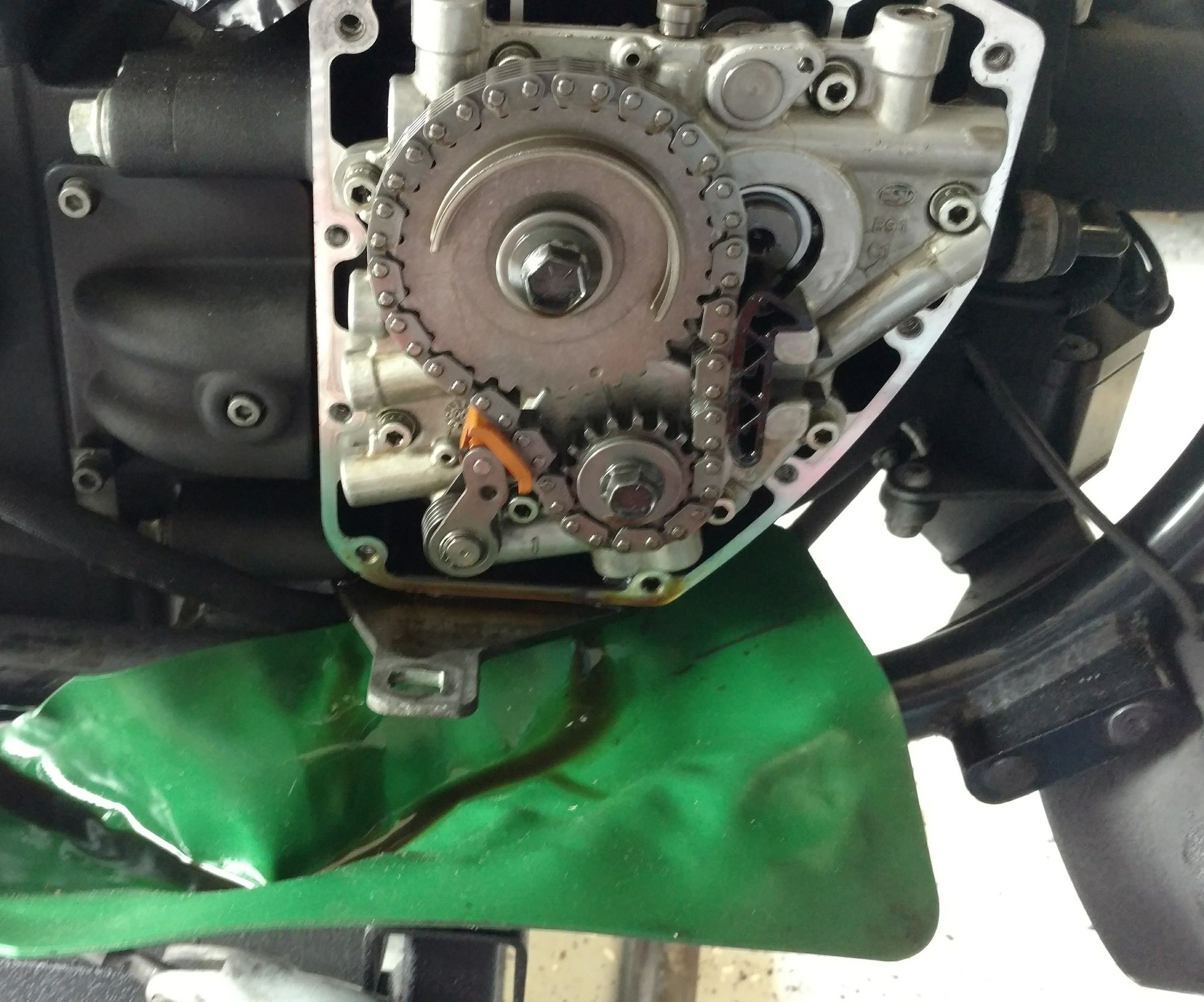

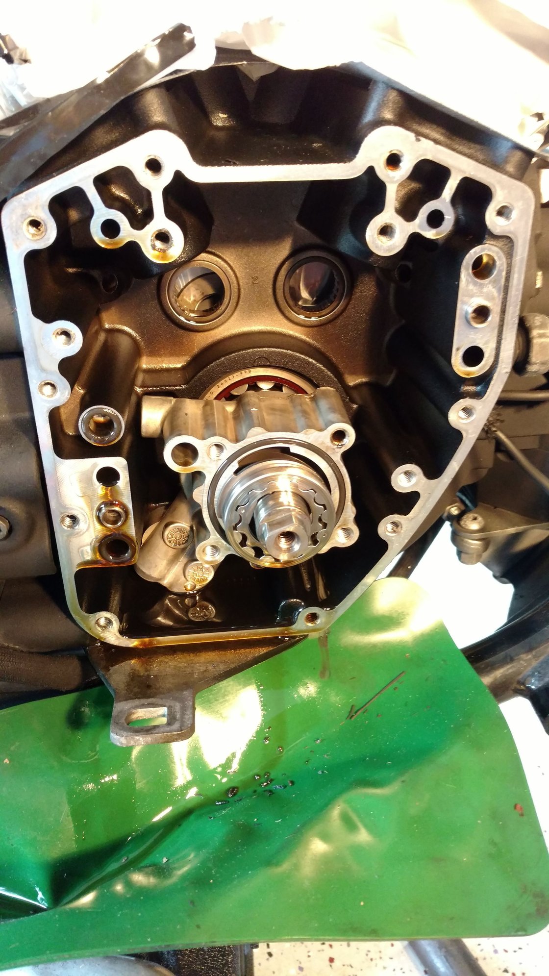

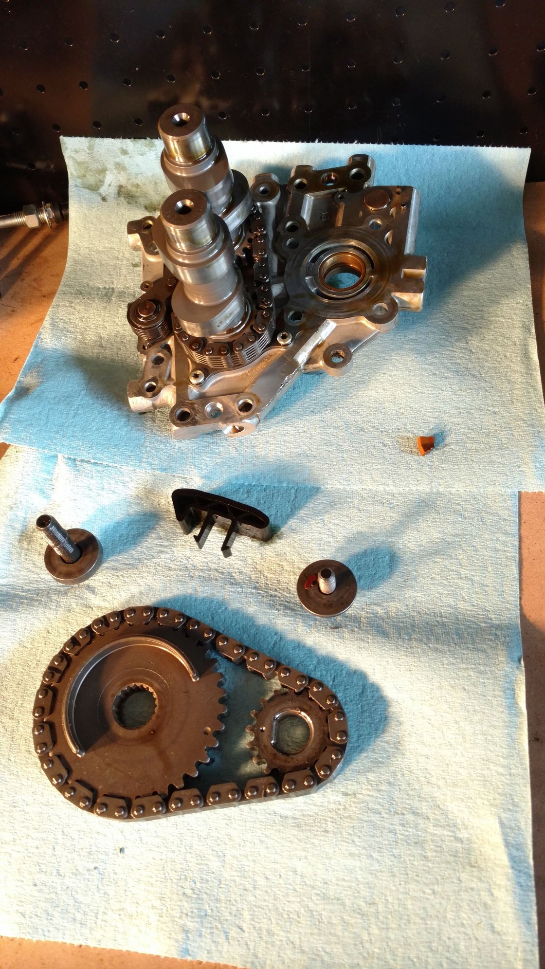

The outer drive sprockets and chain came off pretty easily, although the $16 cam locking block was a little bit of a pain... It's made out of a hard plastic, and it didn't fit perfectly. I was able to gently malletize it into place, but it left some plastic shavings in the sprocket teeth. I'll just make sure I clean everything well. As recommended, I marked the outside of the chain to maintain orientation during assembly. The cam plate came out easily once the outer chain was off.

Note the little piece of tensioner that I found on the bottom of the chest... I'll inspect everything carefully. I don't think these would've gone 65,000 miles the way cggorman's did! I think these only have about 17,000 on them...

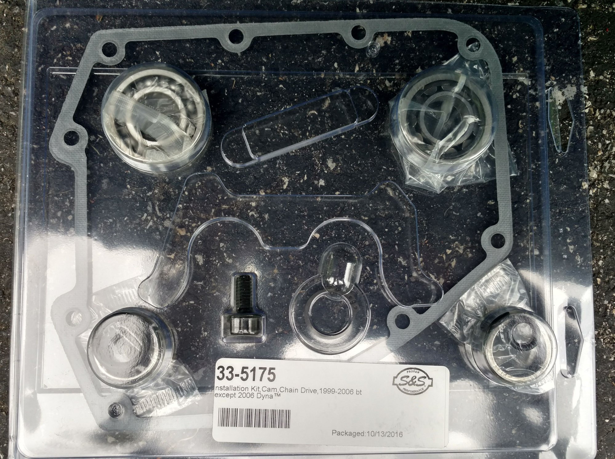

Years ago, I was always taught that fresh bearings should be thoroughly cleaned in a parts washer, then blown out with air prior to use. Still true? Should I do that with the inner and out cam bearings prior to installation?
Same question with regard to lifters... I have new S&S lifters, which are packaged and sealed in light oil... When I'm ready for them, should I clean them thoroughly before installation, or should they be ready to go as is?
I never really trust the "pre-washed salad..."

When I rebuilt my brothers S&S 88 engine, the lifters were already loaded with oil and the bearings are packed with grease. I installed as is. Engine runs strong.
