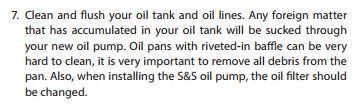

Thanks for the input, everyone. Here's what it says in the S&S cam plate instructions:
And in the oil pump instructions:
I just wasn't sure whether this was in the category of "we'll suggest you do this even though it isn't usually necessary so you don't blame us if something goes wrong" or if it was more like "if you don't do this, you're an idiot and your new parts will become damaged, destroying your motor."
My impression is that frequent oil changes during break-in should suffice.
My Vote...

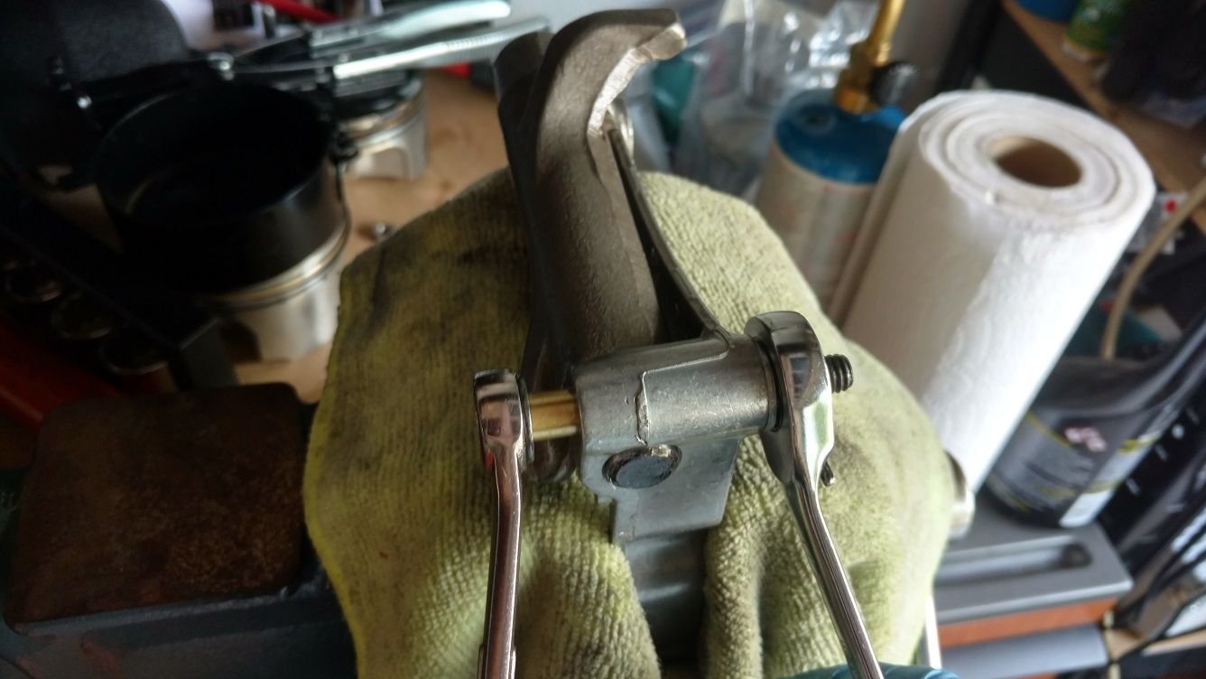

Well, I didn't quite finish today, but I really think I will on Sunday... I installed the Rockout pieces in the rocker supports, which went pretty smoothly. But it is super nice that they give you five inserts instead of four... I needed the extra! The first one mushroomed as I pressed it in... Thanks, Rockout!!!

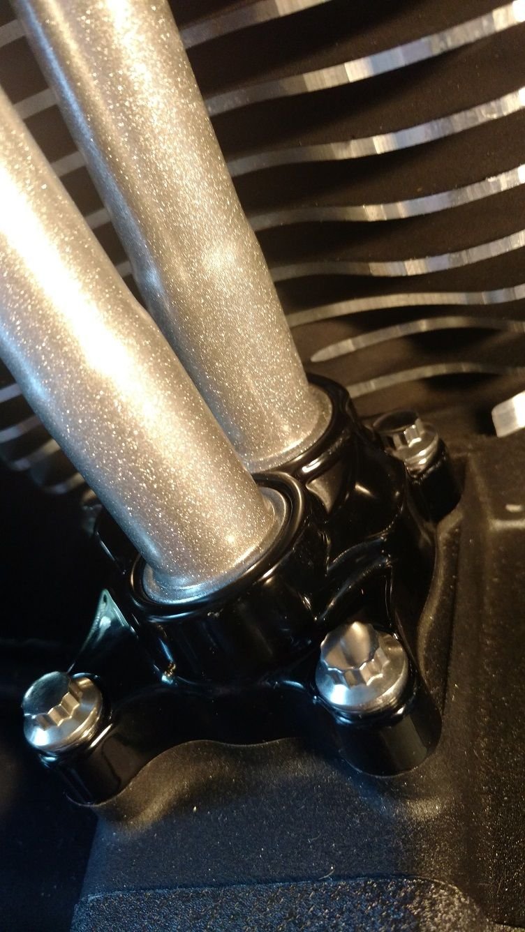

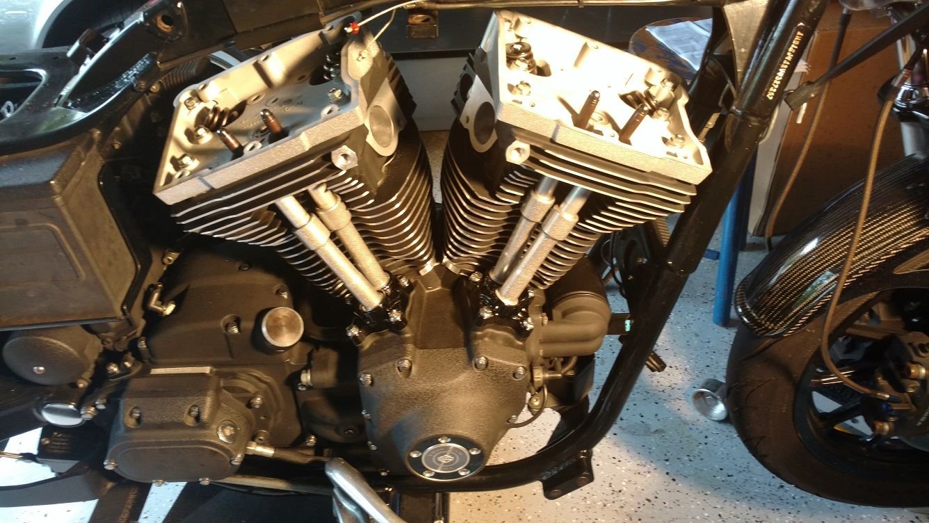

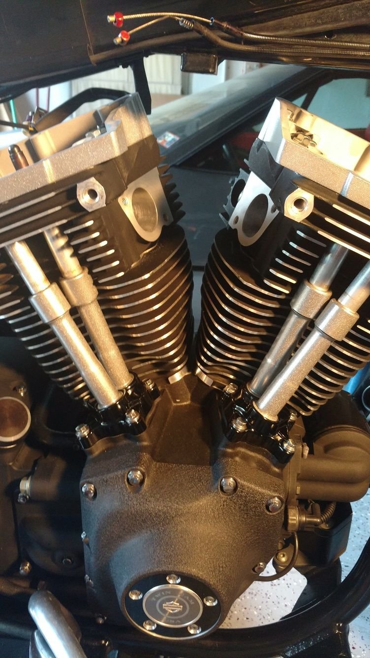

I got the lower rockers installed, as well as the lifters, lifter blocks, and pushrod tubes. I know it wasn't much, but as usual I ended up with tons of other stuff I had to get done today. I hate that!
I feel pretty good about my powder coating choices... I like the comination of the super glossy black lifter blocks with the metalflake pushrod tubes... The same combination will exist at the top between the upper and lower rocker boxes. I keep thinking of tons of other things to have coated... I think stuff may come apart again over the winter!
