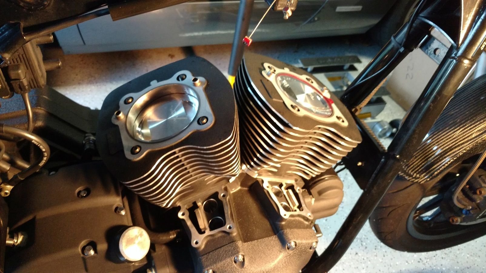

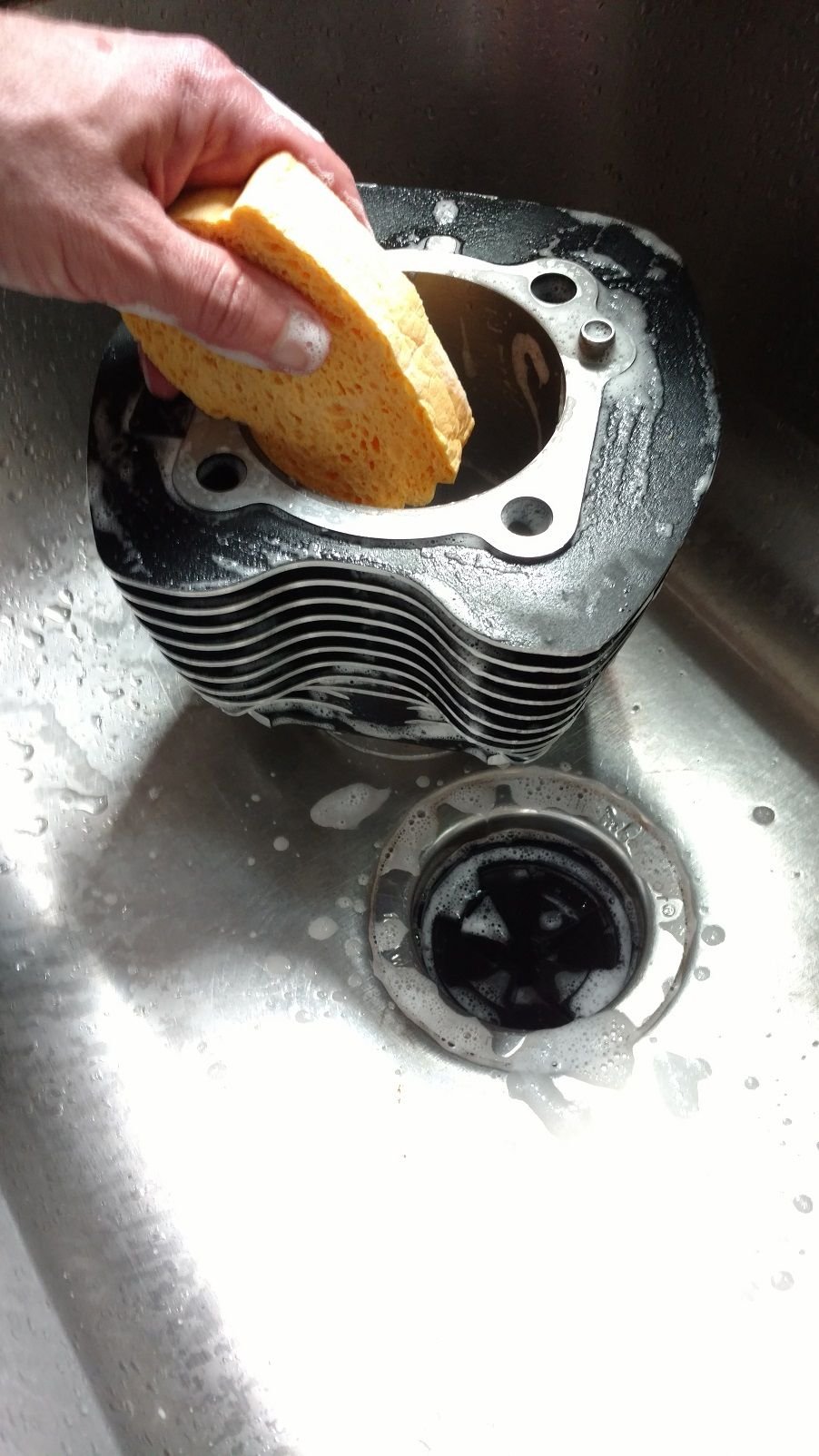

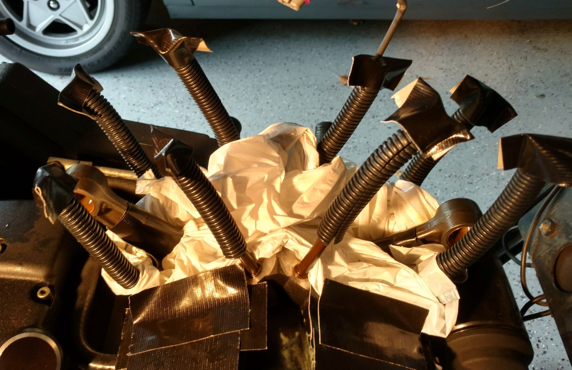

Yes, I know... This is the world's slowest engine refresh... I just haven't had any time! I got a little bit done last night - pistons and cylinders. Of course I started with a good scrubbing...
Then it was time to remove all of the plastic and tape that had been keeping things covered up while I worked in the cam chest... And I discovered one of many bone-headed moves that periodically slow me down. When I first started taking the engine apart, I taped up the lifter galleys with Gorilla tape (which, in hindsight, made no sense since everything was coming out of the cam chest and it would be scrubbed).
Once taped off, they were just kind of out of mind from that point on. When I clearanced the cases for the new cams I did tape off holes and passages from the inside, and then cleaned out the chest when I was done. But last night when I pulled the tape off for the first time, I realized that a lot of aluminum shavings had gotten into the lifter area. I should have taken off the tape and cleaned them out after grinding, but I just spaced on it. When I saw how much debris was in there last night, I contemplated tearing down the cam chest again to clean it properly. Then I walked away for a moment and stopped cursing at myself... With patience and care, I ran some paper towels soaked in WD-40 into each hole, and eventually had them almost completely clean. That was dumb. Oh well... I'll change the oil frequently during break-in, and I think I really did get almost every bit of aluminum dust out of there. I ended up getting them cleaner than in this picture, but I forgot to snap a shot when I was done.

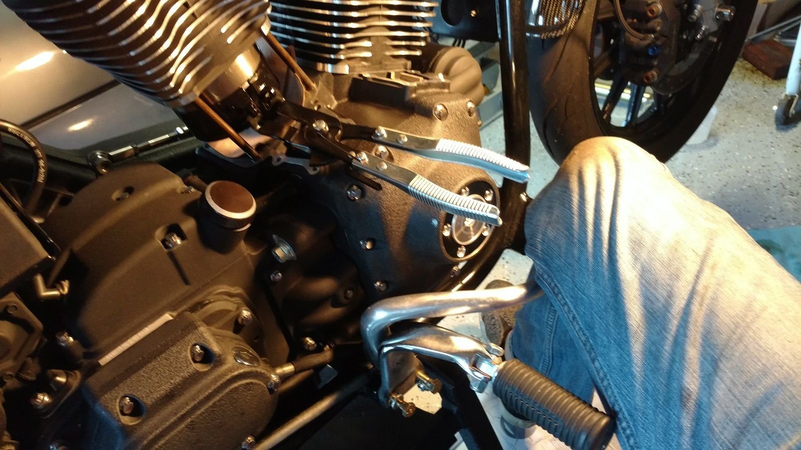

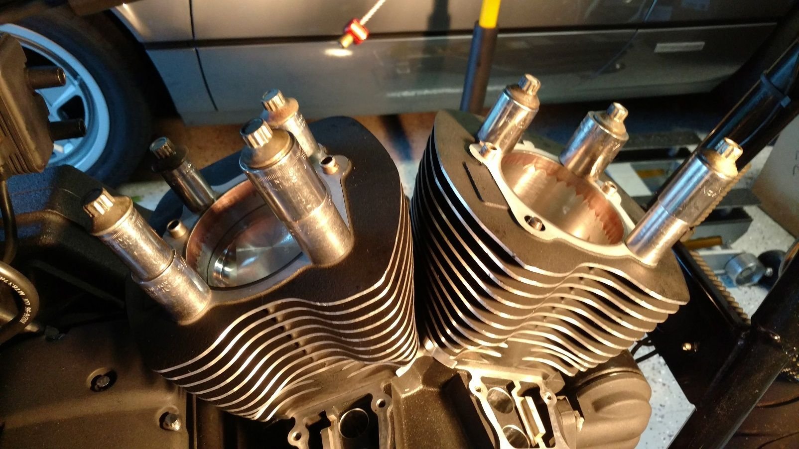

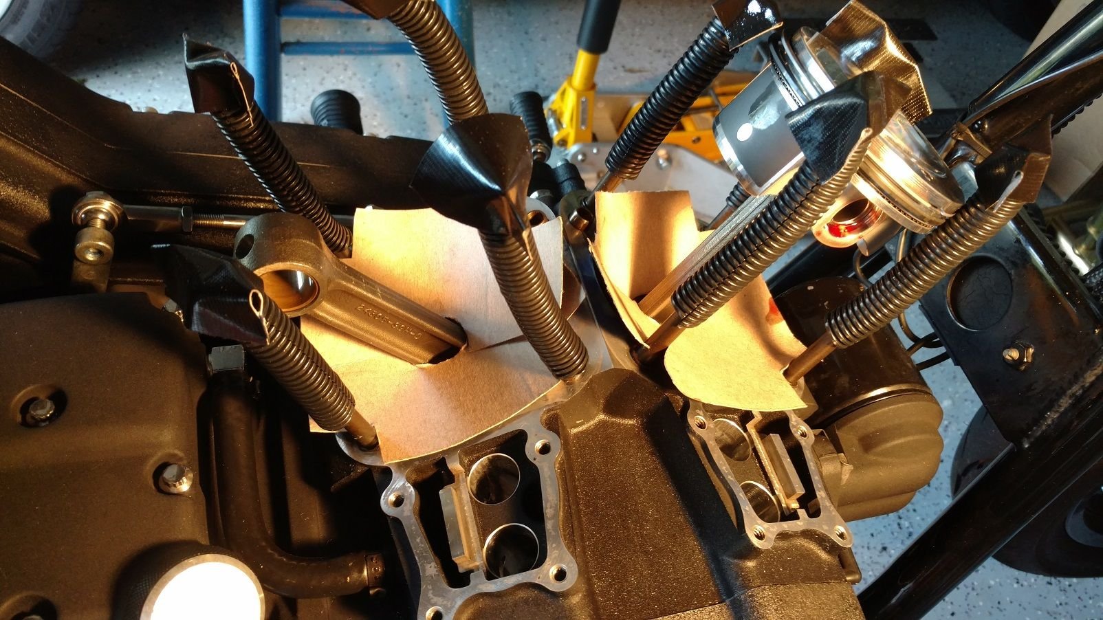

The pistons went on without issue... I had wished that I had extra wrist-pin clips, as I sort of assumed I would lose or damage at least one, but all four went on pretty easily. I did make these cardboard shields to catch the clips in case I dropped one, which was good because one did pop out once and landed right on the cardboard (instead of inside the cases).
The cylinders slid over the pistons easily, no malletizing required. Just some wiggling. draping my knee over the brake pedal kept the crank from turning.
It's finally starting to look like a motor again...
Some 1/2 inch drive sockets worked perfectly as head-bolt spacers, allowing me to rotate everything a couple of times to make sure nothing felt off at all.

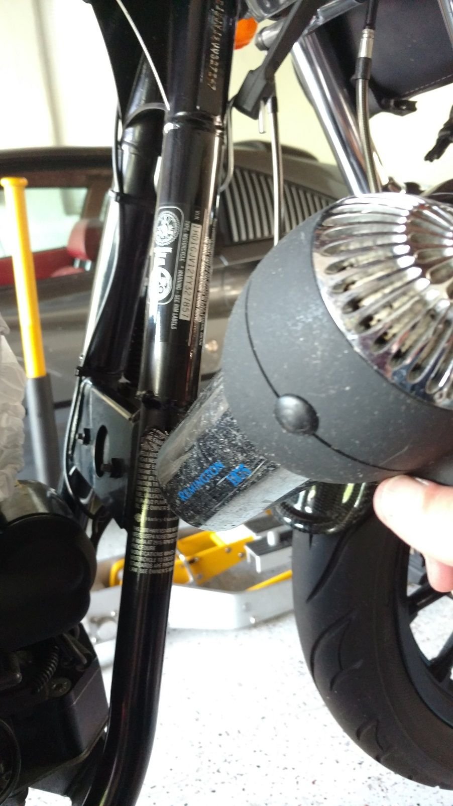

Yesterday I took a little bit of time to clean some areas that were easier to reach without cylinders in place. I also took the factory decals off the frame tube... I never tried before, because I didn't want to end up with torn, impossible to remove, 17 year old remnants, or completely noticeable different shade paint... None of my concerns were valid. I hit them with a hair dryer for a couple of minutes, and they peeled right off. It looks so much better without them!
Since the decals came off pretty cleanly, I stuck them on a piece of card stock to keep with the owner's manual and paperwork.

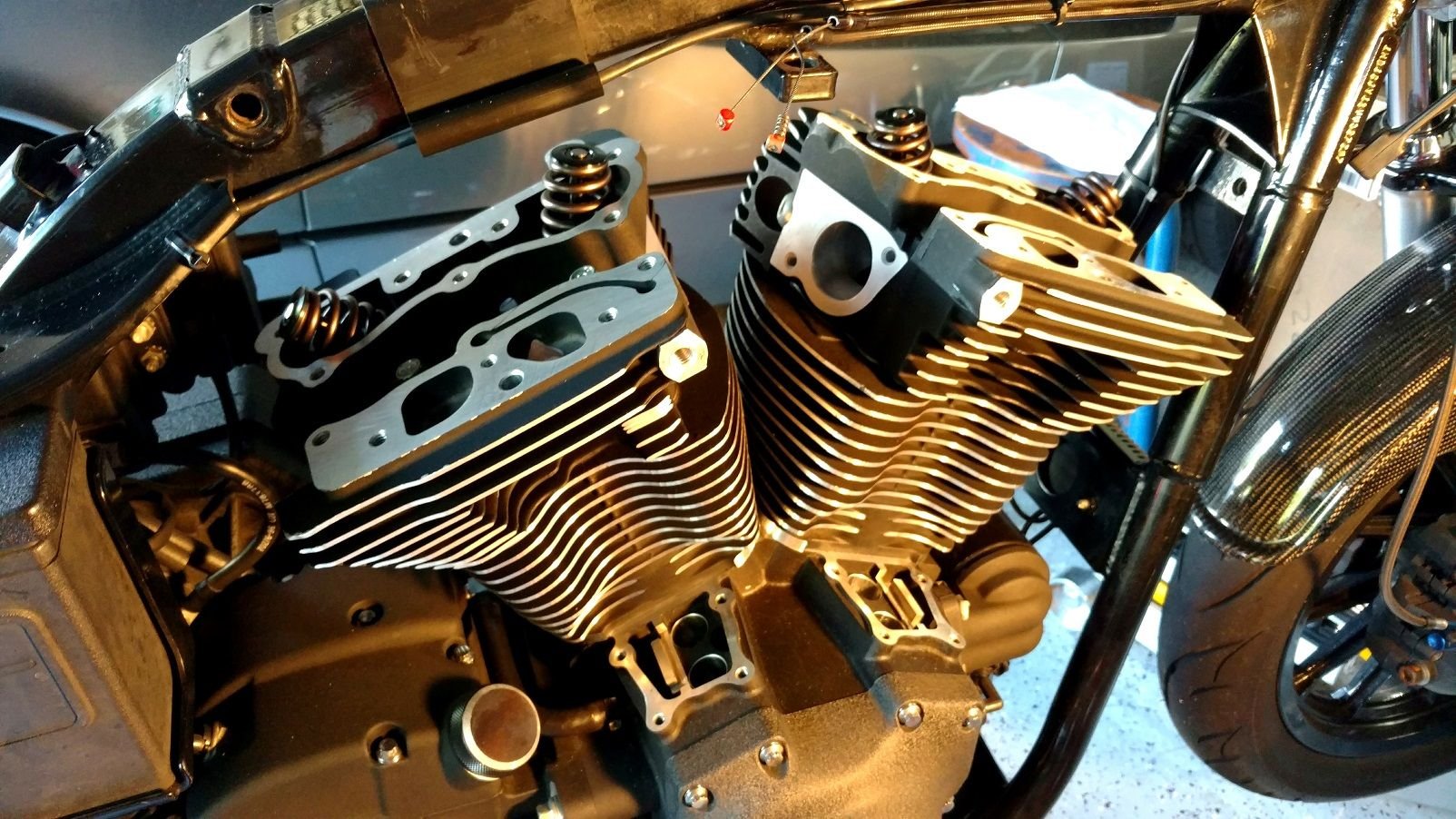

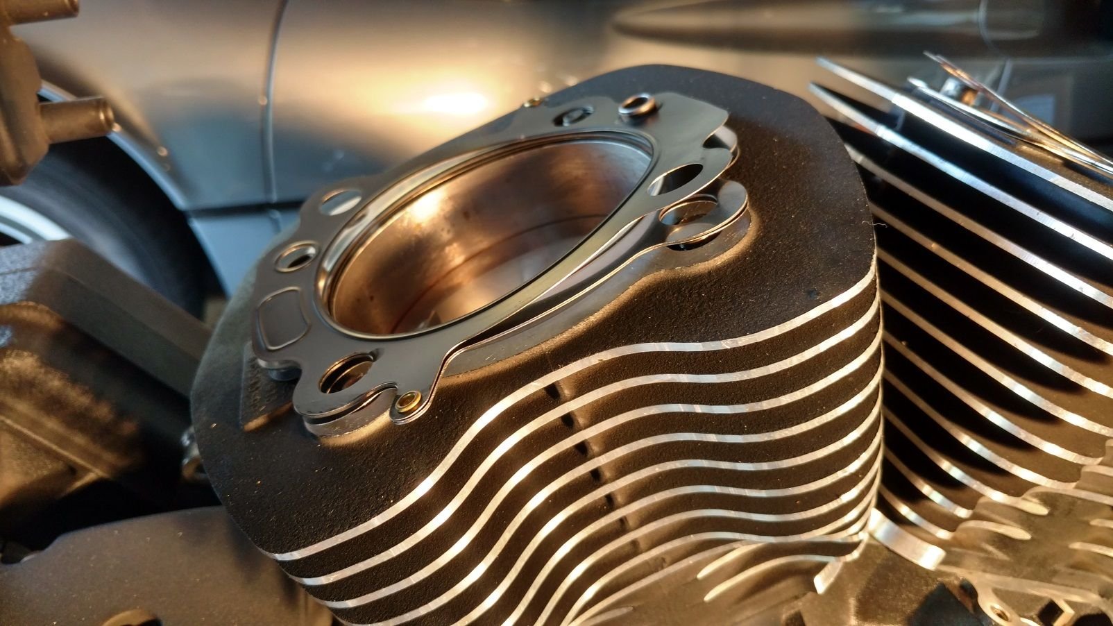

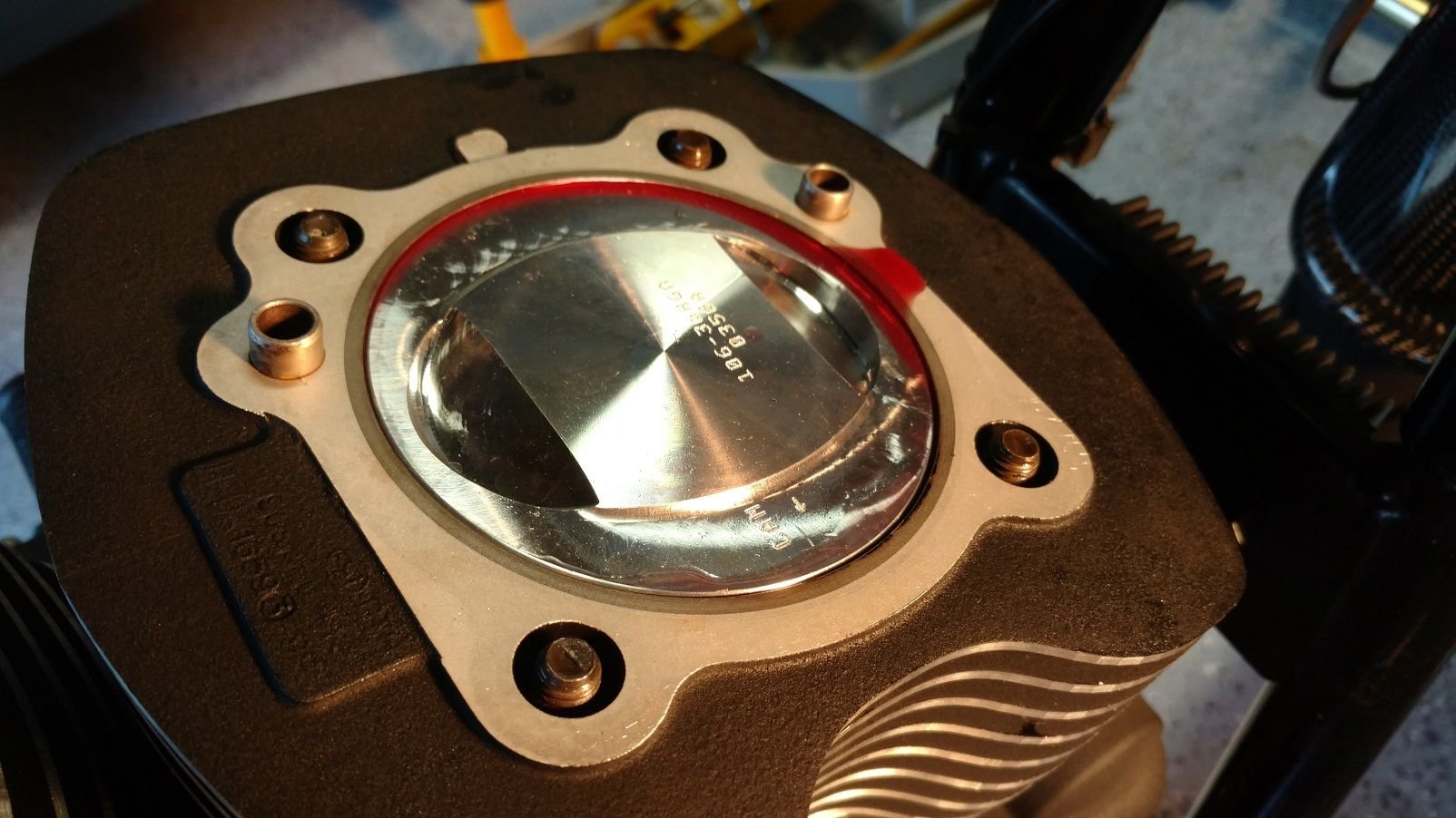

...and the slow progress continues...
Both heads are on (with the S&S MLS head gaskets), and are torqued as specified. I probably won't have time again until Sunday, at which point rockers, push rods, and valve adjustment should follow. I could probably finish on Sunday, except I know there are a handful of odds and ends that still need to be chosen and ordered.
