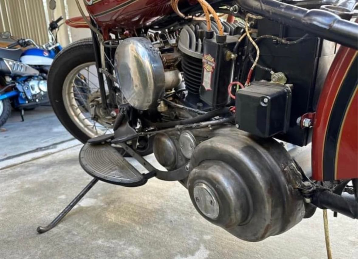

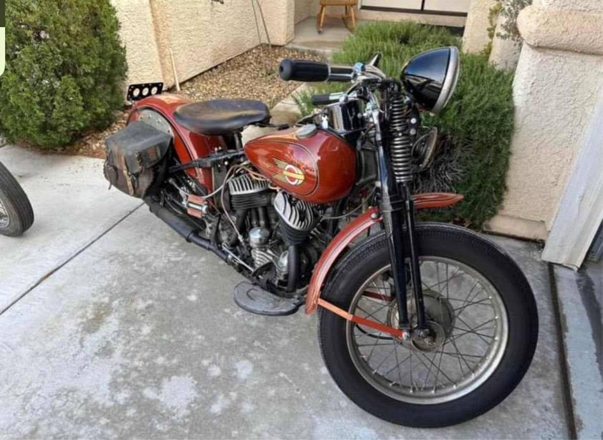

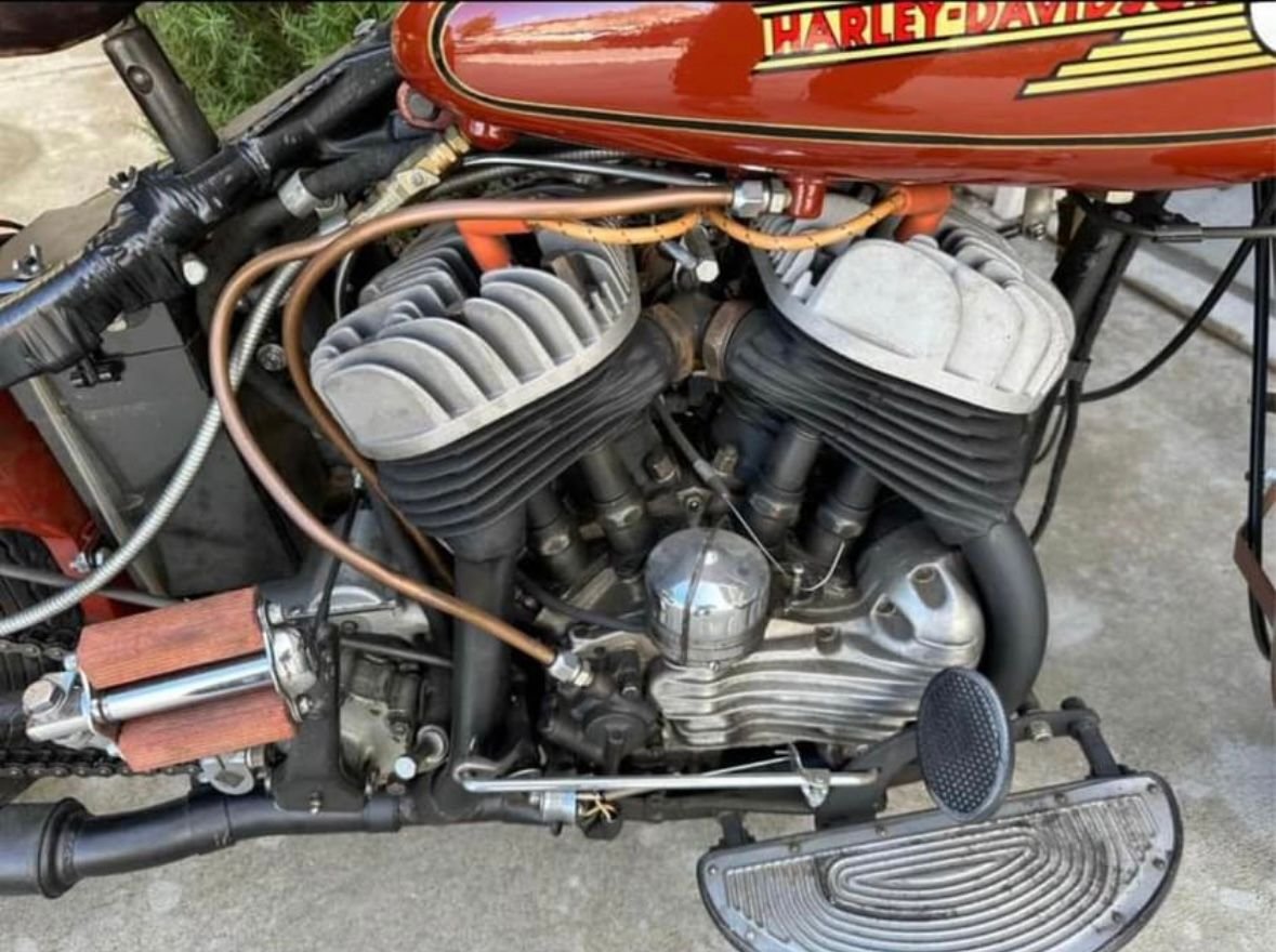

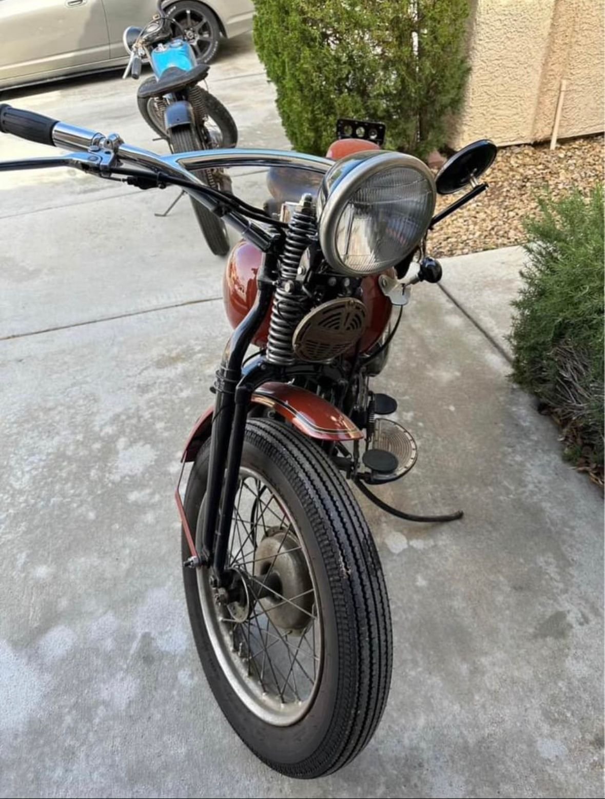

That’s for all your help. I was able to get more pictures and wanted to share. Let me know what you think!

it’s hard to read in this photo but it says DRF105713, and the seller tells me he bought it from someone in California. He couldn’t tell me anything about the person on who built it

Overstamp. You can see some of the old numbers. Speeding big twin can guide you on the number stamps. Gotta be careful with this.... particularly on a re-sale.

On the number boss there appears to be some extra marking but I can’t tell for certain what it is. I doubt the DMV would stamp a DRF number over an existing serial number but an extremely clear close-up may help us try to work out what’s going on. If some sort of ID was already on the number boss it is more likely that the DMV would stamp the DRF number to one side or the other of the boss and I have examples of it in my photo collection.

Lots and lots of reproduction parts, terrible VIN and mixed year parts.
Walk away, again much better bikes out there with HD VIN #'s for $15-18k, you do not need that mess. Good luck.

Offset springer is a "sometime in 1946" change so the bike has been messed with a lot.
