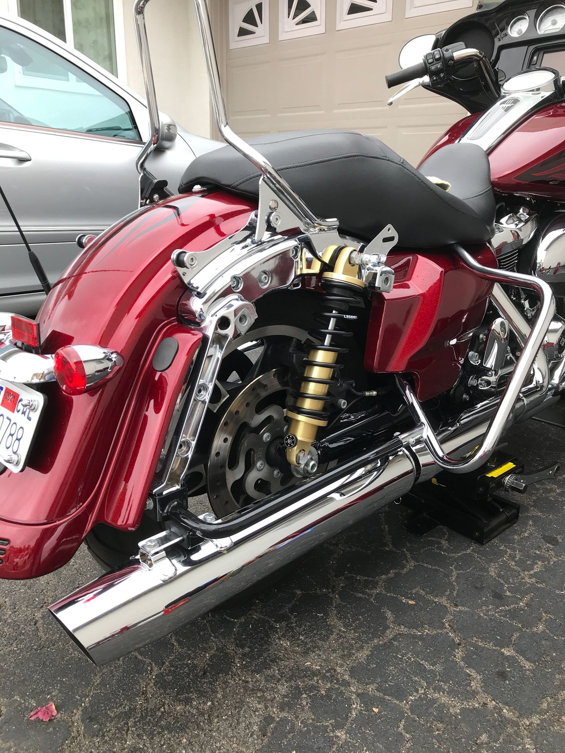

I installed the Legend revo a 13 wiith standard spring shocks on my 17 street glide and set the ride height to specs for my weight 190 pounds, Much better ride than the thirteen inch HD premium touring model shocks that I had bought to replace the stock useless 12s that came with the bike. Even at the lowest spring pre load setting they still road harsh . Much better ride now and much needed relief on my back now and they handle the twisties just fine. My biggest mistake is that I should have spent the extra money earlier on instead of buying those crappy factory shocks.
