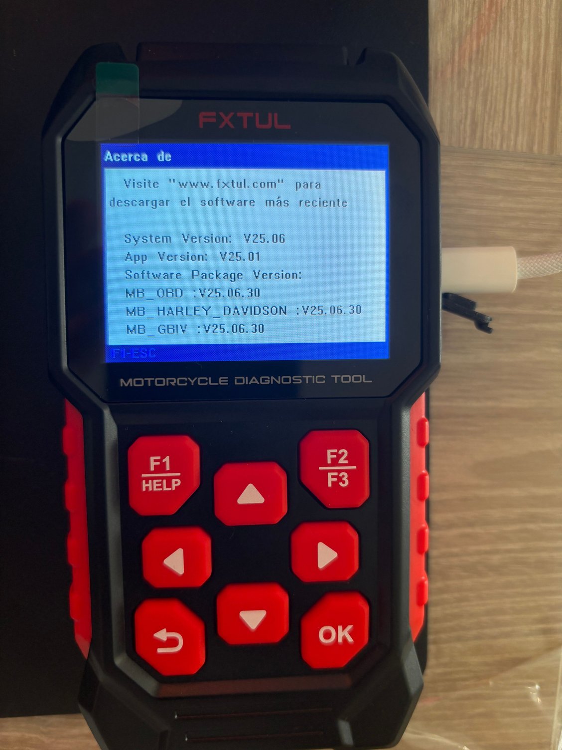

Hi, I have a Fat Boy 114, and I've always enjoyed doing maintenance at home. It just turned 4 years old, and I was surprised to find out that the ABS bleed process needs to be done every two years on the bike. I've looked for tools, but they are either expensive or, in the case of affordable solutions like ITM, they are not available in Europe because shipping costs too much.
The Chinese company FXTul has released a version that allows you to perform the ABS bleed without needing an internet connection, VIN binding, or anything like that. It looks very promising. I bought it and I'm waiting to try it out… I’ll let you know how it goes with my bike. Honestly though, I’m a bit nervous about using it since it scares me a little.
The update just came out and the company has responded to me via WhatsApp without any issues.
I don’t get anything out of this — no commission or anything — I’m just a user looking for a possible low-cost solution for ABS maintenance

So which did you buy, the M4 or M6?
I’ll be curious how it works for you. The description of the M4 is rather cryptic when it comes to cycling the ABS for bleeding. The M6 doesn’t seem to activate any of the ABS functions.

There are only 4 reviews for the M4. I looked at the reviews for the M4-HD and one said the ABS funtion isn't working yet. They also said updates are free, so hopefully they will have that update ready soon. Note that all reviews are 5 Star, even though at least some functionality didn't work. Check out the reviews for yourself.
Hopefully the OP will have better results

Yes, the last firmware released is 30th june. And today i saw the new video with this new feature.
I asked them with whatsapp, and share me the url video.
They dont update web yet, with detailing information...
Im updating my M4 to this version. But im scared to test it jjajaj
