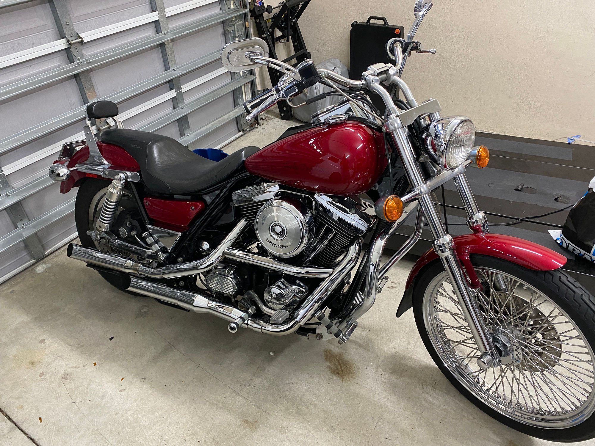

Day before yesterday, I stumbled across a post for a FXR2 in arresting red w/32k miles for 10.5k. Only issue is a dent on the tank. Not bad, but there. I wrote the seller and said nicely his price was way high, and I might be willing to pay 8k. He accepted. Then I started thinking about it and decided I was going to wait for a green flame FXR3. So I let him know. Apparently he was pretty desperate for money so he said he’d take less. Since I saw another ‘99 in red w/similar miles for 6k on Facebook marketplace, I offered him 6600 figuring I’d get rejected and countered, but he accepted
So yesterday, I took it home.
Now for the help: Surdyke said the service manual was available, but with a 6-8 week lead. So since I need to change fluids before I ride this, can anyone please tell me fluid capacities? I remember the oil drain procedure - a plugged hose under the left cover, but how much oil is used to fill the primary and transmission? And are the drain plugs obvious? Thanks!
Here she is:
Gotta find a Thunderstar. I hate spokes…

What kind of turn out mufflers are those? I had some Drag Spec. on a Yamaha 650 vertical twin, you could count the rpm by listening to the exhaust. The other two bikes are going to be jealous. Good looking FXR.

They’re SE slip ons. Not sure of the exact model.

What year is your "FXR" ??

1999 fxr2
