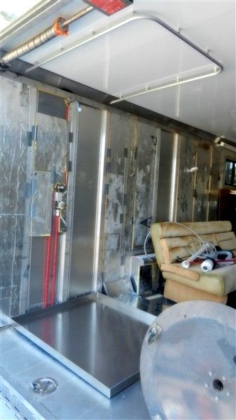

Here are a few things I thought up so if anyone wishes to add it to your trailer, please feel free to do so or not.
I made 4 (2 top & 2 bottom) flag pole holders that are internally supported to handle 2 20' flag poles. I made one set that are able to bolt on the left side rear or the front right side 16'-6" apart. The reason is so I can have them on the "front" no matter which side of the trailer, no matter which way I park, they are on one side sideways, or left and right when looking at the ramp.
I am working on my shower that the pan will fold up flat against the wall than have a screw in 9" drain that, once the deck hatch is unscrewed & removed, the drain funnel is exposed so that is 90º to a left side outside fitting, hose, into a portable gray water tank. The hinges are "camed" to raise the pan off the floor, thus exposing my I-track. The shower curtain track fits (ceiling) so the curtain is just inside of the pan.
The back-up camera is in, I have a total of three of them. I ran the camera feed to the tongue that is connected with a coiled wire to the rear of the truck.

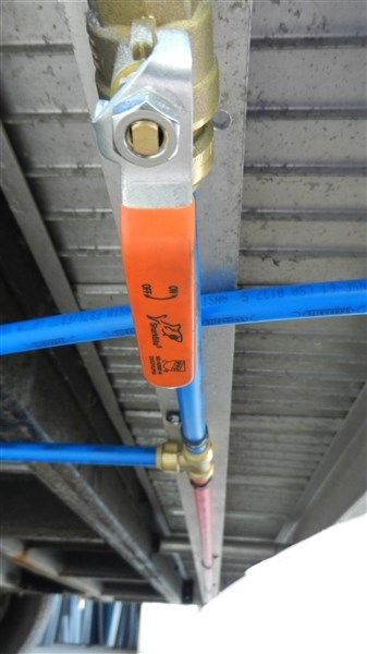

The quick disconnects are in for (from [two 30 Gal] tank > accumulator > to T as you see it through the propane instant on hot water heater > through volume control than through the diverter valve to either the shower head or to return back to the water tank.
After shutting off the shower side than your choice through the T to the other side of the trailer into a hose bib for an outdoor sink or wash down (for my drunk friends but never me).
My connections to go up into and out of the shower & return line.
I made a chain bar to lock up motorcycles when unattended that is steel and bolted to the frame in 3 places. It is angled just in case I should hit something and the trailer should raise up and over.
Going forward the return line, tank crossover, cold pressurized feed line, white fitting/blue fill line to fill by a city water tap, water pump and accumulator (removes pulsation).
And lastly for this post, I wanted a flat floor so I bolted 1/2" plates & tapped them for 1/2" SS Alan bolts so I could remove my 5) motorcycle wheel chalks.
END

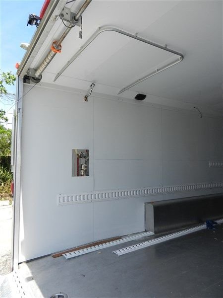

4.17.15 Update
Got most of the aluminum sheeting and soffeting in. Notice the T-5 bulbs on the soffet as wel as the speakers. I am running 3 tows of E-Track that I white powdercoated. The bottom one is 5" off the floor allowing for 4" polished SS baseboard to be adhered to the walls on both sides. Vents are installed on both sides as well as the spare tire mount. I am enclosing the rear ramp spring. The LED hockey puck emergency lights will be screwed in next week.
Shower internal plumbing tested. Finishing up the sewer & drain next for the removable/fold-able against the wall shower pan next week with hatch to gain access to the sewer plumbing.
