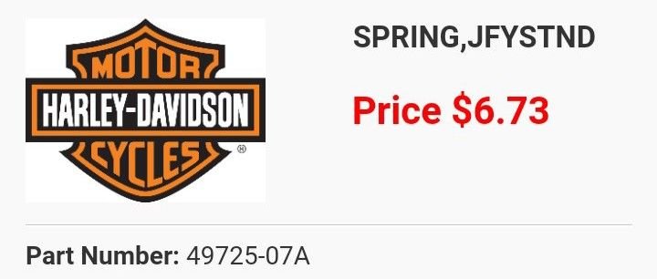

Bottom of my bike hit my driveway ramp just right and took off the jiffy stand spring. I was able to put it in the down position and park it.
Amazon had a replacement for $18.
My bike was in the list of bikes it was made for on the amazon item page.
The spring they sent falls out immediately. I went back and looked at reviews and there were at least a dozen or so like me that had the same experience.
I'm grabbing an OEM one this afternoon. I may grab two and keep a spare in my took kit. I'm looking at the stand as well as the bracket that attaches to the frame and it is pretty beefy, doesn't look like anything was damaged other than the spring when it got torn off.

I have had that experience, not sure why but the jiffy stand spring is 100% an item you want to find OEM when needed. Aftermarket always sucks with them. Good luck.

Even if you grab two, you're still under Amazon's price.
