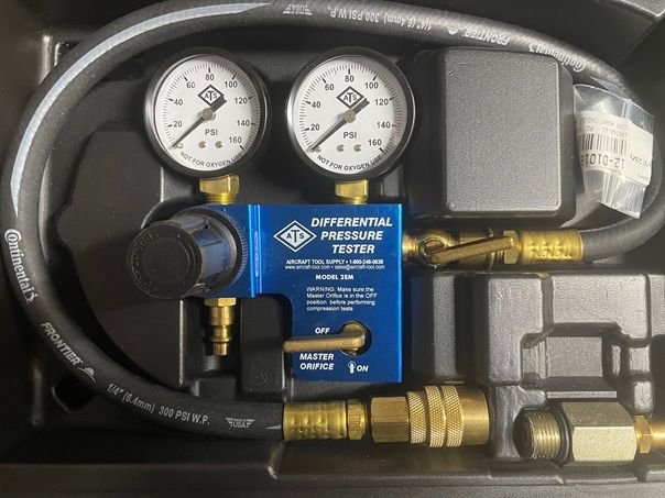

You absolutely do not need a leakdown tester, a compression tester is all you really need.
If you get a low compression reading, just use the junk leakdown tester to put 80psi into the cylinder and listen for where the air is escaping.
Forget about the percentage, it is an old archaic way of testing compression in aircraft engines that was never a great method to begin with.
Anyway, here`s a pic of the one I have, from Aircraft Tool Supply:
