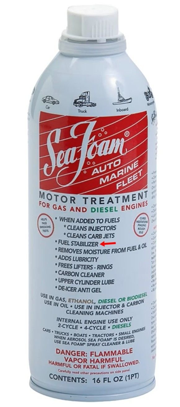

Anyone with seasonal engines knows to change oil prior to storage. Most O&M Manuals state so.
Full gas tank with Stabil (recent testing showed Stabil #1 for storage - SeaFoam is not a stabilizer, it is a cleaner).
Battery MAINTAINER on battery - NOT a dumb trickle charger (they will dry out the battery).

Originally Posted by barneyboy
They may advertise it, but it's not. I'm not going to look up the test article on it. You can.
