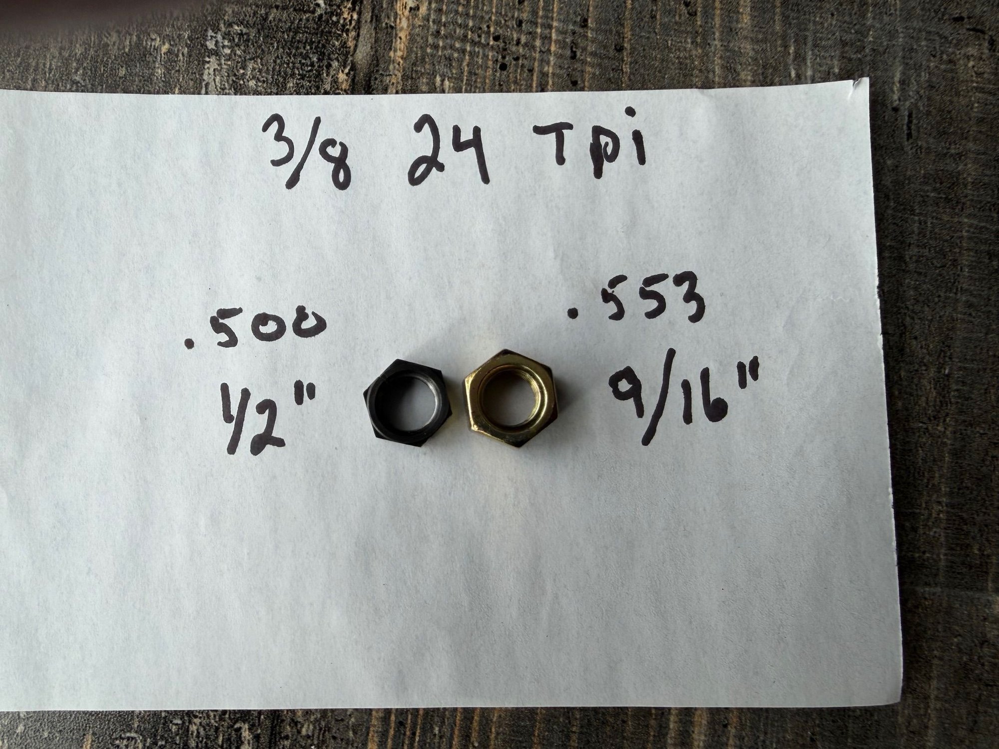

Ok, I bought a hardened 3/8" 24 tpi nut, it takes a 9/16 wrench, the original is a 3/8" tpi that takes a 1/2 wrench. As somebody already mentioned, I'm concerned that the slightly wider nut, .553 vs .500 OD, will rub on the inside of the pushrod tube. anybody ever try it?
I also bought a hardened 5/16 24 tpi nut that I figured I would drill out to 21/64 and then tap it. Actually I bought 3 in case I buggered one up. So I went through 3 drill bits, It's like the nut was too hard for the bits. I used my drill press, but even though I had the nut in the drill press vice, I had to apply so much pressure that the nut would tilt. I went through all 3 trying to drill a centered hole. I took the best one and tried to tap it. Tap broke. So I'm screwed at the moment. The dealer does not sell the jam nut separately. A new set of push rods is $411 plus tax Cdn.
After I post this, I'm going to try to find something online. Anyone have any suggestions?
EDIT: It would be a lot easier to drill out a standard 5/16 nut and tap it, because it would be softer but I assumed Harley uses a hardened nut for a reason.

After searching the Internet, I see lots of guys are just using the standard hardened 3/8 nut, 9/16 across the flats as opposed to half inch. I also see a lot of talk of people using grade 5, 5/16 nuts, drilling them out and tapping them to 3/8 spine thread.
Not crazy about using a softer material or a wider, thicker heavier, nut
