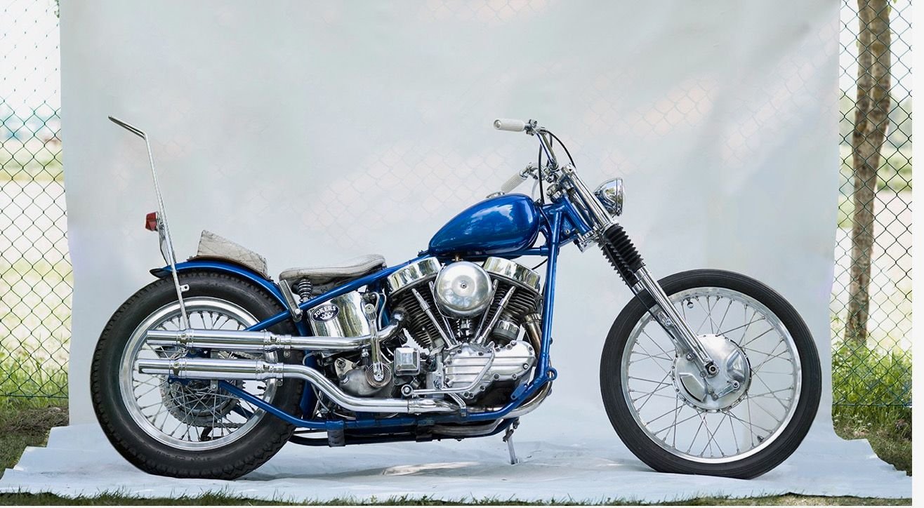

Now, on these old bikes, one can utilize the OEM sidecar mounts (see pic), making fitment a snap. Well, I won't use the rear because it's out of line with the tires; just the front mounts to hold a custom center pivot. But there's a space on the aft end of a plate that used to mount the steel yoke for the rear passenger pegs just behind the tranny--and it's just a touch lower than the front sidecar mounts. So, that oughta be okay if it doesn't interfere with the shotgun pipes...

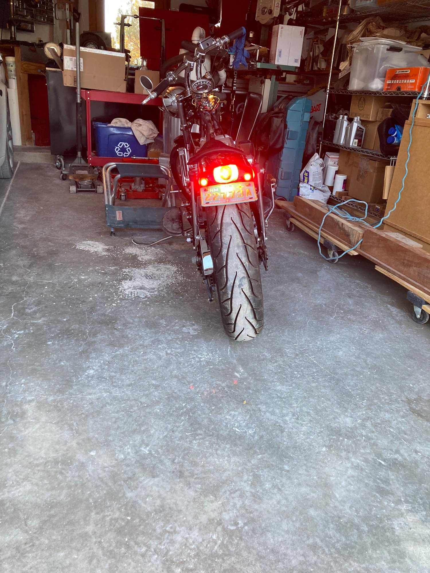

Essentially, I want to build an ultra light 'flat bed' with low sides to retain cargo, but perhaps with a small fairing made from aluminum panels, primarily to reduce drag but also to look cool. I will add a few of the unobtrusive round LED brake lights I found--extremely low draw and bright light in a compact housing that fit under my bobbed fender beside the existing fixture (see attached pic, which doesn't do them justice: they are bright). Evidently, you can use resistor leads or something to use them dual-intensity as running and brake lights. I've got one of those Cycle Electric generators, so no problem powering a couple of extra bulbs.

You know, with these attachment points on both sides at the rear of the frame (1st pic), a single-wheel aluminum trailer with a uni-shock would work, too. Less wind resistance, as it'd be essentially drafting the bike and wouldn't increase the frontal area like a sidecar would--though what I have in mind is very low profile.
The other advantage of a single-wheel trailer is that it's easier to dodge semi retreads and other refuse on the highway...
However, I think an ultra-light cargo sidecar is more unique, and it doesn't need to be separately registered like a trailer. Also, the mounts I have in mind would be very easy to release. Also, it's easy to allow clearance for the side stand or I can make a rod on a pivot that swings up and supports the bike at rest. Finally, the sidecar can haul more bulky stuff than an inline trailer (and I don't want a dual wheel trailer) and I can find parking more easily with a short squarish package. Oh: and I suppose I could add a driving light, too...
I was looking at the left-hand side and, indeed, it looks like a properly configured arm could extend behind the sprocket between the upper and lower runs of the final drive chain. I really like the side-by-side shotguns with vintage Sporty mufflers (see 2nd pic), so am leaning toward the sidecar option (couldn't resist the pun...). My original toolbox mount is perfect to attach a custom mount that will grab both mufflers right where they clamp onto the pipes...
