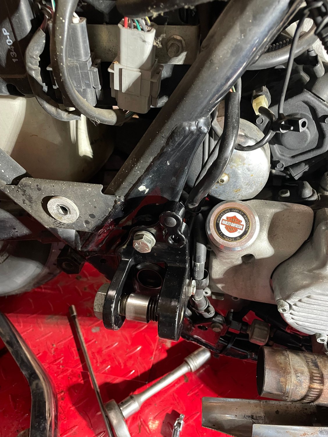

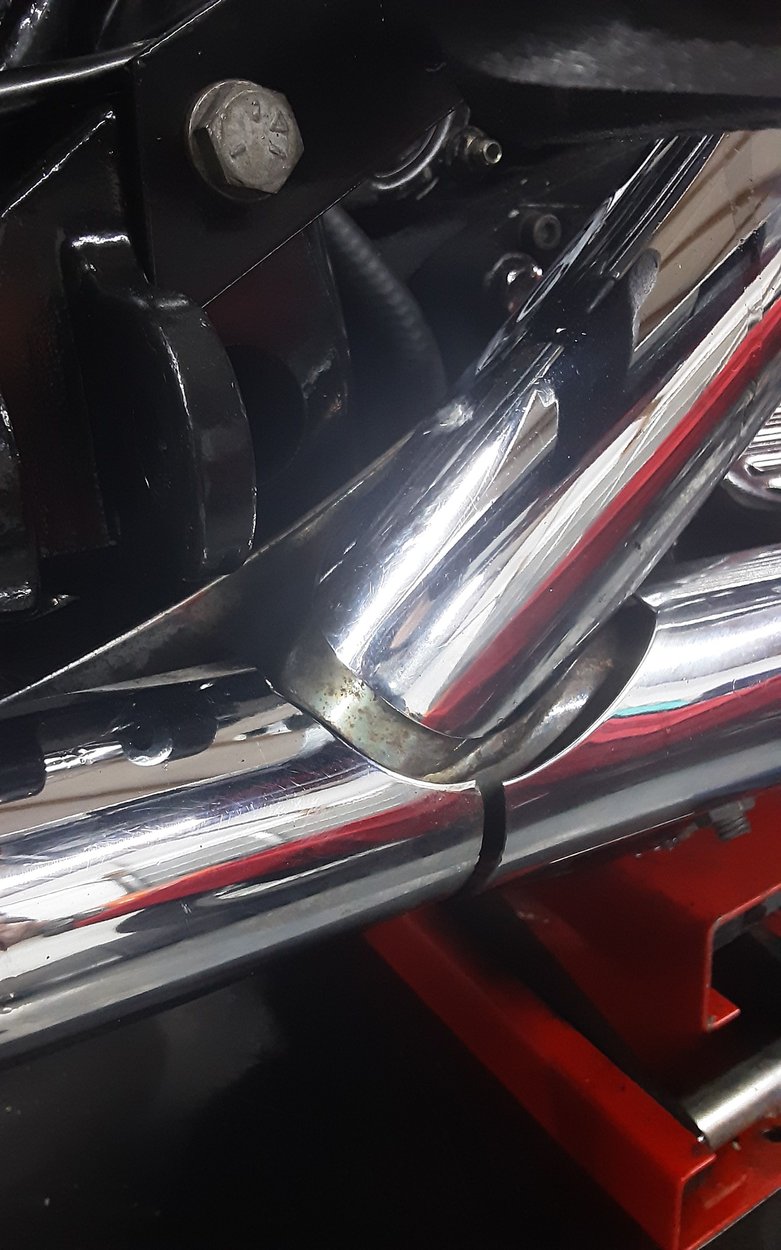

I've decided to "hack" my 97 cop bike (basically stock) with an older HD sidecar. I'm in the process of adding all the brackets to the bike. The problem I've run into is with the rear bracket 87114-93A. It replaces the right passenger footboard mount. This replacement went smoothly, but when trying to re-mount the rear head pipe, I see the triangular brace welded to back of the pipe seems to interfere with the new bracket 87114-93A. Honestly it doesn't even look close to fitting.
Does anyone have experience mounting this bracket?

It's been a challenge gathering all the OEM parts to do this properly on the 97, and I'm still questioning why the rear bracket 87114-93A interferes with the exhaust. There is an older bracket, 87114-93 (no A) that my 97 parts book references but the newer part superceded it, and is referenced in harleys 97-98 attachment instructions document J00609. dated 2005-04-07.
Here is the bracket 87114-93A mounted:
And here is with the header pipe driven on to its stop. As I twist the pipe upright, the triangular bracket welded to the back of the pipe wants to occupy the same space:

After studying the exhaust and the sidecar bracket history, I'm of the opinion that Harley documentation found on the web regarding 87114-93A is wrong regarding fit. My understanding is that when a part is superseded (as 87114-93A did to 87114-93), the newer part is capable of replacing the earlier part in all cases. I think Harley didn't do all the homework and messed this one up.
I'm thinking 87114-93A will not work on 95-97 bikes, and I need 87114-93...

Another note to add here, after talking to a gentleman in Texas last night, he mentioned that my rear mount bracket looked like what was on his 02. Sure enough, i plug in 87114-02 and i find another HD document that shows a picture of my bracket as 87114-02, rather than the conflicting 87114-93A.
The -02 is more believable since I know it won't fit my 97. Guess I need to head to the dealer and ask the parts guys some questions...

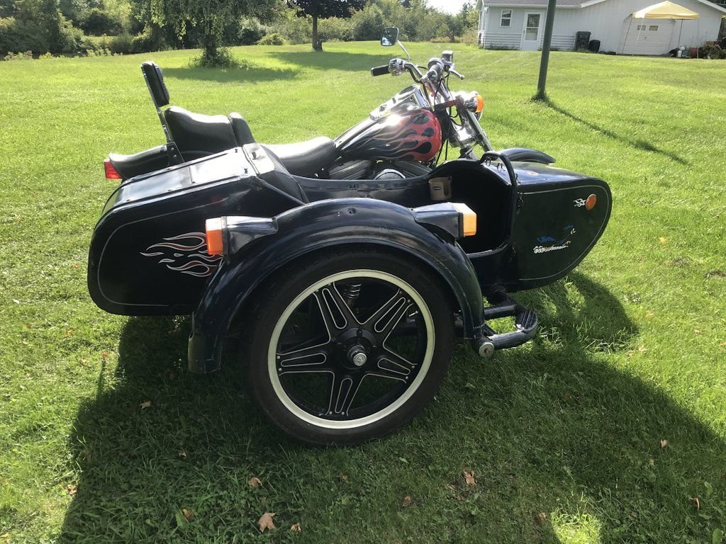

^^^ 1986 FXWG..6 degree tree's, damper was just for one handed or No Handed at low speed.. Using Stock Russian Mounting "*****"... I love it.. perfectly balanced, and the Hack Wheel at as close to 9" of Lead, as I can get it...
Final selling Point...My Monkey can get in and Out, almost as easily as the Hannigan which has a door..

That is not the correct bracket for a OEM sidecar. Go to Ronnie's Harley Davidson microfiche. I'll try to load photos of my 89 Flhtcu.
Old Jan 19, 2026 | 03:25 PM
amfhd's Avatar
amfhd
Joined: Feb 2008
Posts: 139
Likes: 38
From:
Your bracket appears to be 87114-09
BRACKET, REAR CONNECTION
I think the one you want is
87126-07*
BRACKET ASSEMBLY, REAR*
