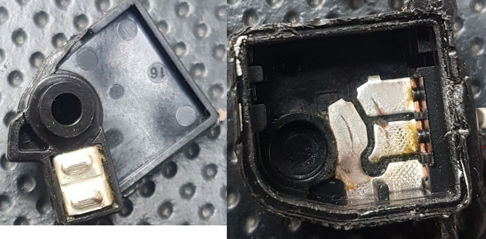

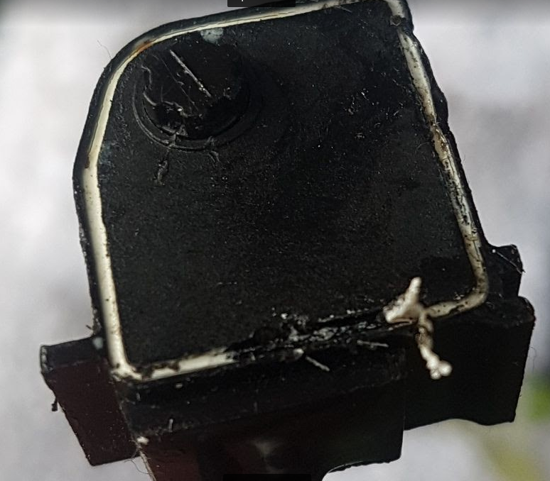

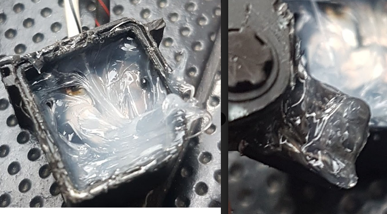

1. Take Start button housing apart & bend retaining clip back so the 'start' push button is out of the metal bracket that holds it to the button housing (no ~not~ cut the wires). Remove the switch rocker cover with a flathead screwdriver. (photo below is after I messed with the switch a little).
2. Using a small pick or flathead screwdriver, scrape away the white material from the outside of the switch.

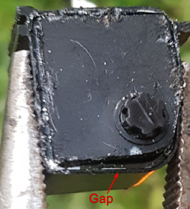

3. Squeeze the top of the switch with pliers so a small gap appears near the rotating *** & use the pick/screwdriver to pry the top off.
4. Use rag to clean away all grease and water. Make it ~shine~
5. Glob Dielectric grease all over the inside of the switch. Rotate the **** to ensure that you get grease on the backside of the spring loaded contact plate.

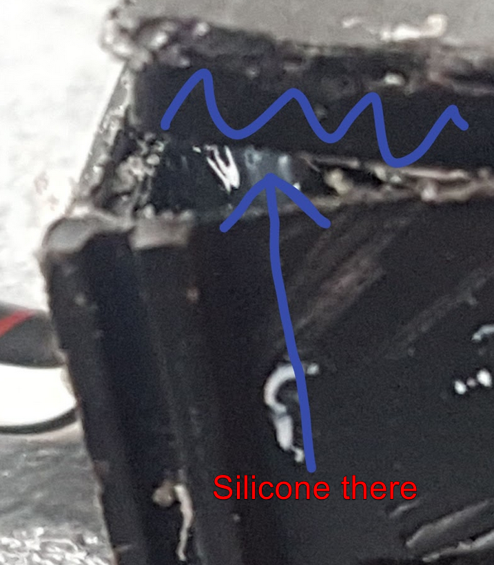

6. Scrape away any plastic bits you gouged into when opening this switch & reseal with silicon dabbed on the side of the switch plate before pushing into the housing.

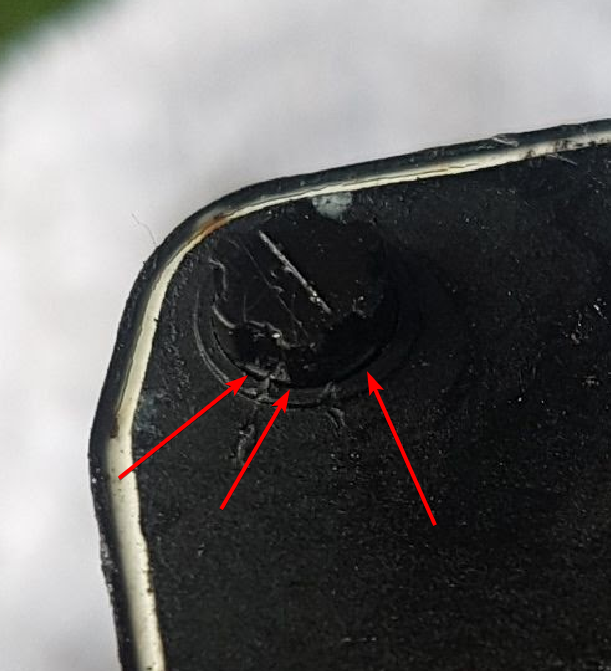

7. Also apply silicone or dielectric grease to the bottom of the housing of the switch where the wires enter the housing. Mine had a visible gap that could let water into the switch. The most likely place water entered the switch is the gap between the housing of the switch and the rotating ****. Make sure to glob dielectric grease on this ****. These two locations are also simple places to put dielectric grease on the 'run' switch while you're here. The dielectric grease won't hurt anything, so put a nice glob on it,then wipe away the grease that oozes out after the switch cover is put back on. Let the silicone dry, then reinstall the switch.
This method is simple, quick (you don't have to open front fairing & reinstall wiring), and cost effective. The additional grease near the rotating **** makes the switch less likely than replacing with a new part that has the same vulnerability.

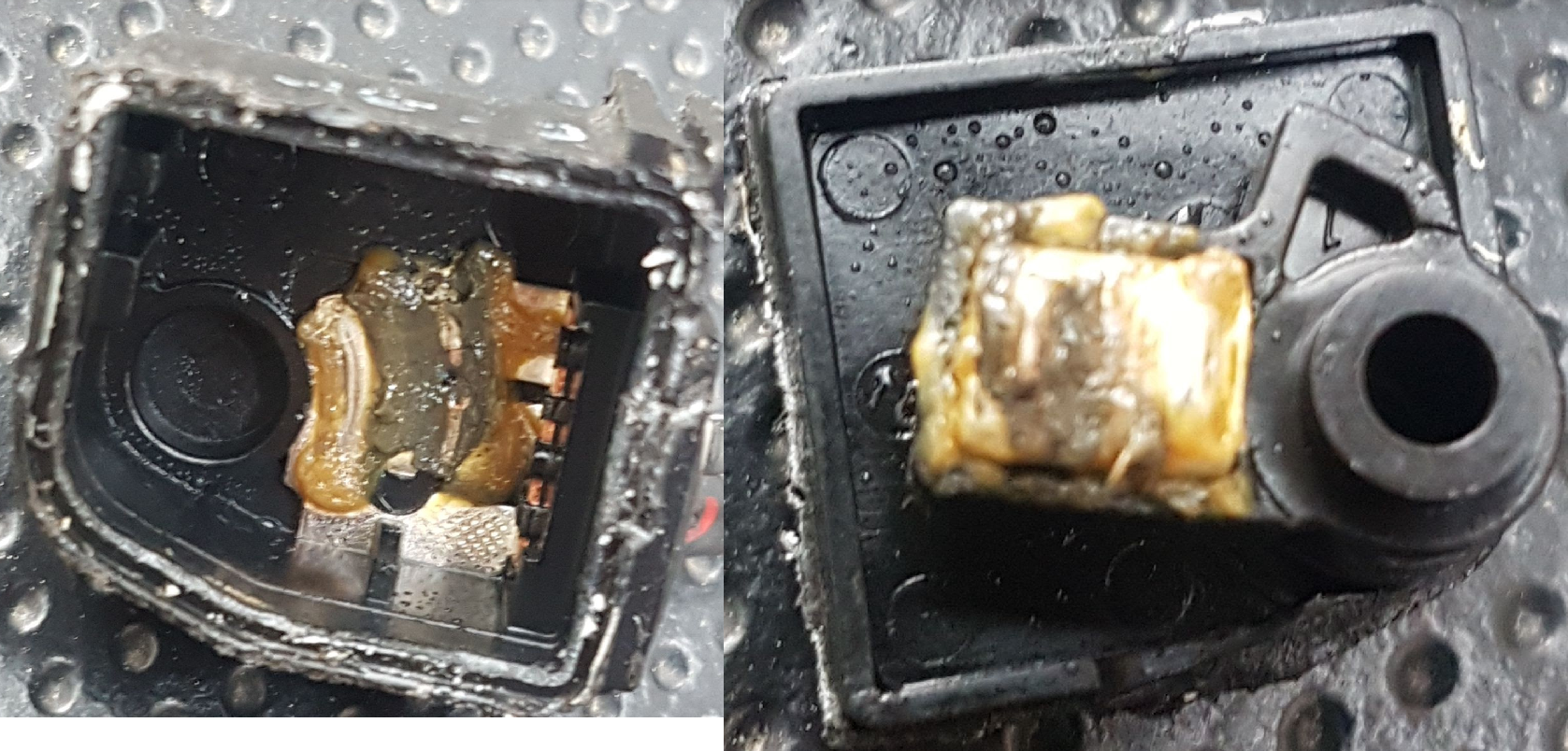

I thought this picture was in the original post, but it wasn't. This is what the inside of the switch looked like originally, showing the small dab of grease in there originally, as well as the water that was found in it.
