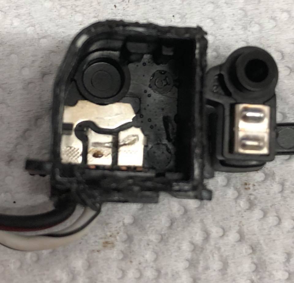

I have had several bikes come into the shop with the problem of the starter trying to engage while riding and the bike starting without pushing the start switch. The solution, most of the time, is a bad start switch. Well after the last one came in, I decided to try and open up the switch to maybe see what was going on inside. Nothing stood out as to a problem other them maybe the spring had relaxed enough to let the switch rotate a tad to make up the circuit from time to time. As for moisture being the culprit, the switch is seal very well so condensation could be a factor. No sign of any contact grease in the switch. The small brown spot on the left piece appears to be an electrical arc spot.
In the attached photo, the part on the right is what rotates with the switch press. Its' contacts are spring loaded.
Remove from 2013 RK

This just happened to me today! I squirted some contact cleaner up inside, then a little WD-40 so the switch would rock easier an all was well.
