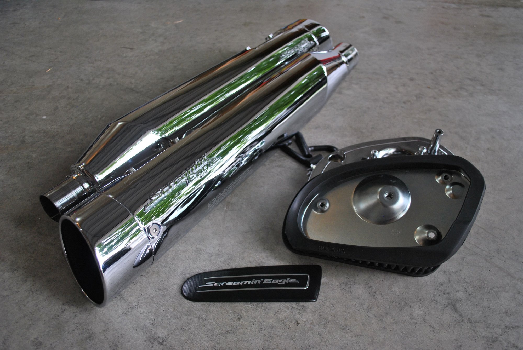

1. Stage 1 - Screamin Eagle Air Cleaner and Street Cannons tuned with Power Vision
Got a good deal with these used Screamin Eagle parts. I went this route to have that OEM look plus the sync functionality of HD parts. I installed the Street Cannons first and ran for 100 miles without any issues. Acceleration was still responsive and no decel pops. I did the same method with the air cleaner and it felt the stock tune was sufficient with these mods. I was hesitant to use the Power Vision at first but at the end, I flashed Fuel Moto's custom tune. I love the exhaust and intake tone. Mellow but will bark once you open the throttle.
Great pull across the powerband and did not notice any flat spots. I will continue to play with auto tune based on my riding style and environment. The more I play with Power Vision's auto tune the acceleration and sound keeps improving. I am now on my 10th itiration of auto tune, riding in variety of 20-30 mins on country roads, highways, and street traffic to mimic daily use.

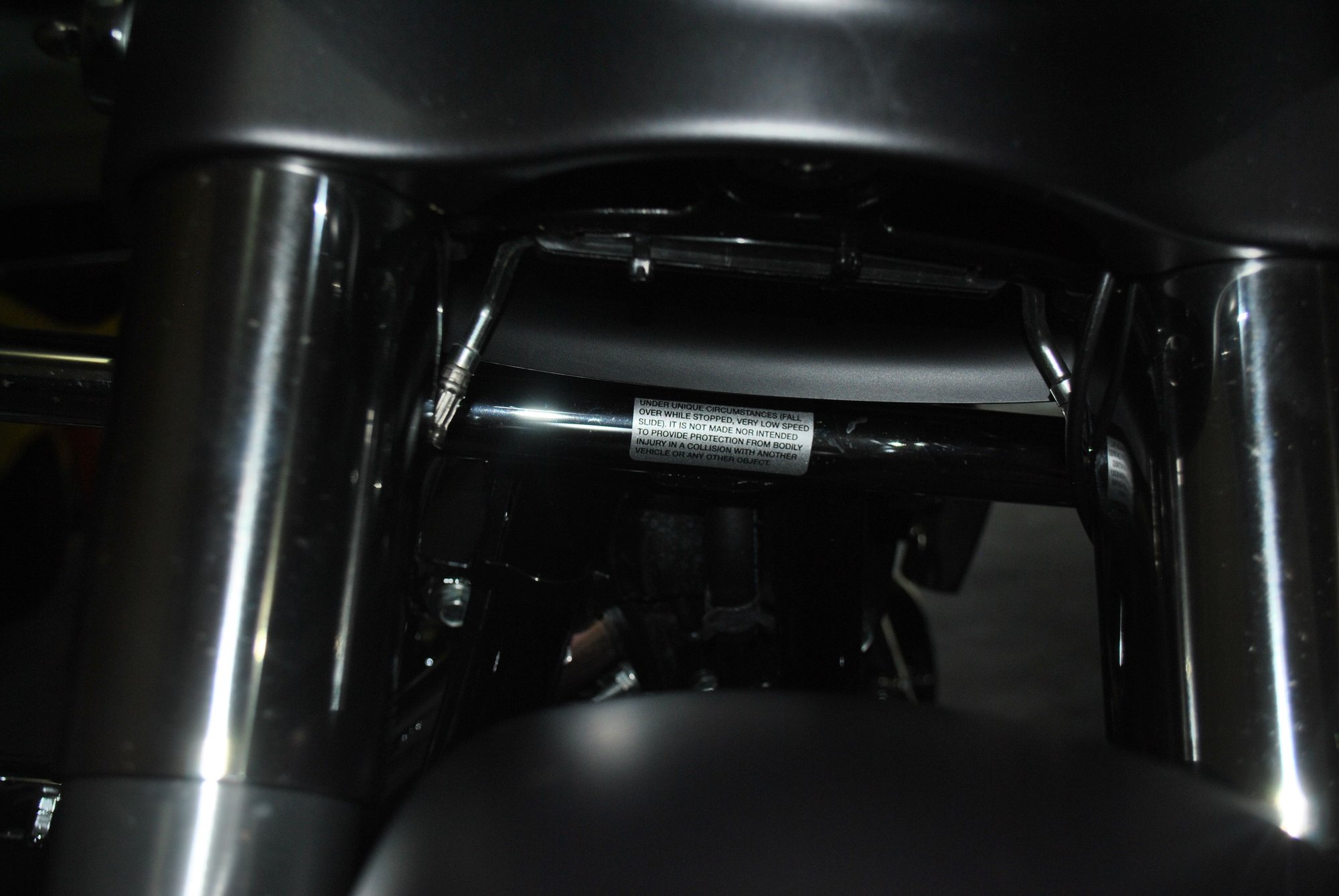

6. Wind Deflectors - Kuryakyn's Wind Deflector (KWD), DK Custom's Cooling Wind Deflector (CWD), and ebay's Mid-Frame Deflectors (MFD).
The KWD focuses on the air that passes through the lower triple tree/forks and front fender. The CWD minimizes the wind over and sides of the tank and directs air downward to the engine. Both helps controlling the air flow to the chest/face and cools the engine too.
I will give more report on these inexpensive add-ons. Hoping to reduce the air buffeting during interstate rides. Let us see if these items lowers the engine temperatures also.
KWD
CWD
