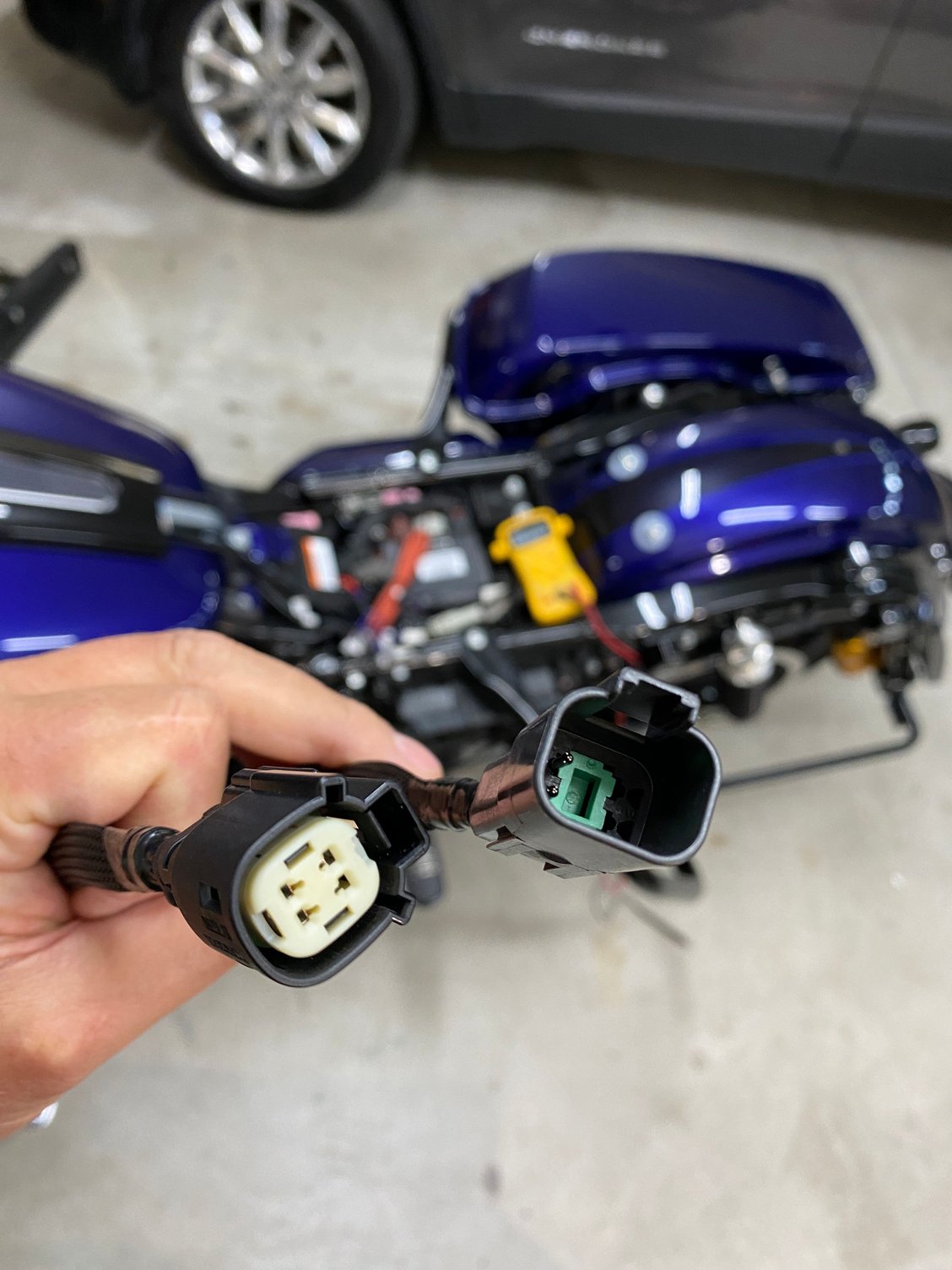

Well, another example of me not thinking something through before making a post. Looking at the diagrams, I see the 4 wires in the left accessory connector are 1 ground, 1 hot, and 2 that run up to the dash switch connector. So with my handy multimeter I found the two wires did indeed provide power controlled by the dash switch. So I hacked together an adapter that gave me the switched power I needed without having to use the overly complicated (for my simple need) harness that came with the switch.
So just FYI. On the 4 way accessory power connector under the left side panel, light blue/yellow is controlled by switch 1, light blue/white is switch 2. If you don’t need more then 2 amps, you don’t need the switch harness.
