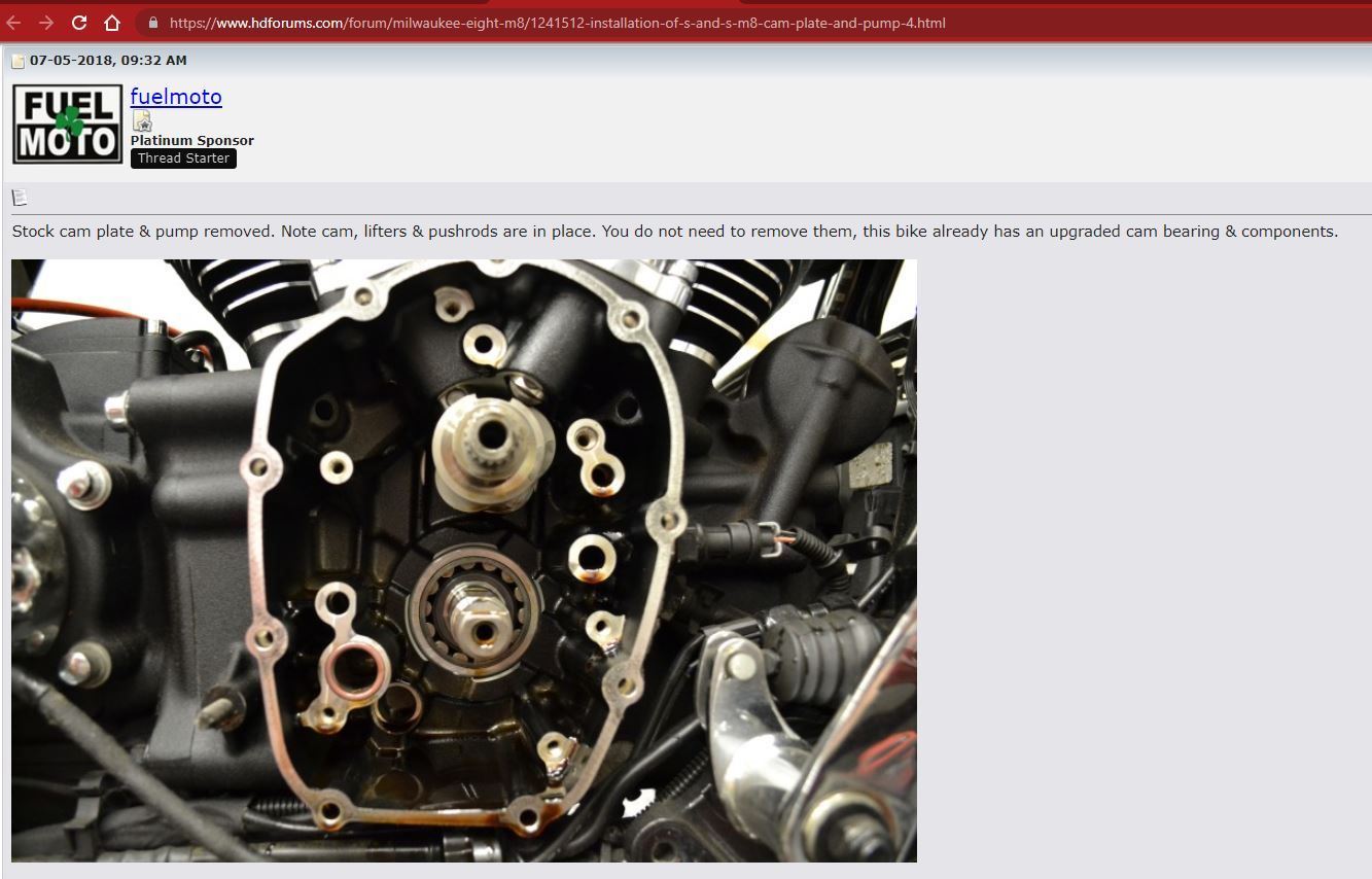

Default F&M Oil Pump Swap
Originally Posted by dontdropit
Seems like I saw a picture once posted by fuel moto where they changed an oil pump without removing the cam or push rods, but probably isn't recommended for the average do it yourselfer.
I believe This is the one?
That's interesting but I'm curious how they handle centering the camplate and oil pump while they're so much pressure on the cam? With everything pushing down it seems that you'd create a hotspot on the top side of the camplate, not allowing it to center on the shaft's runout range.
My bike has SE Adjustable pushrods, and I have magnetic lifter holders so it'll be easier to let everything center on the pinion shaft.
not to mention the stress on that cam bearing.
