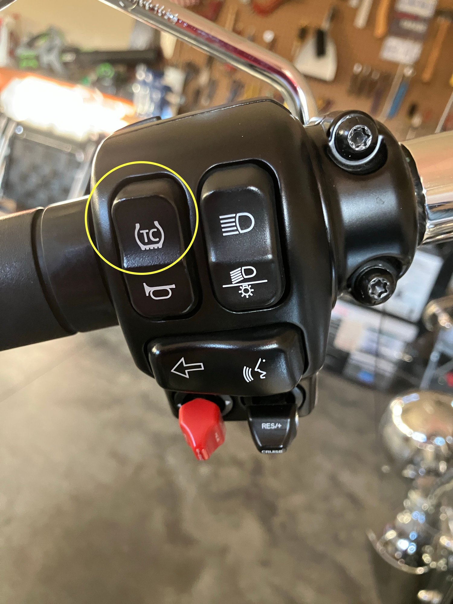

I was wondering if it just a process to turn on the Harley TPMS in the ECM/BCM on my 2019 FLHTP. I do not have, nor desire a radio for my bike. But the TPMS icon is present on the dash.
