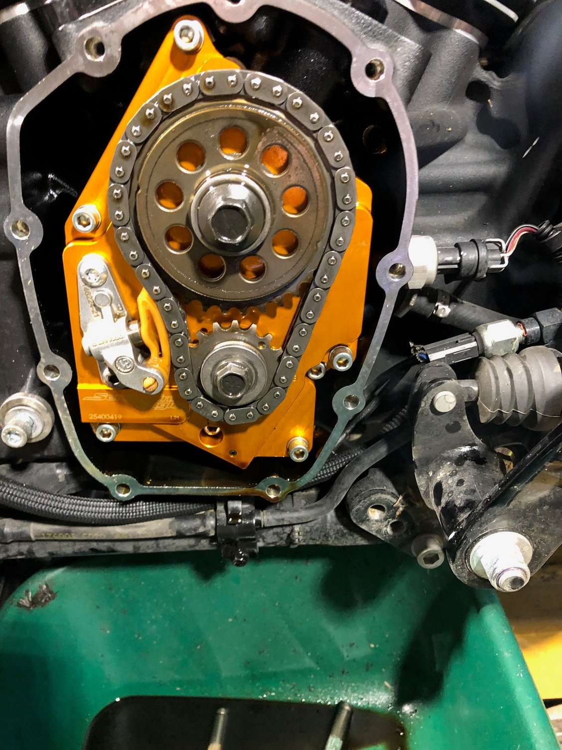

Here's a pic of the crank dot @ front tdc. Even tho it's an M8 it's same for tc.

The dot on the crank gear lines up with the crank pin.. On TCs all you had to line the dots up for TDC compression on the rear cylinder then rotate forward past the front and one more turn so the dot lined up with the front cam to do the front. M8s are different because there is only one cam. With the dots lined up, the cylinder is 22.5 degrees past TDC on the power stroke rear cylinder. +- 22.5 degrees is fine for adjusting the valves.. It can be more.. Everyone has their magic feather/straw to get it right..
