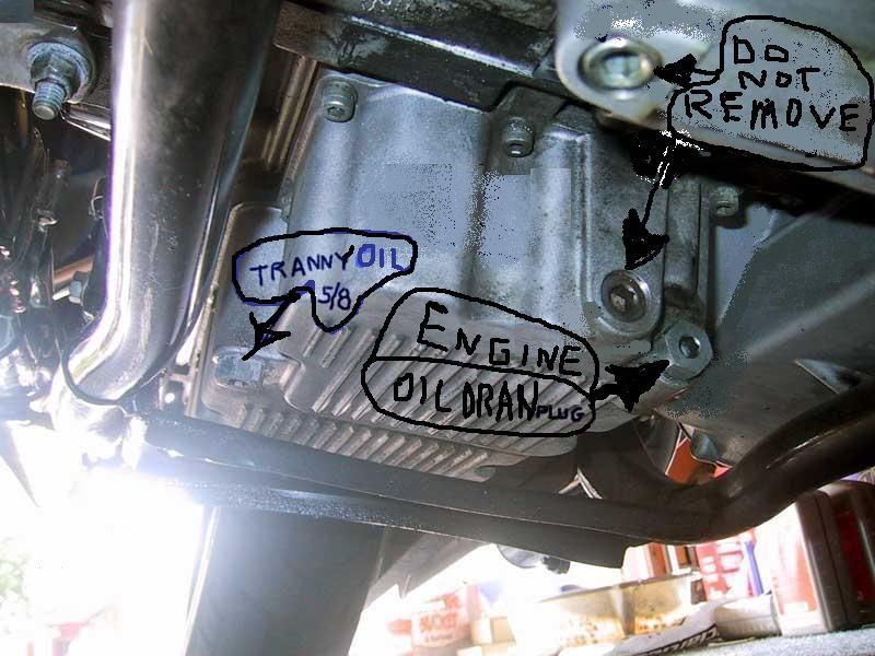

Does it look like this under there?
Oil drain plug no doesn't look like that as far as l can see on ground... is that the front left or right side of bike sitting on seat?
