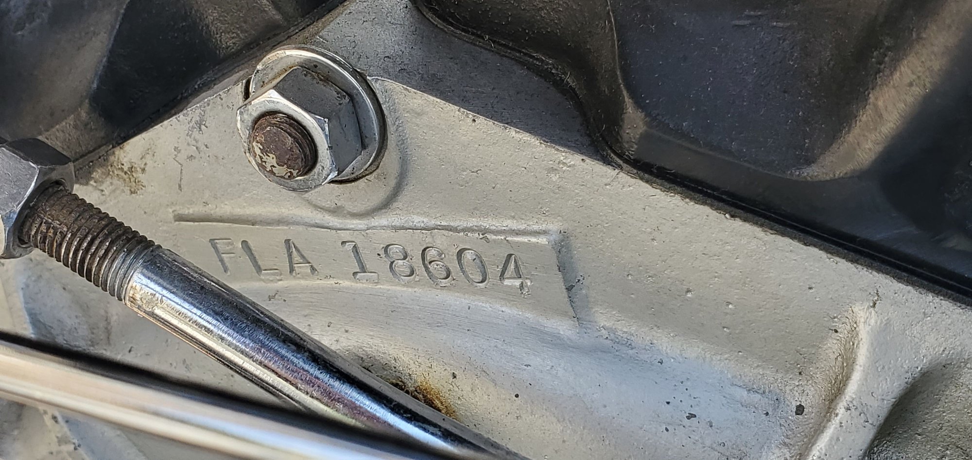

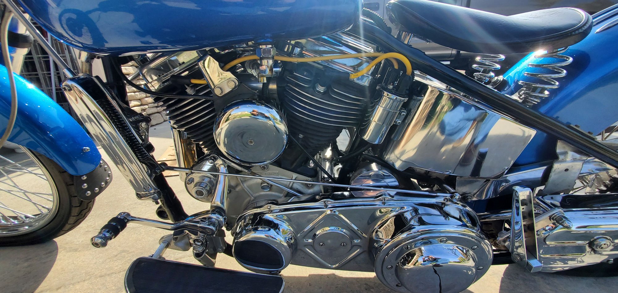

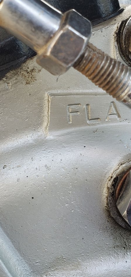

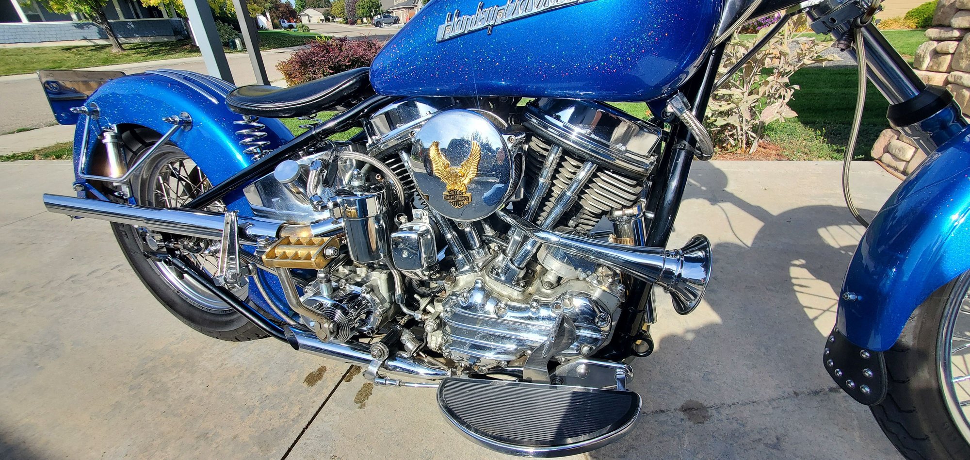

Any ideas? I bought the bike because I like the looks, and I understand it's a Frankenstein. I did a search and can't find anywhere that addresses this VIN format. I know it should have a year in front of the FLA, but it doesn't and I can't figure that out. The PO says it is a 1952, but the trumpet horn tells me 1954. Any thoughts?

it could be a Florida DMV appointed vin number,..... someone here from Florida can probably shed some light on it,.. but thats my guess, it IS NOT, a factory number....

The vin pad has been filed down and a new number stamped in its place. The sharp edges around the pad are the giveaway as that pad should be just cast then stamped.
The belly numbers will tell you the year, might have 152-xxxx. X being the sequence number and both halves will (should) have matching numbers.

Welcome to the forum. I agree with Pete in that it could be a Florida number and I’ve seen a few other engines stamped with that format. What does the paperwork say? And try contacting Florida DMV.
Why did the PO say 1952? There were at least two left cases for 52. Yours isn’t an early-52 case but it doesn’t seem to look like a later-52 version either. At this stage I’ll guess the left case may be 55 or later? Can you post a photo of the belly number please. Thanks.
As for the R-H case it appears to be somewhere from about mid-52 to 62 inclusive. I can’t see a strap around the generator but that doesn’t mean much. If there is provision for a strap then the R-H case may be somewhere from about mid-52 to 57 inclusive, if the case is H-D. If no provision for a strap the case may be somewhere from 58 to 62 inclusive. A photo of the belly number may tell us more.
