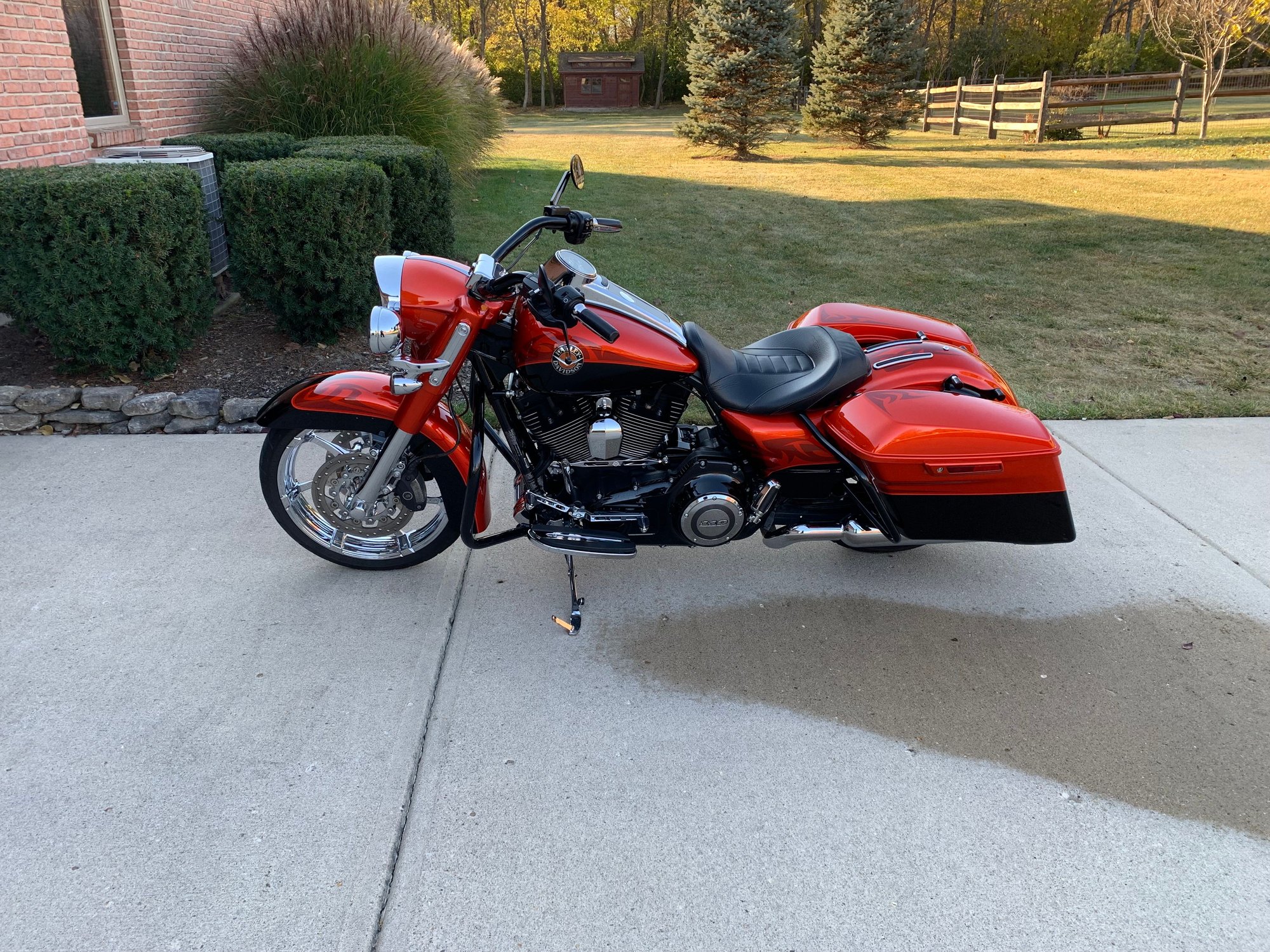

I have a 2014 CVO Road King that I bought new. The stock exhaust was terrible…way too quite and too hot thanks to the cat in the headpipe collector. I cut the cat out of the stock headpipe, welded it closed and painted the headpipe with high temp paint. I also removed the stock baffles and packing in the mufflers and put in fullsac 2.25” baffles. It sounds great with these changes. Very deep sound and just the right volume. A few years later I did a 117 Stage 4 build and fixed all the design flaws in the 110 engine. The cams and compression bump added to the sound but it sounded great even before the build with just the exhaust mods.

Yeah, fun bike and what I love about the Road King is its versatility. Put on the windshield and tourpak in less than 5 minutes and your ready for a trip. Take them off and your ready for cruising into your favorite waterhole. The bike draws a crowd wherever I ride it. I kept waiting for Harley to release another CVO Road King with the M8 to give me a reason to trade but it hasn’t happened and now that it looks like it will be going away or get the new bodywork, I won’t trade.

Very beautiful in Red!
