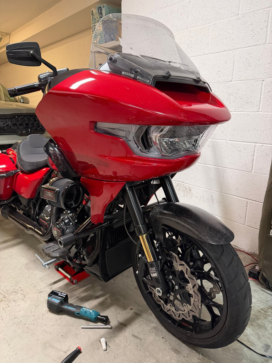

I just set mine up yesterday, so while it's fresh in my mind:
The front rebound and compression damping adjusters on mine turned clockwise about 2 turns to the stop from the factory setting. I just stopped turning when I got resistance - not a HARD stop. It does mention in the manual damage can result if you push past the stops. Then I turned both back 0.5 turns for a Sport setting.
Just FYI, the factory settings for me (for all suspension settings) were way too bumpy/bouncy. The rear shock preloads were set at 21mm - equivalent to a 320lb rider. I am 190lb with gear on and some day to day stuff in the bags, so I set the preload to 7mm. The rear rebound and compression damping were factory set to about the "comfort" settings (8 rebound, 23 compression. I set mine to 5 and 14 clicks for a sporty set up.
Front preload was factory set at 5 turns - which is for about a 200lb rider - so I dialled it back to 4.5 turns for my weight.
Anyway. It's a different bike now. It feels superbly planted with no bouncing. Just nice, fairly firm, sporty and planted. It actually feels better than the set up on my Low Rider ST, which had full Ohlins front and rear.
Nice bike BTW - my friend picked one the same up today and it looks great. I have the Inferno Grey one, and I may be biased, but I think it's best the paint option on the '26 bikes!
