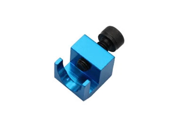

Using the little lobe tool to advance the weights when trying to static time it ? Don't it will never be right. Be sure the advance weights are in good condition also, most overlooked part on those machines.
