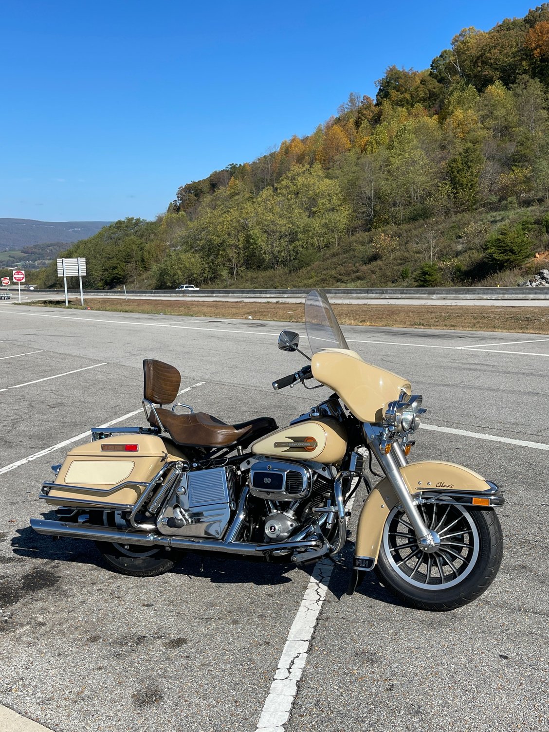

Hey all... I wrote this post way back 15 years ago. Update: I never took the pogo off. I have kept his queen 100pct stock over the years (ham can, exhaust and all). She still runs like a sewing machine.
And, yeah, the pogo with stock seat is comfortable.
Here she is 15 years later looking just like she did in 2010 (and 1979)!
