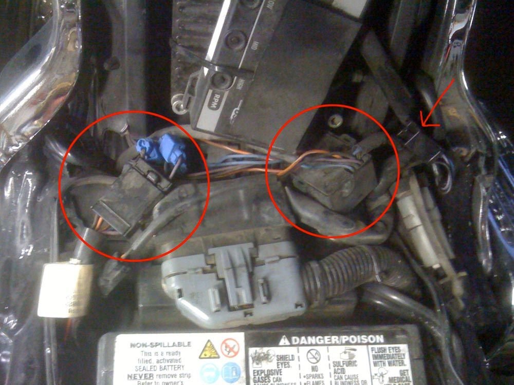

Also under the seat are a couple gizmos that I don't know the purpose of. Circled in red in the first photo. The gizmo on the right has a couple leads that come out from under the fender struts with a plug in connector. The one on the left has some cheezy crimp connectors that attach the wiring. Anyone have any idea what those might be? Tough question, I know.

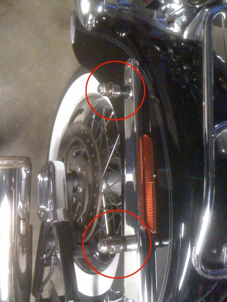

Then, about the strut bolts for quick bag attachement… I've ordered a seat back brace for my lady that attaches to those, but I haven't received it yet. Would I be able to attach side bags to those as well, having both the back rest and bags at the same time? And are there aftermarket bags that fit those?

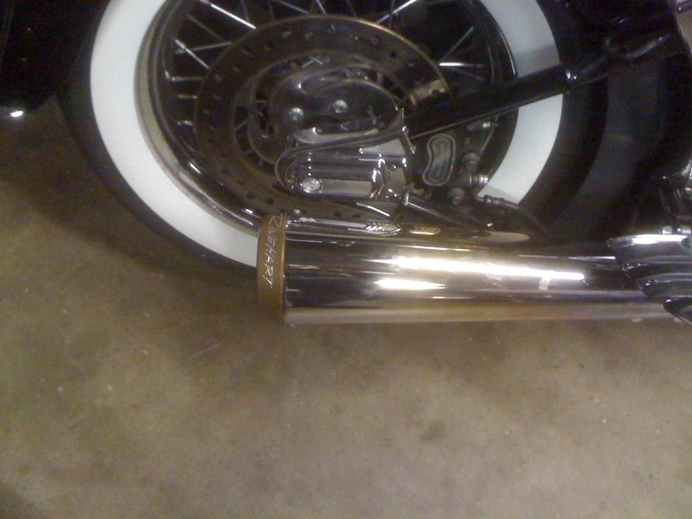

Lastly, the bike has a Rinehart 2-1 exhaust. I like that a lot. Is the baffle able to be removed to add packing in order to tone down the sound?

It looks like to me the plug to the right on the pic is for led lights somewhere on the bike I have a set of baggs for that for sale to .

The bike has one of those LED "gas caps" on the left side of the tank that is supposed to show fuel level. Maybe that is what it might be part of. But there is a connector like the one the arrow points to on both sides tucked up under the fender struts.

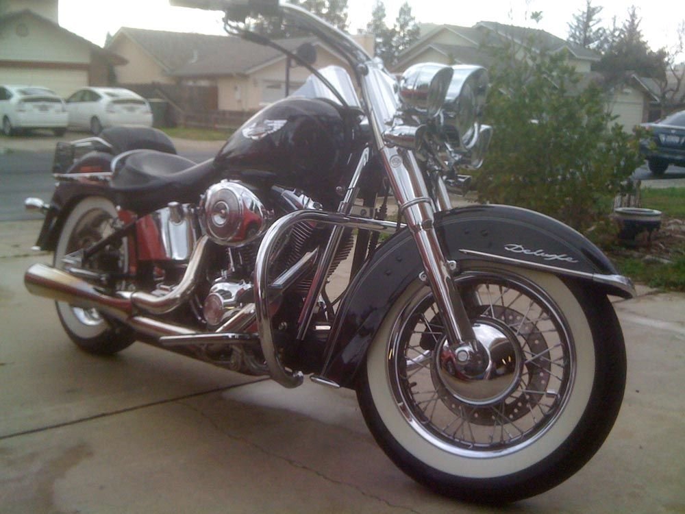

Crappy cell phone pic of whole bike....

By the indications of your picture, you better get that bike checked out. Appears to be running lean! Your heat shields on your exhaust should never be turning blue like they are.

Look under the tank see if there is any switches , really look everywhere they hide LEDs everywhere . The baggs I'm asking 500 OBO but you would have to pay for shipping to I live in Iowa .

There's no heat shield there. The shield ends where the muffler begins.

Haven't had my bags off, but I would guess those attachments on the rear strut are for Karman's bags. That's what mine look like with the detachable backrest off, minus what's holding the saddlebags on.
I'd tend to agree with the above comments about possible LEDs - maybe the prior to previous owner had LED tails and plugged in the load balancer there? or perhaps a Run/brake/turn module that was removed??
I don't know jack about tuning etc., but when I saw that full bike pic the first thing that caught my attention was the discolored exhaust...i agree with the previous comment about getting it checked out - who knows what the guy 2 owners ago did with that power commander...

You're right about the bike's past owners. Who knows for sure. I'll for certain be checking things out along with doing a full service, which will include a compression check. I reckon in the meantime, I'll be studying up on the use of the power commander. But, it looks a LOT worse in the photo than it actually is.
I will say, having had a lot of experience with air cooled race motors (Air cooled VW), that run a collector style exhaust, it's pretty common for the header extension to color well past the collector, even though the primary pipe itself has only colored the first few inches. It has something to do with increased velocity and a "re-burning" once past the merge.
Be that as it may, I plan on doing some long road trips, and I want to be sure that I get no surprises miles from home.
I'm thinking about welding an O2 bung into one of the pipes and using a wide band O2 meter to see where it's at. I know the factory tunes 'em really lean. A lot leaner than I think they should be. And it only way to know for sure is to measure it out on the road. And honestly, I'd much rather have 'er a little fat than lean. Most of the wide band meters available will do a data log so you can see where it's at over a wide range. I have access to a lot of this stuff due to my drag racing ventures in a vintage VW.

No worries on the baggs , when your ready pm me hit me a offer . I put diff. Baggs on my bike you always need room to put stuff and I thought of putting those baggs back on they just look good . You can see all the chrome . And my bike is the same as your 06 deluxe under my heat shield the pipes are blue pul the spark plugs that will tell you a lot . My bike I have 40 k for miles and never had no problem tires brakes and battery maintance is key , just inspect timing chain tensioners ever 20k dental pik and a flashlight is to do.
