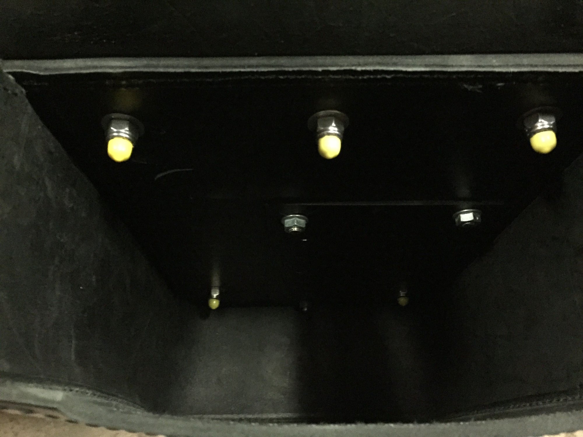

Did you put another plate inside the bag to sandwich the bag between the two?

i was going to, and bought two pieces of plate for that very reason, but discovered it was unecessary in my case as the steer hide leather is super thick and stiff. I just used washers. There are eight bolts through the back including the three that mount the plate to the bike. Although I did throw in the crummy backing plate from the bobber bracket kit on the three studs inside, but not beacuse it needs it, I ran out of washers so it’s temporary.
The only thing I may do is order some buttonhead cap screws and reverse the hardware, so there is only the button heads showing inside the bag. Could replace the studs that way too, would just have to play with the length and cut them so they didn’t protrude into the belt area as is the case with the stock hardware. As it is, I just installed some vinyl thread caps with a dab of rtv inside them to prevent anything catching on them inside the bag.

Wow that is thick. Excellent.
