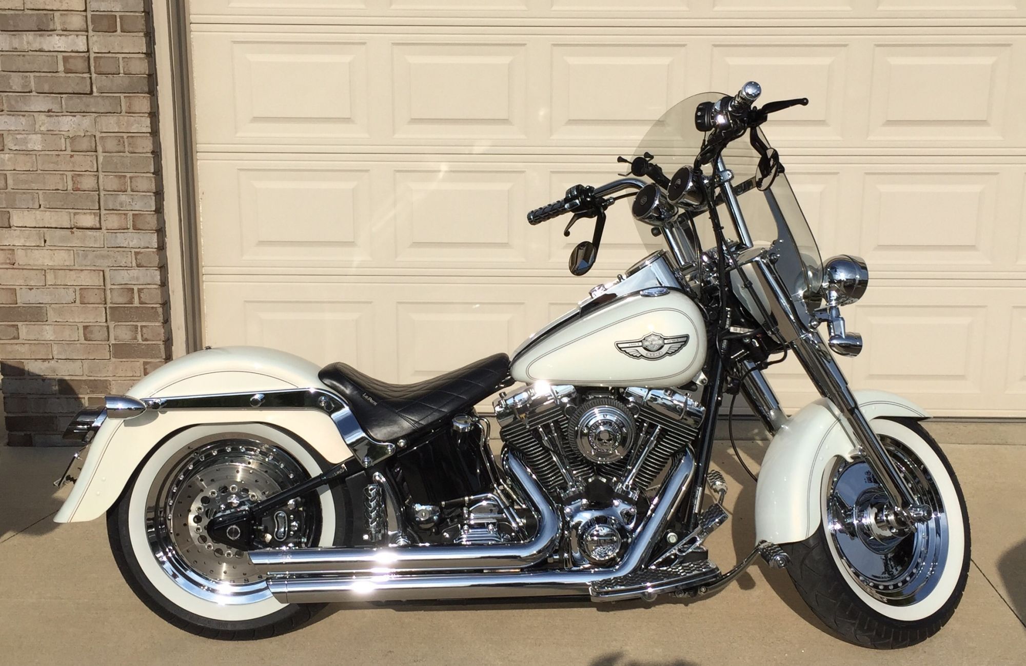

Picked up the bike this past weekend after some engine work and installation of a complete bar/control set.
Basically a 95" hot setup kit. 95" cylinders, high flow heads, high compression pistons, SE 211 cams, cam plate with hydraulic tensioner and high flow oil pump, push rods, SE tappets, SE carb/intake, and I went back to a 2-1 exhaust. Bars are 14" Wild ! Outlawz.
Initial thoughts -
I'm still breaking the engine in and riding like the cops are behind me at all times, but I can definitely feel the difference in torque while only at 10-15% throttle, and I don't believe that's even close to the rpms where the motor makes the power. I'm at around 300 miles, and the gentle riding is harder than I thought it would be. I'm slowly allowing more rpms with each 100 miles. Once I hit 500, I'll ride a little closer to my normal riding style without cracking the throttle.
The bars are incredibly comfortable. Perfect shoulder height and a world of improvement over the stock Fatboy bars.
Attached Thumbnails Engine Build (just got the Fatboy back)-hd1.jpg   Engine Build (just got the Fatboy back)-hd5.jpg

Good looking bike. Bet you love the difference.

The bars alone make it feel like a completely different bike, and that was my goal. I'm hoping there's a considerable difference in power once I'm able to open it up, and that'll make it all worth while.
The stock 88" was plenty of power, truthfully, but I began getting that itch to have a new bike. Taking this route, I managed to save a ton of money over a newer HD with a larger displacement motor.

I have the 95 kit in my bike with the se211 cams, 5 speed. I can tell you that 103's will be in the rear view mirror. The 88 motor can get to 100hp with ease. Have fun an hang on bro!!! Bars look good too.

Looks great!
I have an 03 FatBoy with Wild One 12" Outlawz and a 95" kit w/SE203 CAMs and mild head work. Bars are awesome but initially kind of wished I went with 14's. Softails are different in that you "sit in" the bike vs on it, like a Touring bike, so the 12's have accomplished the goal of added comfort and the finish on them is top notch.
Also, the FatBoy always feels "quicker" than my 103 Deluxe or 103 RKC. However the top end in the bigger motors eventually wins out. Off the line however, 95" all the way!
I just ordered a Mikuni 42mm Carb for the FatBoy though so I can take more advantage of that setup. Should have it on in a couple weeks.
Good luck breaking it in and ride safe!
