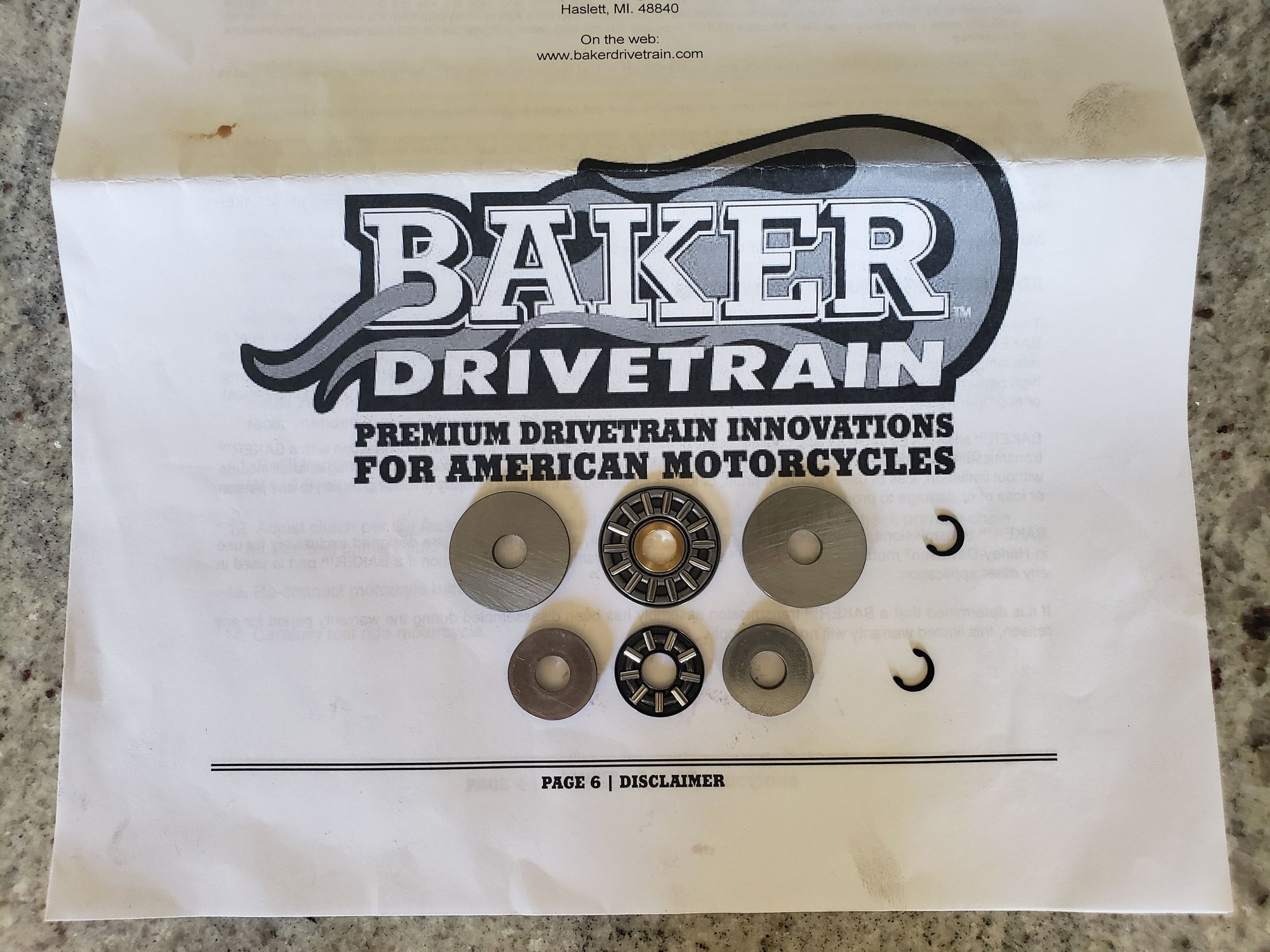

How much fid all this coast in parts if you don’t mind? And all from Baker?
Old Sep 4, 2019 | 11:18 PM
  #442
Rocker B's Avatar
Rocker B
Posts: 1,626
Likes: 310
From: "Old Hangtown" Placerville Ca.
Originally Posted by splattttttt
Nice work Rockah!
Can’t wait to hear what you think after a test ride.
Thanks Brotha!! I'll let ya know.
Yes, all the heavy duty throw out bearing and ramp/ball parts are Baker, and come in a kit....
I got it on Ebay $71.95...https://www.ebay.com/sch/i.html?_fro...g+kit&_sacat=0

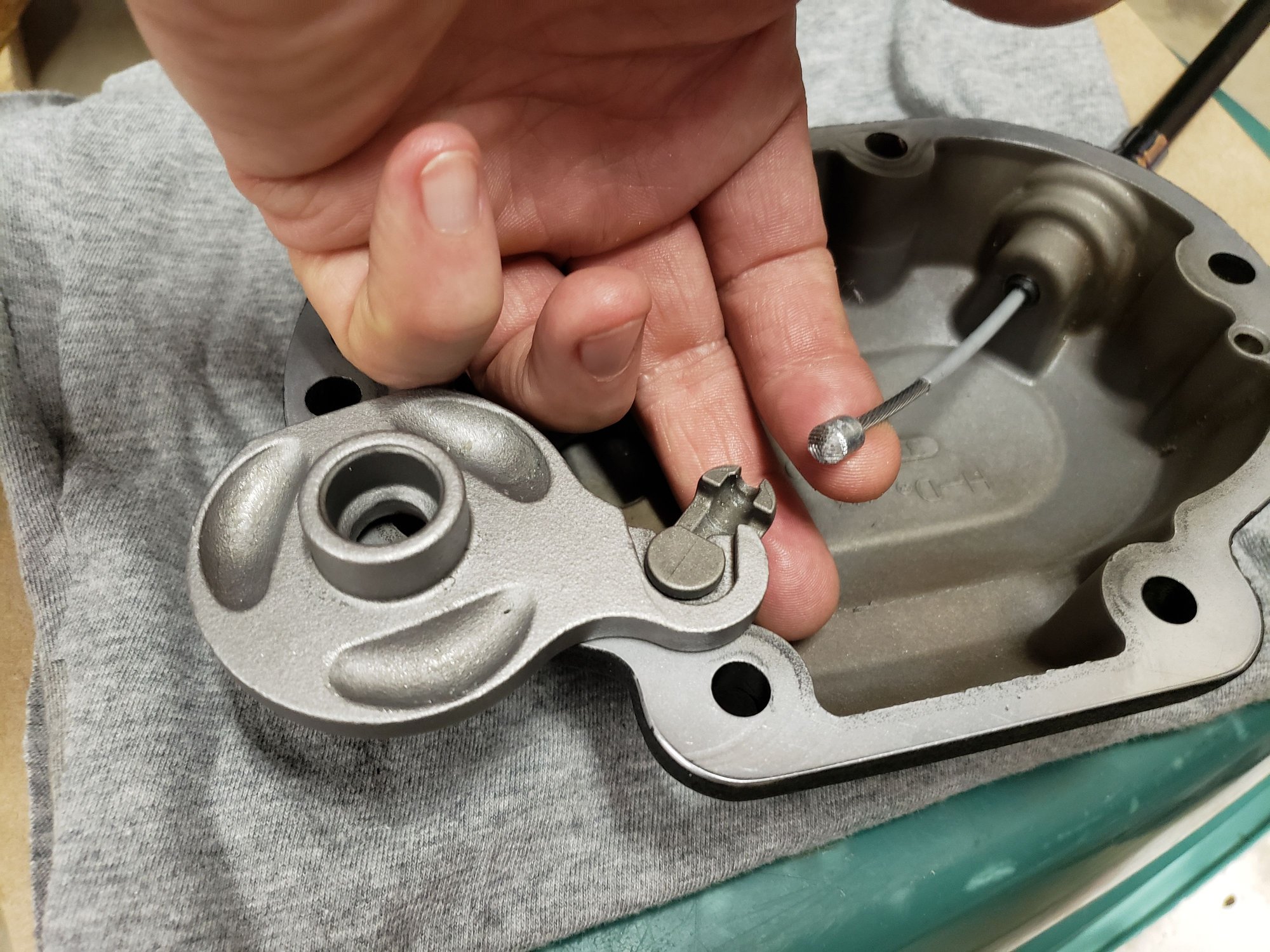

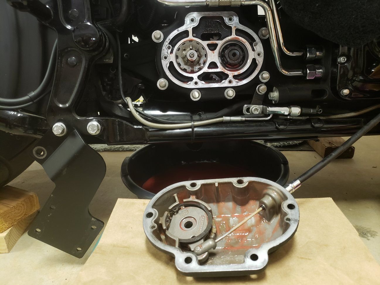

So I got everything back together, and the cable wasn't stretched after all...
I now know that there is a way to run out of cable adjustment without the cable being stretched. Apparently when I originally installed the cable, I didn't have the outer ramp pushed all the way back (disengaged) when I put the clutch release cover back on. When this happens, the only way to adjust the clutch is to back the adjustment screw way out and pick up all the slack in the cable with the cable adjuster.
I came to this conclusion after installing the new cable and having the same problem with it being to long. The clutch had been adjusted before the switch out, and the screw was backed out 1/2 turn from lightly seated, but I decided to check it again... The adjustment screw now needed to be turned in several turns before seating, with the clutch lever starting to move out after a couple of turns, (it didn't move at all before).
This time I made sure to have the ramp all the way back when installing the cover, the "how to" videos all say to do so (shoulda watched the 1st time), or you'll have problems adjusting the clutch, if you can at all!!
The install went fine, but I did need to file down the end of the connector on the Drag Specialties cable, it was to long and wouldn't allow the ramp to pivot into place. Everything is back to normal, and I now have plenty of adjustment at the cable adjuster!!
The 2nd pic shows the correct position of the ramp/cable when reinstalling the clutch release cover.
