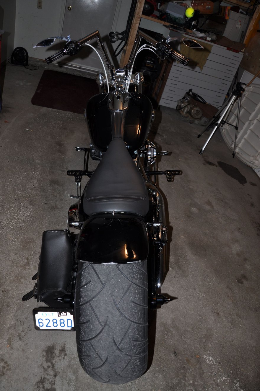

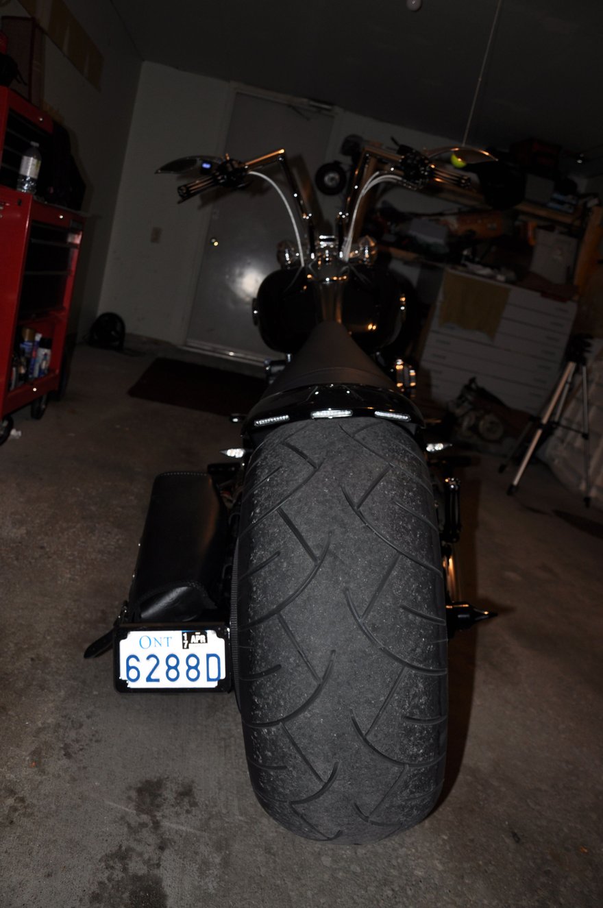

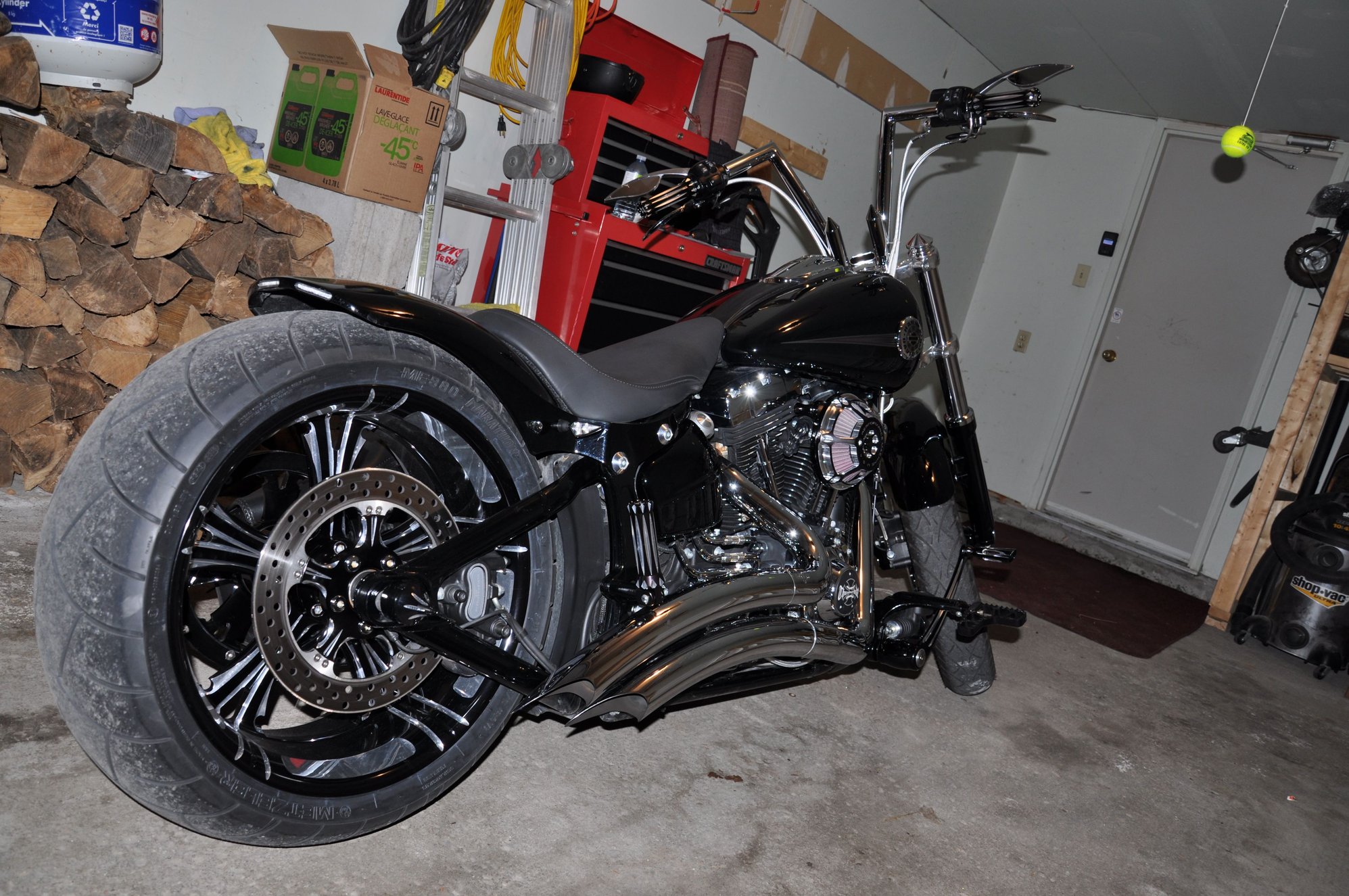

This started out as Canadian Breakout, yup, ugly **** rear end, wasn't difficult wiring in the new tail section light(an excellent mechanic at the local HD shop did it quite well), the replacement digital speedo was another story.
