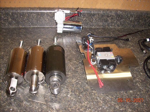

Anyone put one of these on? It looks pretty straigtforward but I am not sure I like the stainless mounting plate they give to use to mount the control valves on.
I think it is going to stick out like a sore thumb looking at the bike....considering I have a night train.
The obvious answer of course would be to paint it...and I probably will but I am wondering if anyone else just used their stock splash guard and mounted the controls to that.
Open to ideas. I am including a not so great pic of the stainless plate I am talking about....this will replace the stock splash guard in front of the rear wheel.

Paint that stuff black, and it should look fine. Please provide some feedback after you finsh the project, and let us know how that ride quality is.

Well...a couple of major break throughs this afternoon.....Platinum's website doesn't list this kit for 2007s on their site....it stops at 2004. I am starting to suspect why....the damn thing doesn't fit. A LOT of other products don't fit the 07 that do fit earlier models so maybe it's an 07 thing but I do know this kit wouldn't fit this bike without being massaged.
I don't see in any way shape or form how the stainless plate that they sent to me could be used on this bike as it attaches completely differently than the stock splash guard. I gave up trying to make that work and transferred the controls over to the stock splashguard....they fit perfectly in the recess behind the guard at the very top.

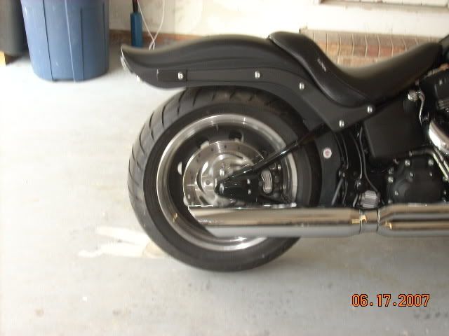

First test ride completed.
Here's a before and after pic.
All the way up:
Slammed. Tire is NOT rubbing at this point..although I don't know how.

The stainless mounting plate I did not use for two reasons...I think I could have hacked it in to make it fit but it would have been absolutely hideous on a Night Train and I didn't want to paint it anyways. The paint would chip easily etc so I refit the control solenoids and relay to the stock splash guard. This is something I think Platinum should consider incorporating. If you look at my pics...try to picture a flat stainless plate with no sides sitting there....ugh.

So far...I'd score it a "C" for average as far as quality....and a "B" for the level of ride height adjustability. The bike will go from one extreme to the other at the flip of a switch.
All the way up:

Damn that thing goes low.What ya' doin' with the old shocks?If they're for sale , let me know.I'll see if they fit my '02.I broke one on a pothole.Sounded like a gunshot.
