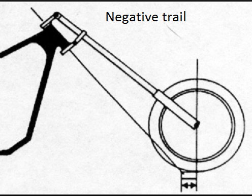

Originally Posted by Tom84FXST
The steering neck in that picture doesn't look like it lines up with the triple trees. The red line there is drawn off the trees...but not off the neck. I don't know what they did or did not do to right it, but just going off what I see. It looks to me that it is the stock rake with an added rake triple tree...which would absolutely put you into negative trail.
Here's what I see in the image. Now bear in mind the bike is at an angle where the front wheel is lower on the pavement and that could skew things.
