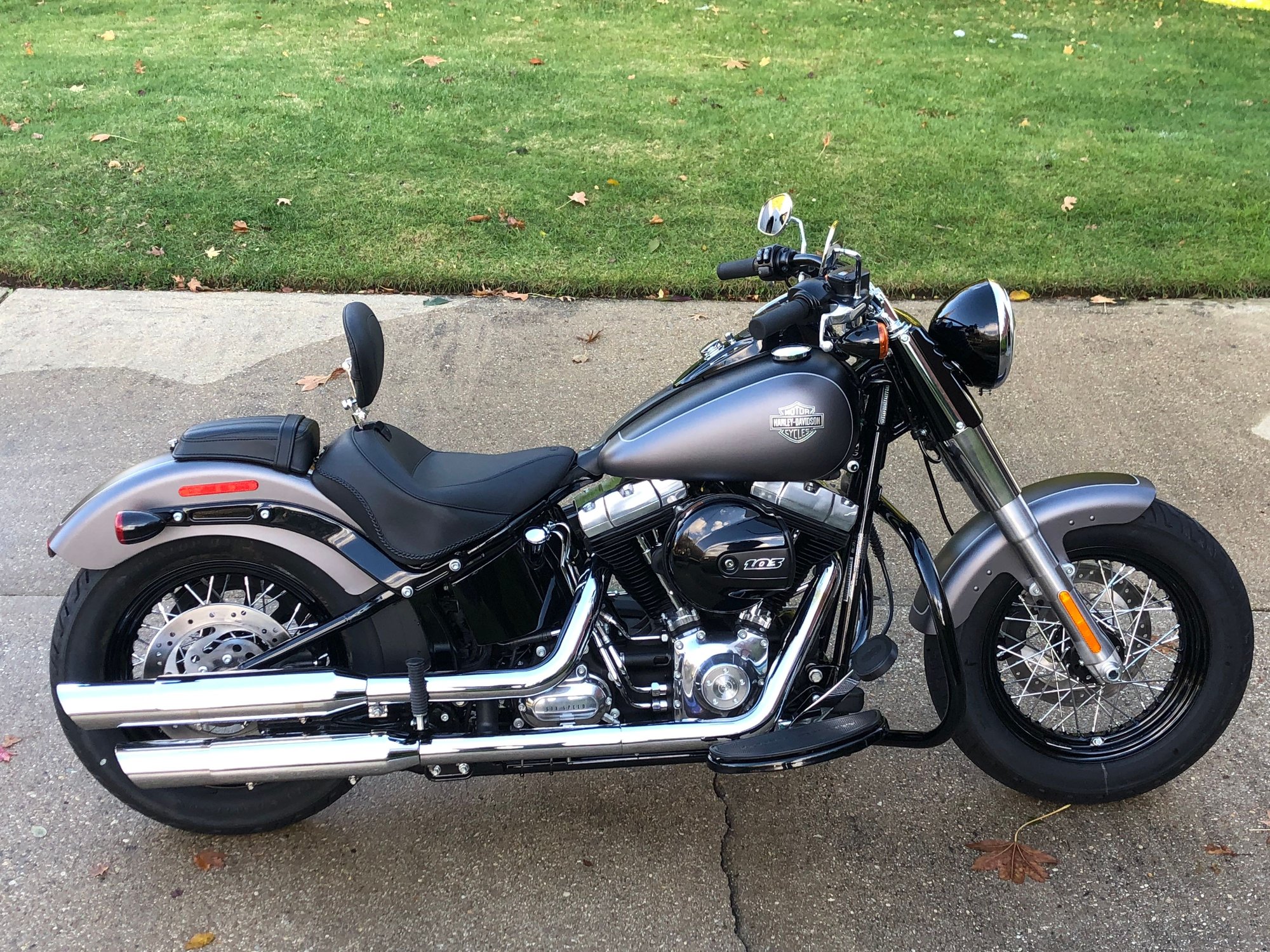

Looking to put an K and N air cleaner on my 2017 Softail sim was going to put the OEM on that fits the stock housing was wondering if I had to put a fuel pack or not?

If you change the air cleaner and not just the filter element then yes, you will need a tuner. Looks like you already changed the mufflers so that's doubly true. Also, I would far rather have the Power Vision tuner.

Those are stock mufflers on there but just bought some cobra RPT Slip-Ons that I will be installing this weekend
